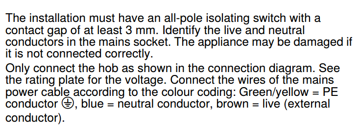

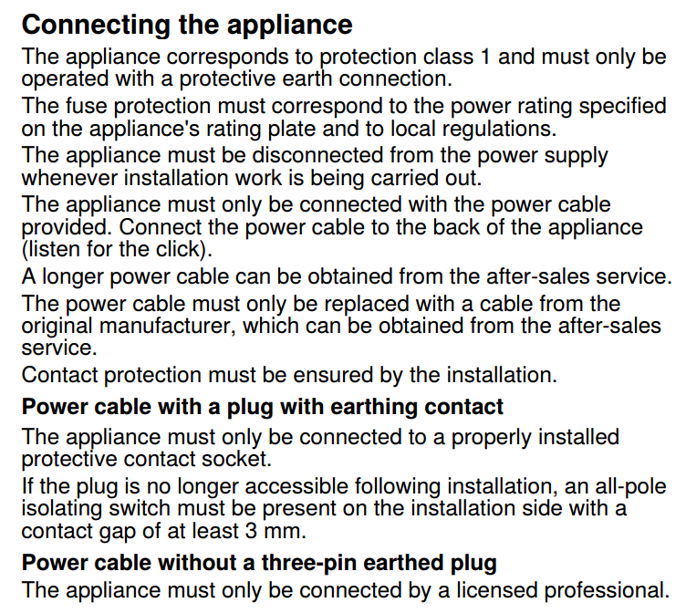

I did check the manual but it doesn't seem to mention much unless I am missing it??
HBA53B150B/61

He then also posted a screenshot of the manual, which says the oven comes with a cable
I appreciate that. I have read else where that it doesn't. I am just trying to be prepared incase it doesn't so I know what to get.
If it doesn't, contact them.
It sounds like it has some kind of plug on the cooker end, so wiring a bit of flex to it would be difficult.
