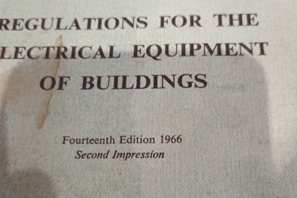

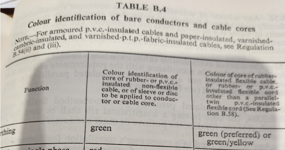

I guess both metric and imperial ran side by side for a while. The 14th went metric in 1970.
Your cable would have been 2.5/1.0.
I was wondering when the larger CPC made an appearance.
I have seen an uncorroborated claim that it happened around June 1975, but I know that my Mum had her house rewired in 1982 and the CPC in the 2.5 is definitely 1 milli.
So, was it old stock, or was the CPC not increased until after 1982?
