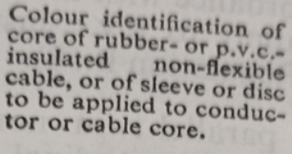

I don't think so as there are references to bare CPC conductors - 514.4.6 where they can be identified by tape, sleeve or a disc.
That's why I was interested by Secure's post:
"Both the 13th Edition and the 14th Edition say that bare earthing conductors should be identified with the colour green."
I assumed that was the introduction of the practice of identification - rather than insulation (much the same as today but particularly specifically sized green and yellow) so what happened before?
Was it just bare bare conductors that everyone 'knew' were CPCs - like the ones twisted together outside of old round junction boxes.
Thanks. That's what I thought - so it looks as if I hadn't forgotten any reg.
514.4.6 requires identification of a bare conductor, in one of the ways you mention, "where necessary". Whilst 514.3 appears to require identification of all conductors (well, "cores of cables") there is an exception if 514.6 applies, and 514.6.1(iii) allows identification to be omitted for "bare conductors where permanent identification is not practicable" - although I'm not quite sure how to interpret 'not practicable'. I'm saying all this because I'm trying to work out whether 'identification' of bare CPCs is actually required - and, having read all those regs, I'm not at all sure - what do you think?
I assumed that was the introduction of the practice of identification - rather than insulation (much the same as today but particularly specifically sized green and yellow) so what happened before? ... Was it just bare bare conductors that everyone 'knew' were CPCs - like the ones twisted together outside of old round junction boxes.
I imagine that it probably was - and I inherited a good few round JBs wired as you describe! However, per above, I'm not yet convinced that identification of bare CPCs is necessarily 'required', even today.
Kind Regards, John
Well, that's almost exactly what is stated in table B4 in the 14th:
Is that still the '66 version?
Bare CPC abounded way beyond that, In fact my school had a new building in 66 and the longer runs of tube contained a bare earth wire. The sub board in the gym was 7/0.063" white/black singles and 7/0.029 bare copper earth in tube. Likewise blue/black to library whereas stage lighting was supplied by a very thin MICC and 29A fuse [Yes 29A]. A teacher increased it and we were able to run some 15KW but it got warm, hence looking at other boards for more power.
I missed the "where necessary" but as you know, I think wires are identified by being connected to marked terminals.
"Not practicable" - doesn't that mean "not able to achieve the desired objective"? As opposed to "not practical" meaning "not worth doing" so I don't know what it means in this respect.
I am not sure if it is actually required.
You do (and it makes sense, at least so long as the conductors are connected to terminals) - but I'm aware of nothing in BS7671 which suggests that as an acceptable "means of identification" in any situation. Maybe, however, that's where the "where necessary" comes into play?
I've never been totally clear as to the meanings of the two words, but I've always thought that it is roughly as you suggest. If so, I can't really think of (m)any circumstances in which it would be "not practicable" to identify a bare conductor in one of the ways described (things like armour are already exempt from the requirement for identification, per 514.6).
As I said, having read all of the apparently relevant regs, nor am I.
Kind Regards, John
