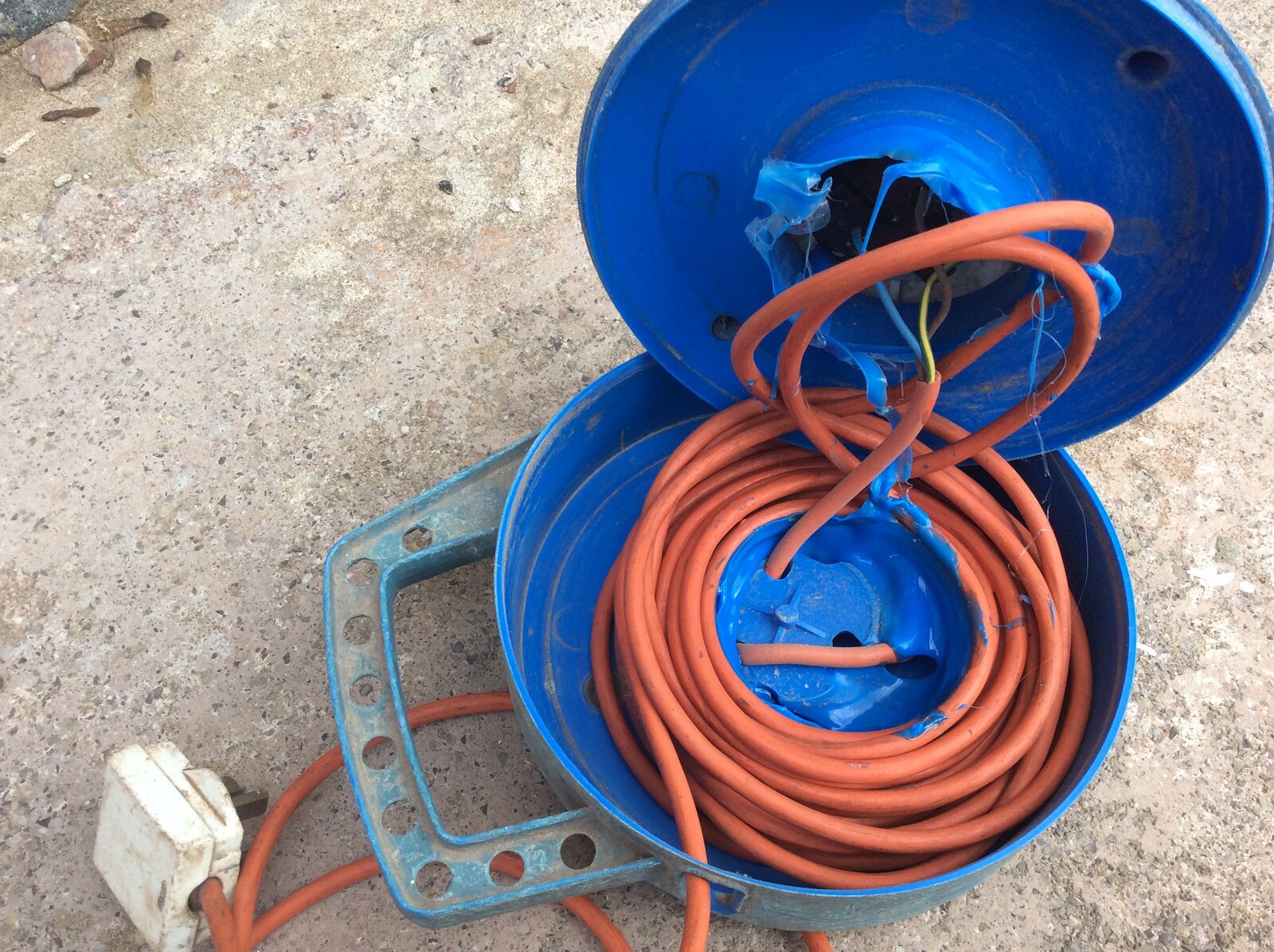

Mrs lost decided to to do some pressure washing, 3kw, with the wrong extension and not unwound ,in my absence and knocked a breaker out when the reel melted:eek:

Got to say that not many people know about the different capacity of wound or unwound reels.
There should be a big prominent red mark that people don't miss.
Most reels you come across for sale these days have a block of text telling you to unwind fully before use.
It's getting people to read it thats the problem. Same as those people who go to a hardware shop, (in fact any shop that sells them, including supermarkets), and just pick one up without checking the rating. Woman next to my daughter used a reel on her tumble-dryer and asked my daughter if I would have a look at it, ("because it was getting quite hot even though she had unwound it"). I asked my daughter to read out what it said on the socket face of the reel. She said, "15 metres Unwind fully before use." I asked if there was a 10A or 13A anywhere on it and she replied, "Yes, it says 10A."
So I told her, it needs one with 13A on it and it should only be as long as the distance between the dryer and the socket and preferably no more than 2 metres. Also recommended she try to find one that has 2.5mm written on it as opposed to 1.5mm

That plug top is potentially lethal, unsheathed pins were banned in the UK years ago
I had a reel like that years ago, from memory it wasn't rated for 3kw (13A) even when fully unwound.
Re: the overheating, why?
Is it that the cable itself has a small degree of resistance and, while this would be negligible due to dissipation while unwound, it would build up if coiled?
Would a cable still overheat when under load of it was just bundled in a haphazard pile, or is it something about it being in a coil that causes it?
Indeed, every cable has resistance.
Pretty much, same amount of heat generated but less ability to disspate heat means higher equilibrium temperature.
IIRC cable ratings are typically based around a cable working temperature of around 70C.
It's far less likely, because the "haphazard pile" will nearly always be far more spread out than cable wound on a reel.
Aren‘t UK reels required to have a thermal cutout? I haven‘t seen a new reel without one on the continent for a long, long time.
