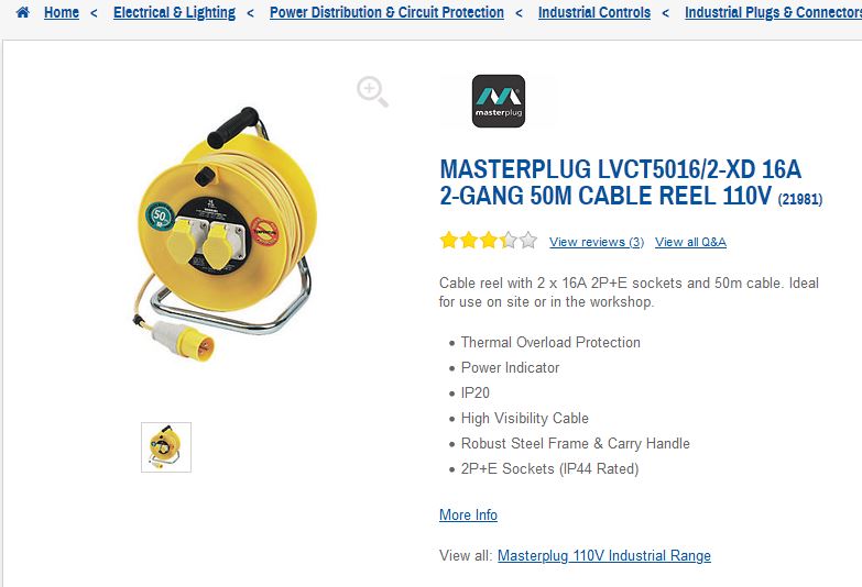

Specification
Amp Rating 16 A
Brand Masterplug
Cable Length 50 m
IP Rating IP20
Max. Power Unwound (W) 1760 W
Max. Power Wound (W) 720 W

Some people might take the 16 A 'rating' as applying regardless of whether the cable were wound or unwound!
I presume that what you are quoting relates to 110V, since that's the only way I can square "1760 W" with "16 A". How would you interpret that in terms of what load ('power') was acceptable (wound or unwound) at 230V ?

Yes, that description matches
https://www.screwfix.com/p/reel-110v/21981

I selected the 110 volt version as all the 230 volt versions had a thermal reset button built it.
Fair enough (although it begs a question as to why 230V ones have thermal cutouts, but 110V ones do not).
Is the only (other) difference between a "230V" one and a "110V" one the connectors? On the face of it, 16 A is 16 A (and, if anything, one could even understand the 110 V one having larger CSA cable, since the VD at 16A {regardless of supply voltage} would represent a higher percentage of 110V).
