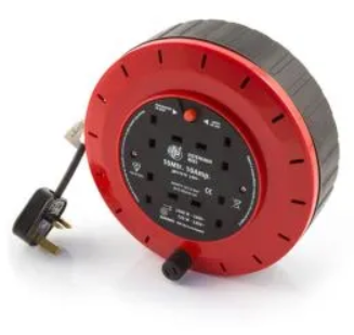

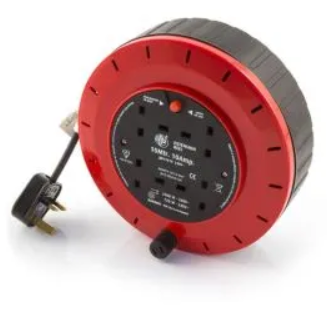

I typical extension lead 1708260264900.png has a thermal overload

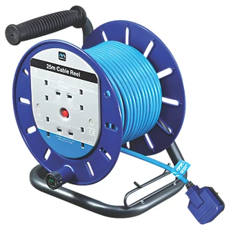

which should ensure if it over heats, it will switch off. One shown is only rated 10 amp. This one 1708260521421.png is rated 13 amp with 1.25 mm² cable again with cut out, but standard plug, it says in advert trade rated, so one would assume it can be moved from place to place, and as it is 25 meters long it may not cause the fuse to rupture within the required time with a line to earth fault, so where I work it would be required to have a RCD plug on it as one can't guarantee it will be plugged into a RCD protected socket.

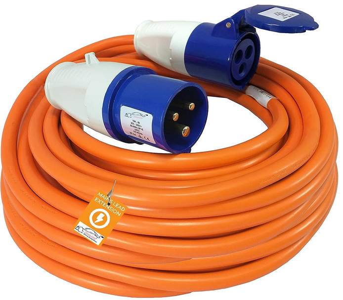

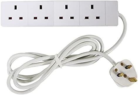

This is also an extension lead 1708260889109.jpeg but not long enough to worry about RCD protection, it says heavy duty cable, but does not stipulate size, so we have no idea if it will or will not take a 13 amp load for an extended time. This is also an extension lead 1708261270790.png advertised as for a caravan so should be 25 meters long and 2.5 mm² although it does not say how thick the cable is, but this is clearly able to take a 16 amp load for a long time.
So the question has to be what extension lead? I know refrigeration units often say do not use an extension lead, as volt drop can cause them to fail to start fast enough and so cause an overload, only when using an inverter drive is there no significant inrush so volt drop is no longer a problem. Old fluorescent lights with magnetic ballasts could also have a problem, but most items today should be able to use an extension lead if the lead is matched to the use.

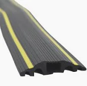

The 13 amp plug contains a fuse, the way they work is they get hot, that hot the wire inside the fuse melts, so the plug needs to dissipate that heat, it does this in two ways, one into the ambient air, and two into the socket, so a 13 amp plug should be in free air, or forced air when supplying some thing like an oven. The cable of the extension should also be in free air, with a cable anti trip cover 1708262103138.png normally black as it can absorb the heat better, and designed for the job, OK, but cover with a carpet so no one trips, and the cable can over heat.
