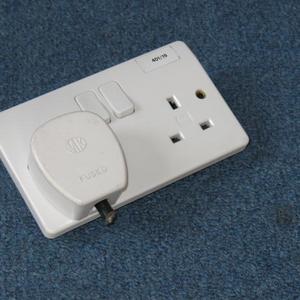

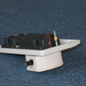

This was on a water urn in a school, a new servery extension or tuck shop sort of thing and the spec called for the moulded plug to be replaced with MK, I think this work was done at Easter and failed PAT in summer holiday so 3 months use and probably not unpluged.
