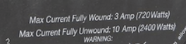

But that doesn't help us with this:
I advocate sufficient socket-outlets so that extension leads aren't required.

An industrial grade cable reel, is one on a tubular bracket/stand, allowing the cable to be run out by simply pulling the plug end of the cable, leaving the reel in place.
I'll fix that for you
An industrial grade cable reel, is one on a tubular bracket/stand, allowing the cable to be run out by simply pulling the plug end of the cable, leaving the reel in place, having first found double-figures kg of weights to place on the tubular frame to stop it moving or falling over as you pull the cable.
