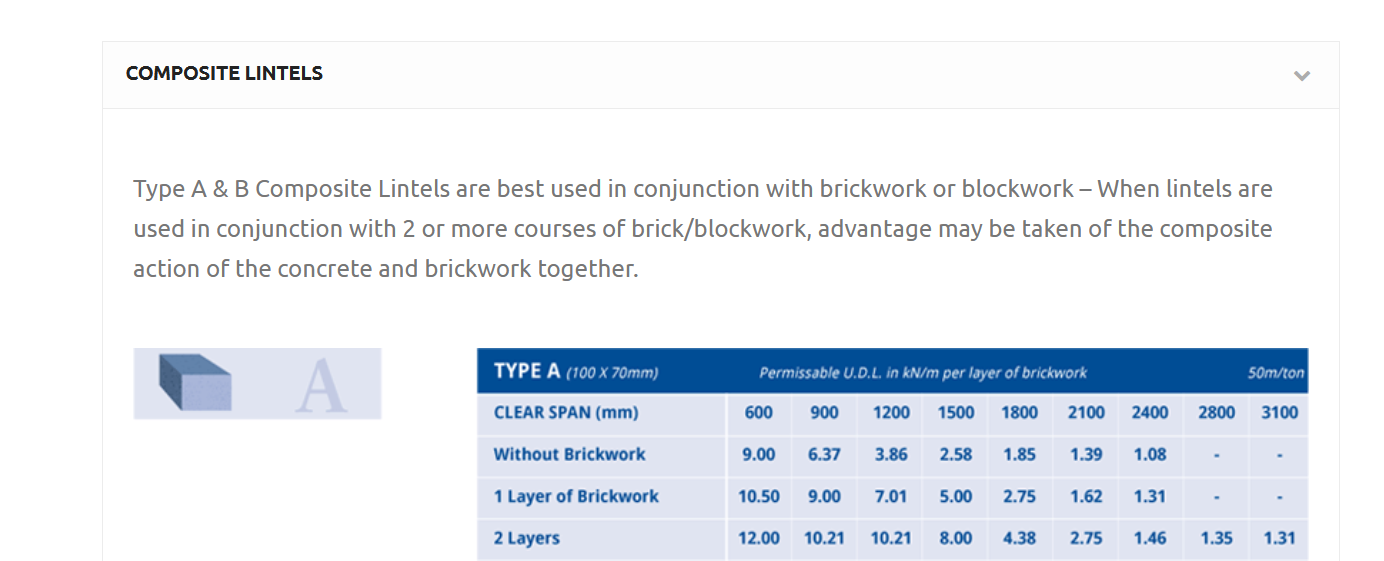

Would a 1200 x 100 x 65 reinforced concrete lintel be suitable for that type of opening which is 900mm wide? The inner skin is a soft thermal block thats easy to cut with a hand saw, would I need any kind of pad stone for the lintel to bare on to? I'm assuming not as there arent any on the other lintels.
I've just had a chat with Building Control about this and they aren't happy with the proposed lintel arrangement as they want 2 - 3 courses of masonry between the lintel and the wall plate rather than the 1 that I would have room for.
Is it worth me pushing back on this or do I just need to suck it up?
The reason they've asked for the additional courses is that the small (65mm) lintels are usually 'composite', which means that they derive some of their strength from adhesion to the courses above - in effect making a deeper beam.
Just span the gap with a 4" x 4" timber fence post cut to length, or a couple of 4" x 2" timbers screwed together upright. Either of those would be more than adequate to support a course or two, plus the weight of the roof.
PS concrete ones are not composite, they are designed for the load without relying on any masonry above.
What does the manufacturer's literature say about it? That's what matters and concrete lintels should not need any masonry above them
PS, from a typical manufacturer's brochure:
"Best used"? Is that "must be"?
Like the old "150mm bearing" scenario which does not need to be, or "best used" on a nice sunny day?
PS (pre-stressed) lintels (with the chamber) don't need any masonry above. I'm sure that's the case for precast lintels too.
Suppose we'll need to agree to differ?
Anyway, a piece of timber would do fine on that span.
Just done exactly that, they were happy and now the building control is happy as long as I have a uniformly distributed load which they seem to think the wall plate is... Thanks for your help guys
