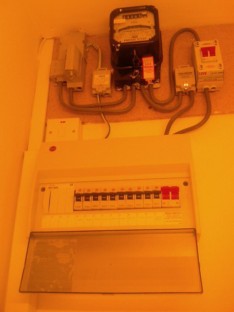

I had my PIR done, the select registered electrician found all was good except that i don't have RCD protecion on any circuit. He advised me to fit the consumer unit with a RCD system. I had a look around and seen that there are different ways to do it. I'd like to get an idea of what is best and at same affordable to post fit a RCD system on my system. Can you help?
Shall I fit any socket circuits individually oy just the main one in the unit?
The electrician talked me through a split board tho it wld be quite a job and costly too. is there a simpler way than it?
Thanks for any input/advice :)
It was wired in 2008 and no circuit has RCD protection, even circuits supplying socket outlets? Is it a ground floor flat?
What's the make of your consumer unit?
Could you upload a photo?
You may be able to have RCBO's fitted to your existing consumer unit which are a combination of an MCB and RCD.
Upload a photo of the CU so we can see what MCB's are supplying what circuits. As GaryMo suggests there are different ways to achieve RCD protection - some easier than others.
While your exisiting CU might not be up to the current regs, there is no regulation that says you must bring it up to date. Despite this I think I would prefer to have any shower circuit or sockets with RCD protection wherever possible...
From his other thread - a Wylex NH1404 14way CU with 100A switch and perfect for fitting RCBO's.
Yep, but as it is for the use of trained persons it isn't a big issue.
One reason I can think of for them to do it like that is to leave a terminal available if E7 was to be installed.
I remember something now... before rewiring the flat i asked my energy supplier to re-routing the meter into a cupboard. However the old CU was still up in the hall and needed of course to be kept live so they made a kind of bridging between the meter and the CU. There was a hunging cable for a while until a new CU was fitted by the meter. This cable was coming from the isolator. Do you think this is the reason for the unusual configuration? What's an E7? :)
Maybe, maybe not. :lol:
Economy 7 (E7) is where your energy tariff switches to a lower rate cost between (I think) 23.30 - 06.30hrs. You pay a higher daytime rate to compensate for this. The benefit is if you have electric heating such as storage heaters then they can be warmed up during the cheaper nightime rate, hopefully saving you money.
