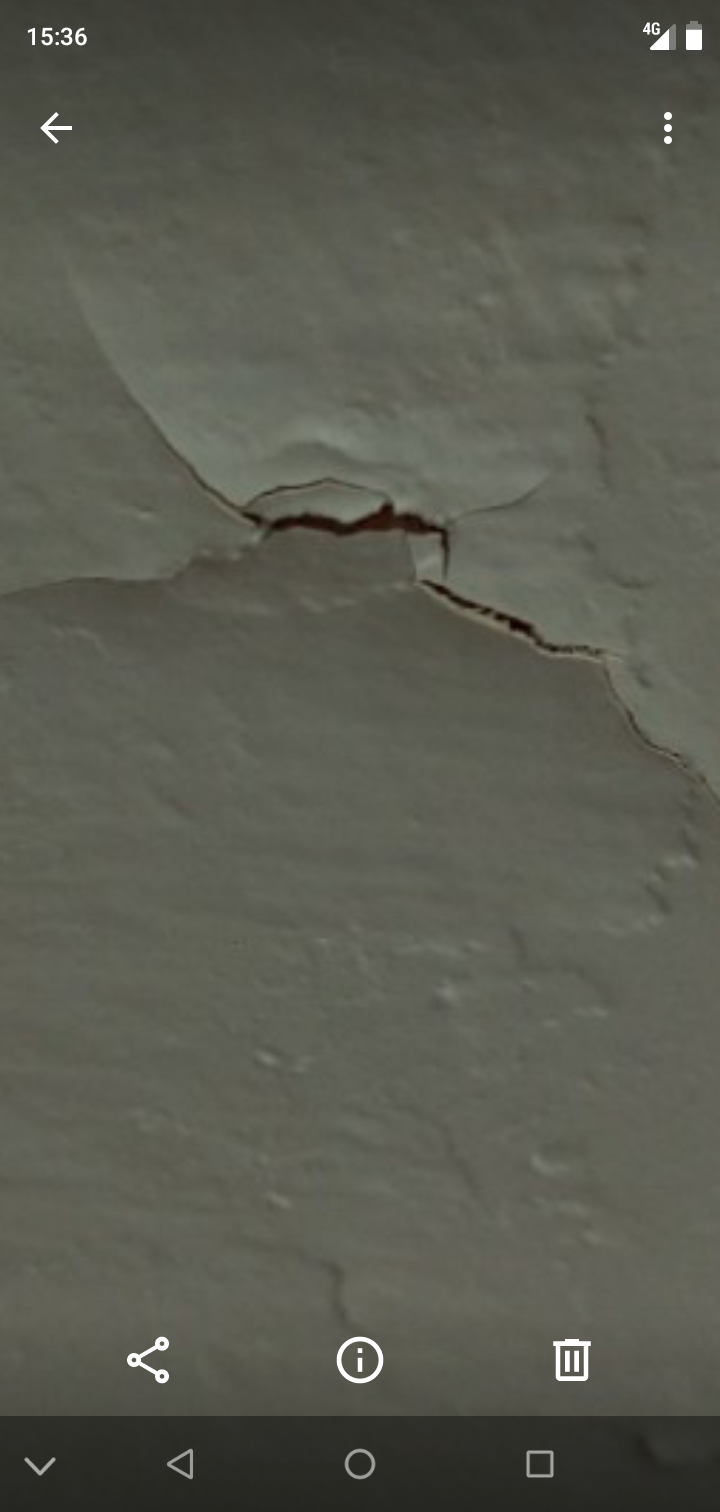

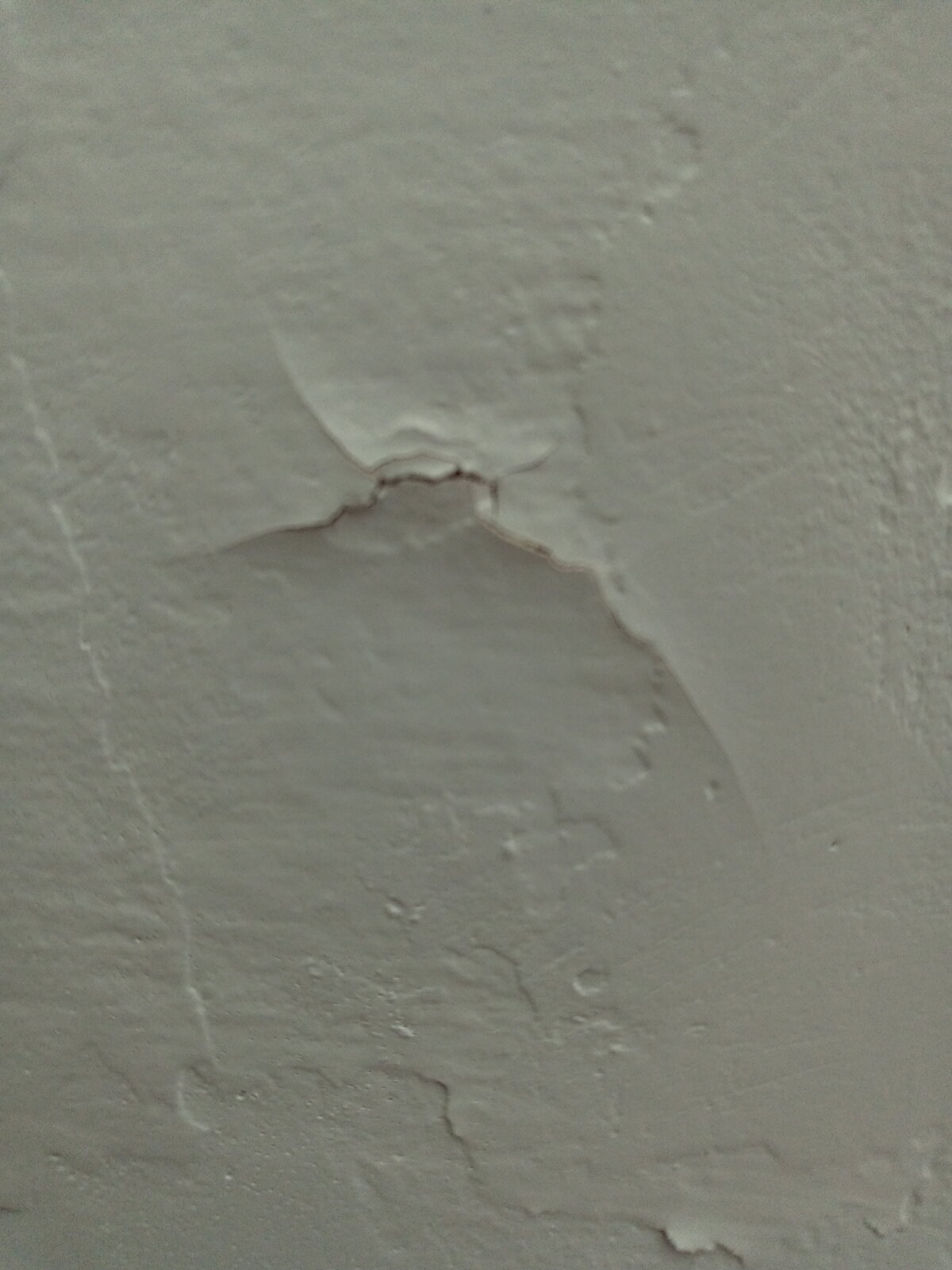

Hi, I live in an old terraced house and recently spotted a rising water stain on an interior adjoining wall. I applied three coats of Screwfix No Nonsense Stain Sealer, allowing plenty of drying time inbetween applications, followed by two coats of Dulux emulson. A few days later the paint started to crack.I have tackled stains like this in the past but have never known the paint to crack? Any suggestions? Thanks.
I suspect that the area may still be damp. The Stain Sealer won't be able to adhere to the damp plaster.
The DPC (damp proof course) on the party wall may have failed or perhaps either you or the neighbour may have a leak somewhere.
I had a DPC around 8 yrs ago. I'm suspecting it's rising damp and maybe I'm leaving it too soon between applications? The house is over 100 yrs old and the stone walls are 18" thick.

Stain blockers are not designed to hold back water. Zinsser WaterTite claims to hold back water thereby allowing you to paint over it with a paint of your choice. I have never used it and imagine that it cannot hold back salts that form on the surface of the plaster. I haven't used it personally. Nb: salts tend to cause raised blisters in the paint work.
If I were to use WaterTite, I would apply it by brush and then apply the first coat of emulsion by brush. Rollers have a tendency to pull paint of unstable surfaces.

The DPC was applied to the front external wall but that is going the same way after 8 years. I have included a blown up photo of the cracking paint on the front wall. The crack is about an inch. I may try the Zinsser sealer you mentioned but failing that, it'll have to be another DPC.
