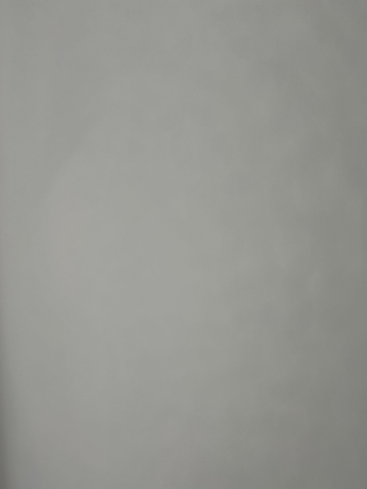

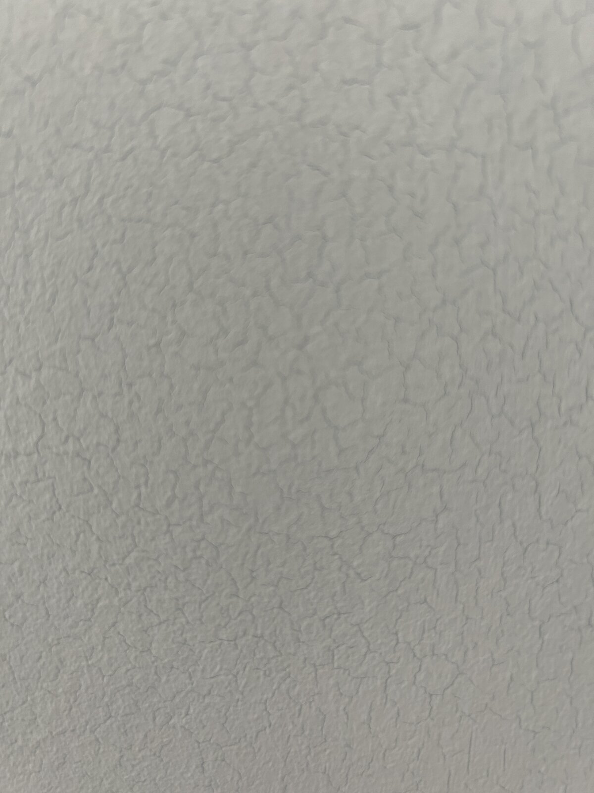

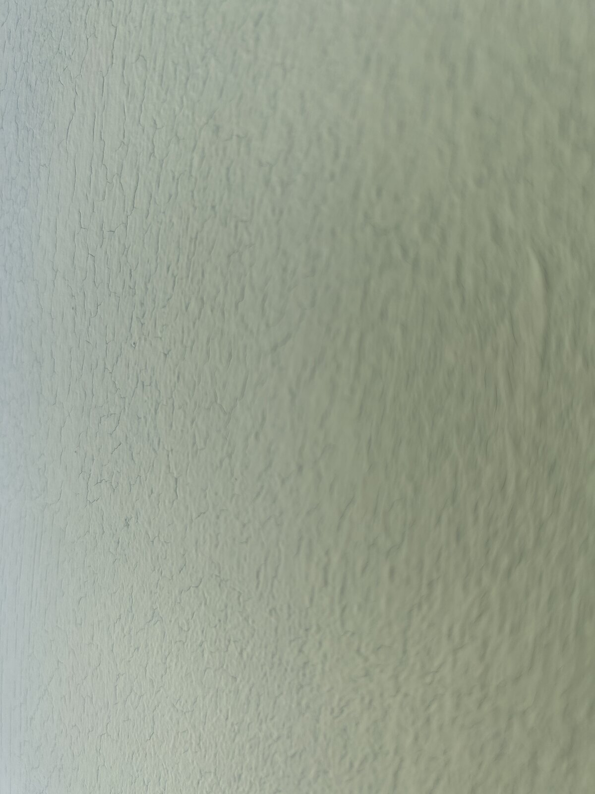

Hi I’ve just painted my kitchen with Johnstons kitchen paint.
I put two coats over an old silk emotion.
I gave it a fill in the sand and wipe down beforehand.
Now it’s dried and has loads of fine cracks all over it. Advice would be gratefully received.
8C6E17CE-C154-4090-AFF6-80DF9CCB8FB1.jpeg9A0D4732-8E74-4FE0-B7FF-3D1957E1C32C.jpeg1A31FCCA-8367-46C9-87C6-894886802897.jpeg
I've seen this before but not happened to me.
I'd of applied an acrylic primer or bullseye 123 over first. The your Johnstone's paint.
That's what you need to do
