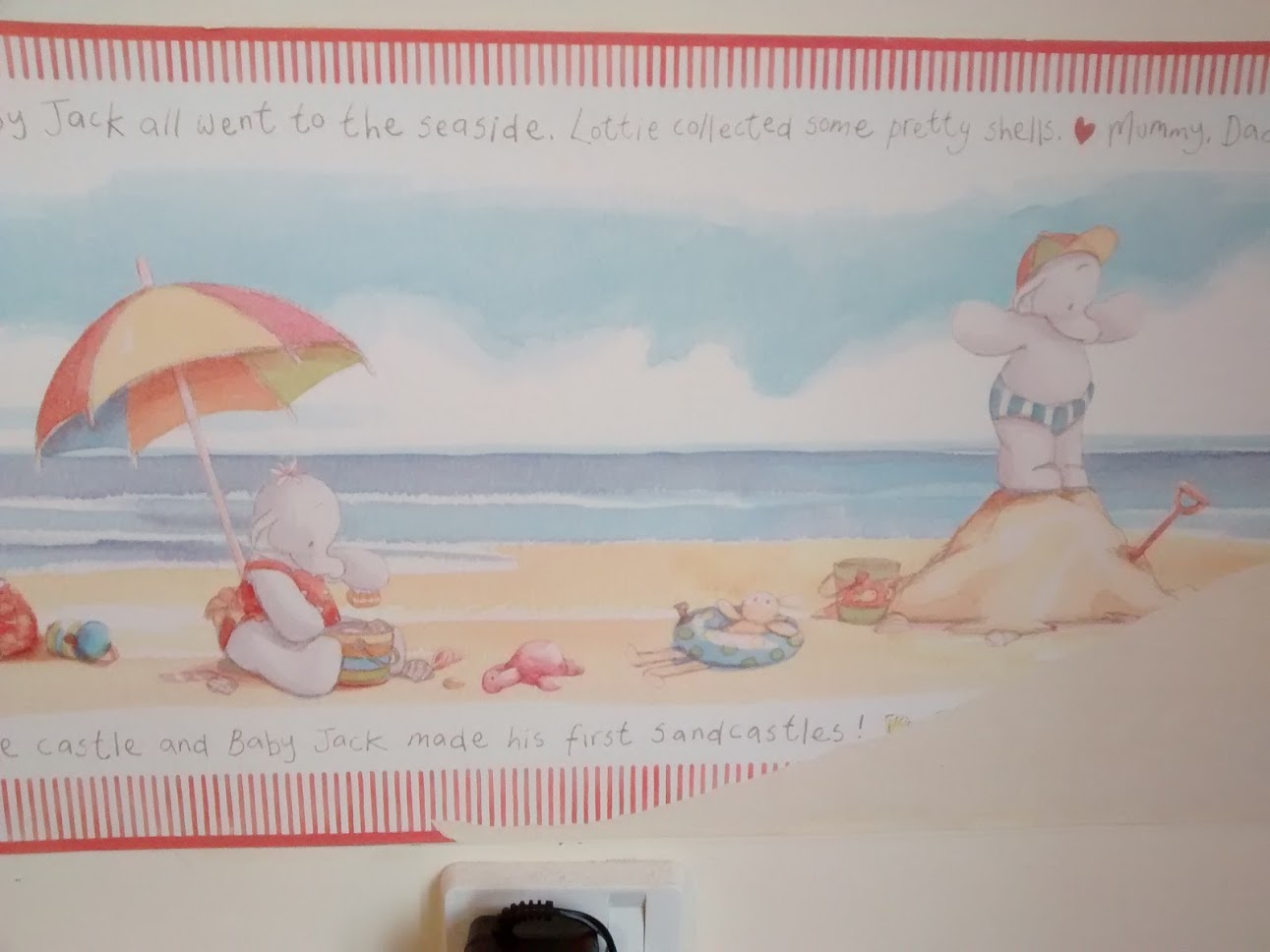

Don't put a border on unless you get a wallpaper stripper!
I snapped a picture of ours when decorating my son's room a few years ago. Was a nightmare to remove, but I didn't own a wallpaper stripper a the time!

Apropos a border, I agree with with Jonbey. Even with a steam stripper they can be a mare to remove because they often glued using a PVA type glue rather than a starch based one.
