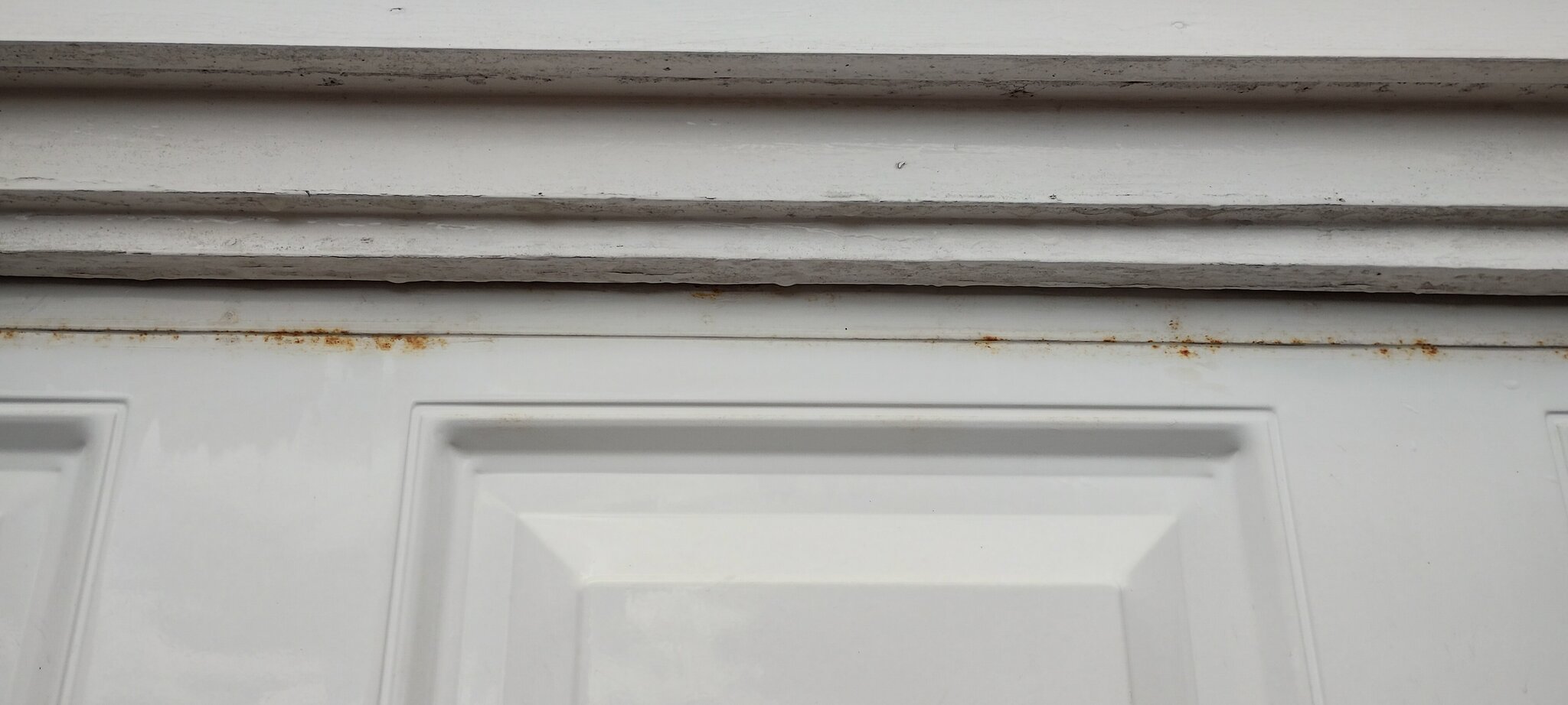

Painting a metal garage door with rust.
3 Feb 2009
226
5
Buckinghamshire

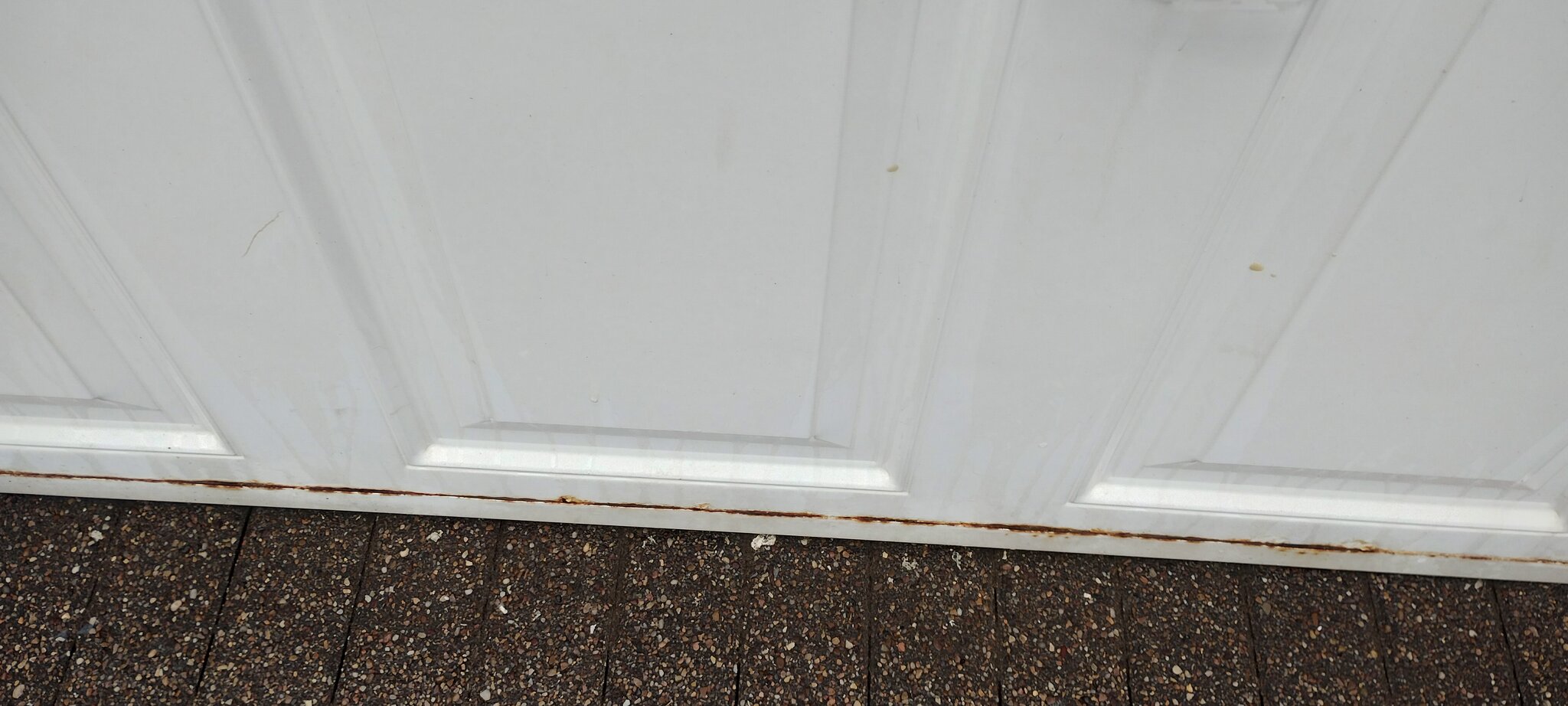

I have a metal garage door that I want to paint white, there is rust on the seams.
What is the best procedure to stop the rust coming through?
20mm tungsten scraper and sand.
You need to remove as much rust manually as you can.
You can buy rust treatment but it won't work very well on deap rust, just use on what's left.
2 pack resin filler.
Sand
Paint.
I would consider a cover strip, as there looks like a joint which is letting in water causing rust..
