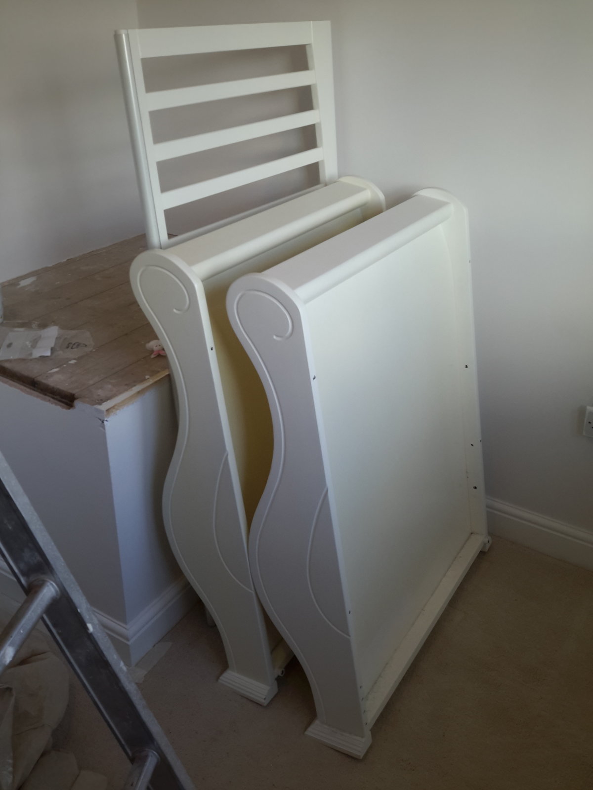

I have a white cot which has suffered significant yellowing. The room it was in before didnt get any sun. It cost £300+ when new so we are using it again for our second baby. Anyway, its currently dismantled ready to paint. I want it to still have a smooth eggshell surface and the only way I can think to do this is by spraying it. Especially with the railings which would be a mare to paint.
Suggestions welcome. Thanks!

The fact that it yellowed makes me think that it was previously sprayed with an oil based paint, which is odd.
Firms used to use two pack paints to spray furniture but they don't yellow. Unfortunately they are pretty dangerous to work with (they contain isocyanides). Many, if not most have now moved over to waterbased spray finishes.
Given that you probably want to use the cot pretty soon I would recommend against painting it.
I have previously sprayed clients' beds with 2 pack, I could still smell the solvents weeks later.
Oil based paints take longer to cure than 2 pack.
Waterbased cures slower than 2 pack but faster than oilbased. There are supposedly "cot friendly" paints but I have never used them. The paint industry would have you believe that water based paints are safe- they are not- they are no safer than oil based paints. The key difference is that the latter release more Volatile Organic Compounds whilst curing.
I am the kind of person that used to smoke whilst spraying 2 pack acid cat. I don't normally subscribe to the "OMG don't do that" mantra, BUT babies are fragile and far more susceptible to suffering adverse effects from environmental factors that would not affect you or I.
Please proceed with caution- and for what it is worth, best of luck.

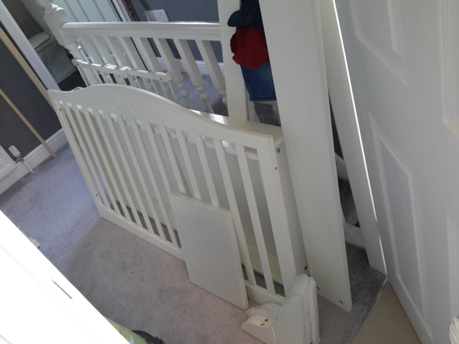

wow, its been a while since I asked this. I'm getting in the garden to spray this cot next week with the nice weather, and looking for paints. Would this one be ok?
http://www.leylandtrade.com/products/product-detail/acrylic-eggshell.aspx
I'm going to get a rather large pot of it as I want to allow for significant wastage using a sprayer. The datasheet says its suitable for spraying when watered down, and has low VOCs. How much would you say to get for a large cot with bars and solid ends as pictured?

I can't comment on the sprayer but the little cup thingy with the hole in the bottom (viscosity cup) should help you work out how much water to add. Count how quickly the drips come out the bottom and add more or less water accordingly.
I would strongly recommend buying some Floetrol rather than simply thinning the paint so much that you are spraying coloured water. Unfortunately Floetrol isn't cheap. Polypropylene Glycol is the key ingredient but I have never used it instead of Floetrol- no idea if it will result in the paint drying too slowly.
Heating the Leyland paint in a bucket of hot water will also help to atomise it (it will decrease the viscosity- ie make it thinner).
2.5L of the Leyland should be more than enough.
Experiment first though. Waterbased paints are more difficult to work with (because they are so thick).
