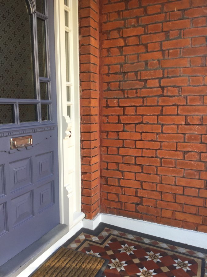

Did this door last week in a weathersheild trade QD satin. Used the dark undercoat first. Between coats I used a 120 grade 3m green scratchy (they look like pots scrubbers and you can find them in automotive paint suppliers).
Pre any paint it was 120g sheets, mid level wire wool and then the 120 green scratchy. Surface bumps were filled with Bonda (a 2 part filler). Mostly done with a 1.5" man made bristle and a 1/2" sash brush for the glazing bars.
When you use a QD satin have a clean cloth and water nearbye. Just becore you apply the paint moisten the area to be painted. The extra moisture allows you to lay on the paint and finish in a clean stroke avoiding dragging and the paint drying too quickly.

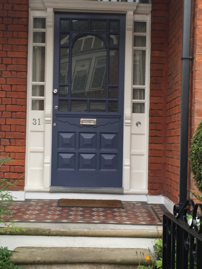

Your photo of the blue door in Weathershield QD (quick dry water based?) does look quite shiny, not very satin.
Is it an easy paint to use? I have heard that some of these QD's are difficult to apply, talk of 'picture framing' etc - is that the cut in lines showing through on panel areas?
Is Dulux Weathershield the paint to go for? I would be happy to go to another brand if it's good. Even a solvent based paint if it is better/easier to use. It is on an exterior door, satin of course - not high gloss.

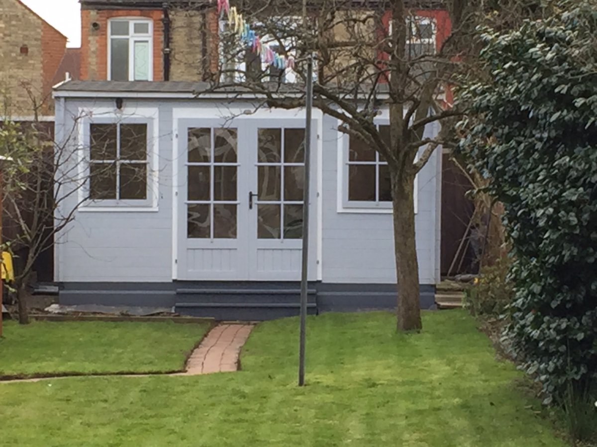

Superdec is a decent product, i used 20 litres on my man shed thing, bare wood and paint.
I wouldn't be using it as a finish on a front door.
Anyway back on topic- water base satin is a quick dry solution for front doors, saves having to keep door open due to oil being sticky, saves running a dab of vasaline on jams etc.
The thing about satin is it will look different in different light. South facing door will have a different (lighter) look than the same paint on a North facing door.
If needed with quick dry satin you can either add 5% water or wet down the job (which is just running a clean water film prior to painting that area.

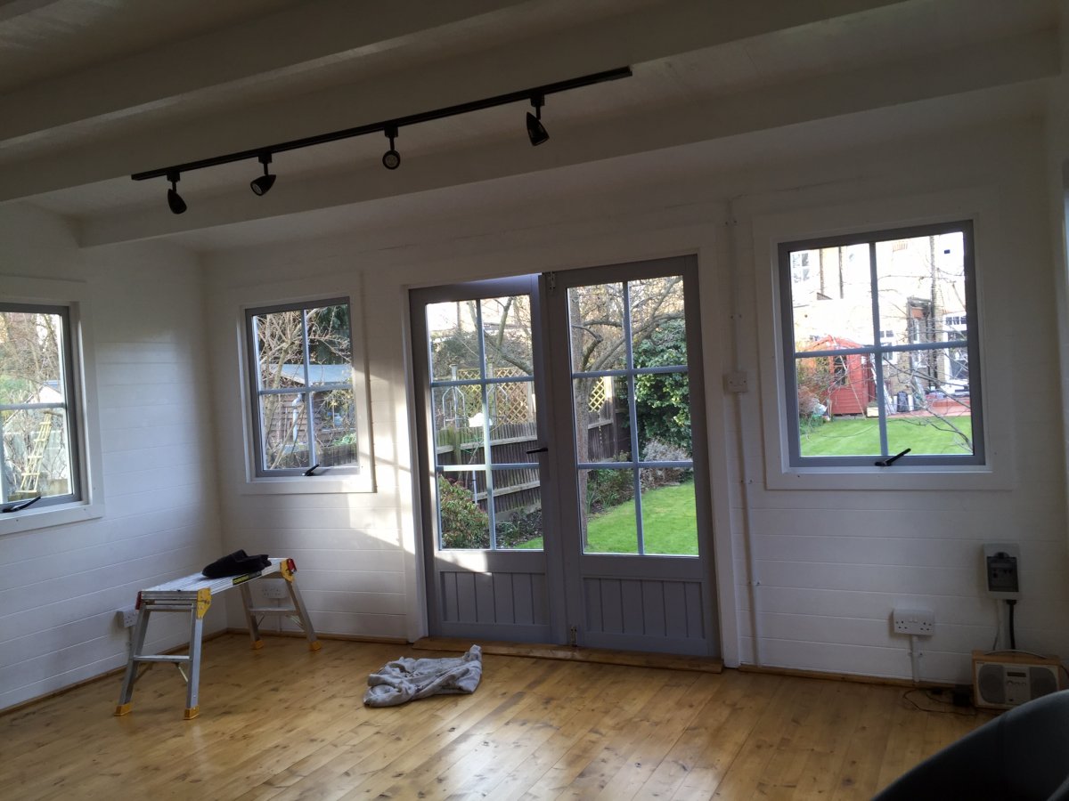

Your door, your chocie. BTW the door you said was blue is grey.
See the last two pictures, which show how much light and angle (plus iphone camera) change the light / depth of colour.
