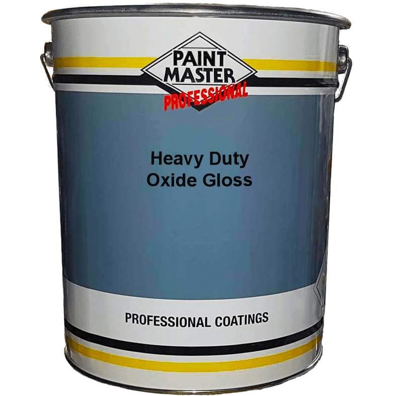

What about giving some thought to specialist paint coatings such as used on farm buildings and equipment. I used a HD product around 12yrs back on my workshop and its still good and weather proof.
That might well be a decent product. Difficult to tell given that the site is registered in the UK and the product details are in German- not quite legal...

If you want good protection, then IMO buy German via an established importer.
I am not doubting the quality of the product.
I have only just noticed that your hyperlink went to the German translation of the site. Dunno why.
As an aside, the paint in question is made in Derbyshire, England.
They do seem to have a decent range of specialist products though, tnx for the recommendation.
