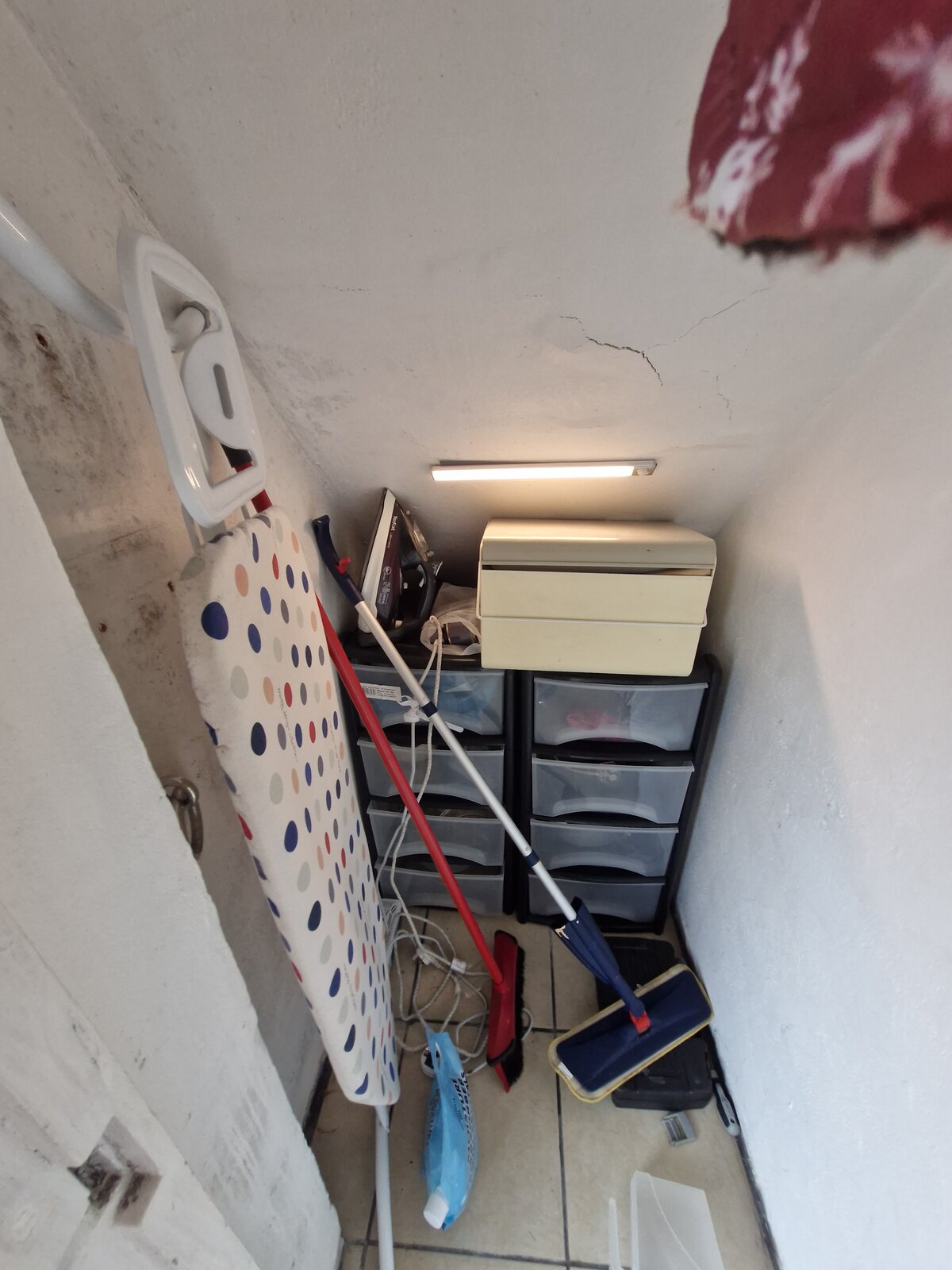

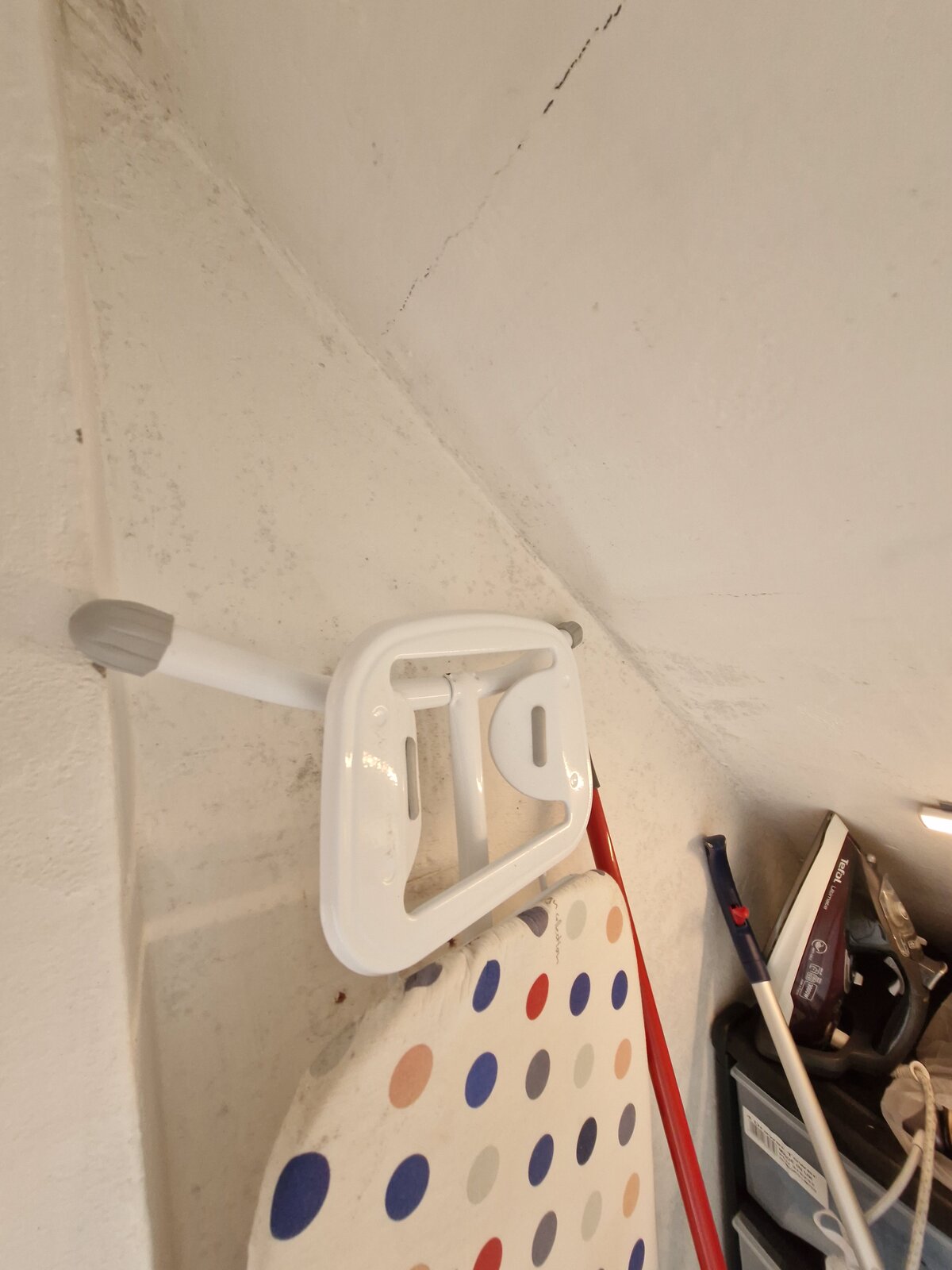

I have a small under-the-stairs cupboard which gets a bit mouldy. I'm going to repaint it. Is there any particular "anti-mould/damp" paint I should use or just the bog standard stuff?
Thank you.
I can't unfortunately. So I just put in crystals, and use a dehumidifier every so often which keeps it under control.

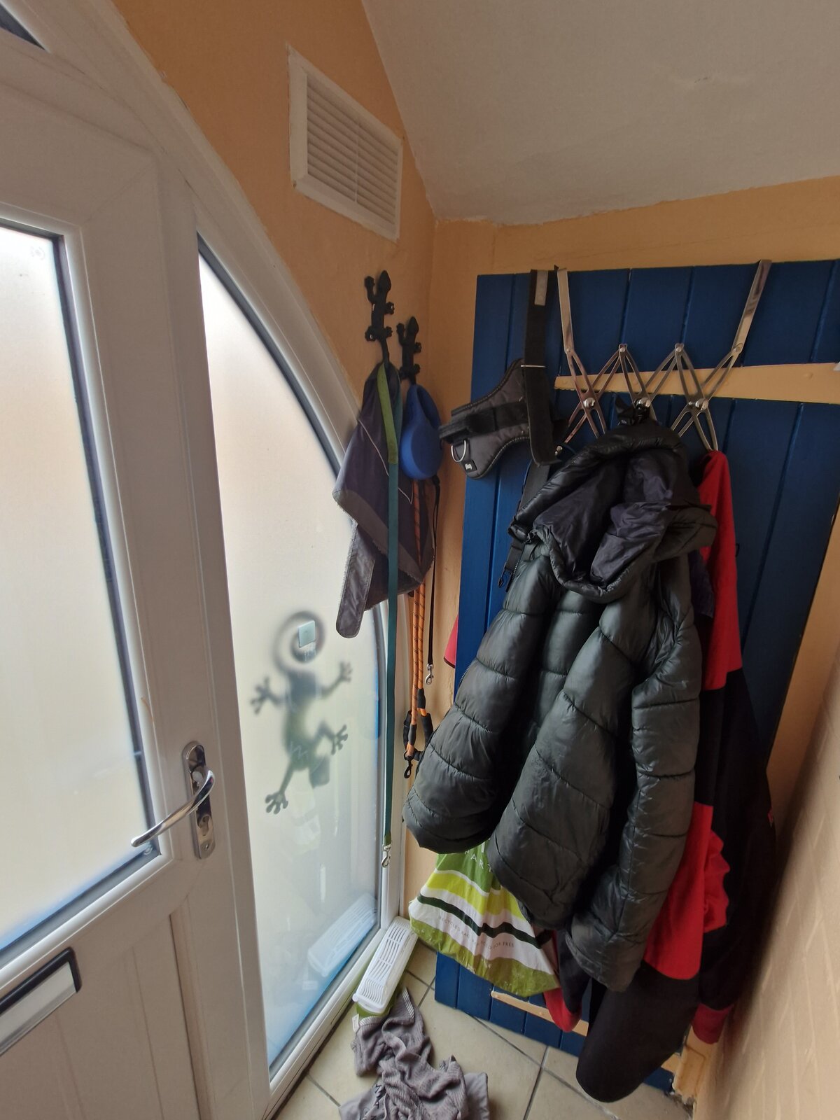

I don't know if that would help as the door just opens out onto my little porch... There is an air-brick thing in that wall but not inside the cupboard.

The water is coming from somewhere. Is it a leak? A damp floor? Condensation from an adjacent steamy room? Wet laundry?

You can use a Dulux Damp Seal. This is available as water-based, which will be more pleasant to apply in such a confined area - and allow to get the emulsion on quicker.
No doubt oil-based/solvent based versions are still available.
Anyhow, this will not solve your problem.
It will only mask the problem.
You might get a year out of it. You might not get five minutes out of it.

So it's under my neighbour's stairs, the stairs which go up to his flat. Perhaps because there's no ventilation in the cupboard itself that's why it is getting damp? Would drilling a few holes in the outside wall help?
