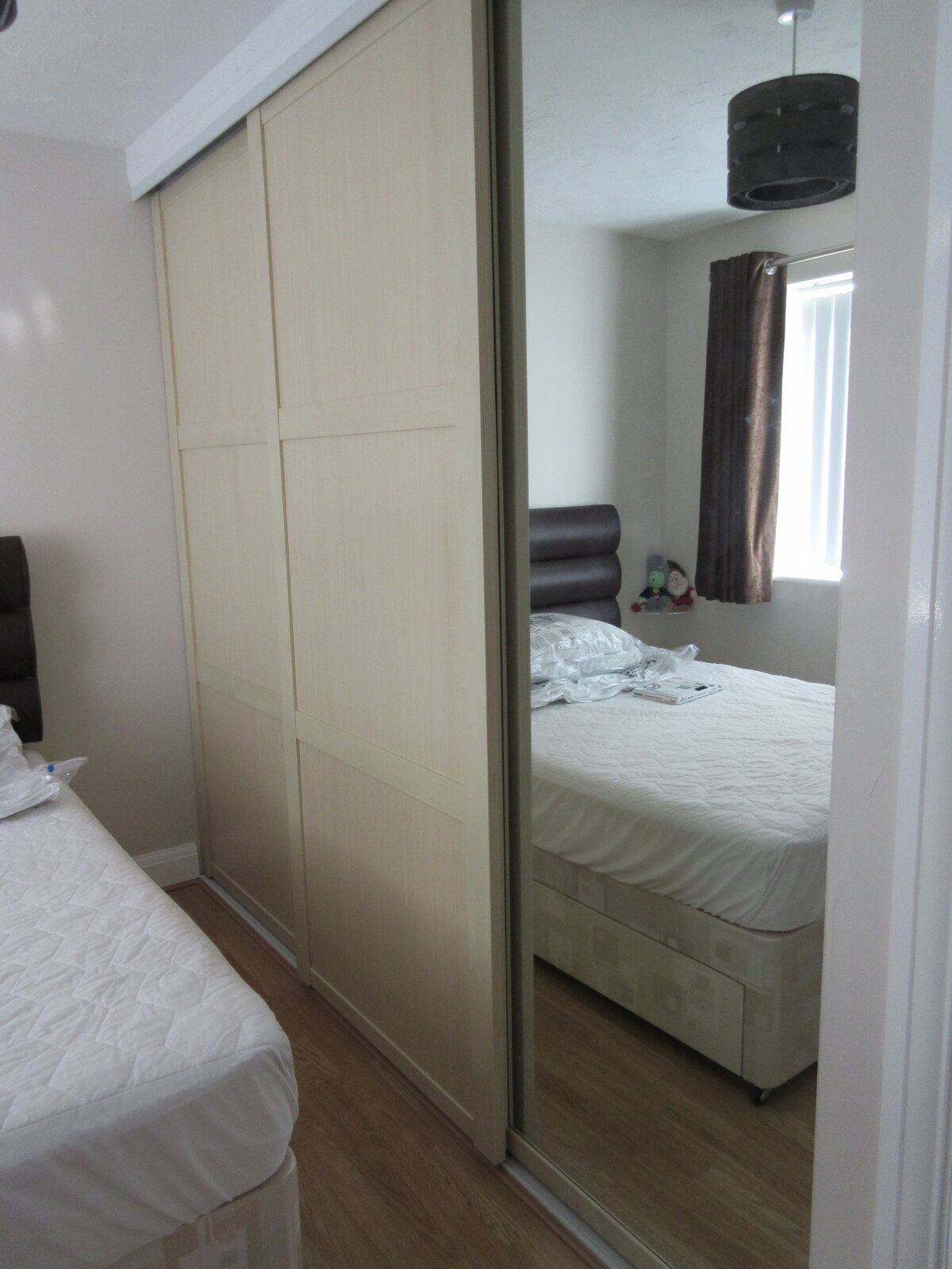

Can only find old threads regarding painting melamine, wardrobe doors. Have done some research & know to use a small soft roller (not too hairy or foam), clean doors thoroughly, sand down to get a good enough 'key', but can't find a few recommendations for primer & melamine paint.
Only 1 from someone who used 3 coats of Leyland Acrylic primer for wood & metal, then 2 coats of V33 for cupboards & worktops though the tin instructions for V33 says no primer necessary.
Anyone painted melamine lately? Thanks.
The Leyland primer will not pass the fingernail test. I do use it to prime timber and plaster though.
I normally recommend my customers against painting melamine. It isn't something that I have done for a few years. From memory the last time, I used the International brand of melamine primer but I did key it first.

I have some Billy bookcases to paint at some point soon which are also melamine covered, my research eventually had me speaking with Zinsser, they're recommendation is as follows:
1. Wash them with hot soapy water and dry off (ie washing up liquid).
2. Wipe over with meths or white spirit.
3. Prime with Zinsser Bullseye 123 primer.
4. Paint with whatever paint you want to use, I'll be going with Dulux Satinwood.
I suspect I will give them a complete run over with the sander beforehand.

I don't understand number 2. Meths is good at degreasing, isopropyl alcohol is better though (no residue). White spirits however is pants at degreasing.
I was going to go with Meths as I've always felt white spirit leaves a little residue but isopropyl alcohol sounds like a better choice.
Both meths and white spirit leave a residue. The latter leaves more though. If applying oil based paints the residue left by white spirit isn't too much of an issue.

Thanks for suggestions. Reason we decided to paint is it's a little used spare room & an 'alcove', but even just 3 doors & the track, quote was £2k (no fitting). Even Ikea was a pretty hefty price, so thought we'd only resort to purchasing afresh if we wreck the doors by painting.
Cheerss (& sorry for HUGE photo!).
