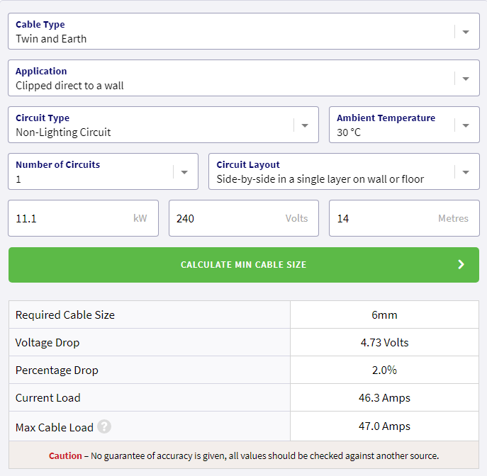

Have had question answered to some degree by other requirements. Am also installing an induction hob max possible load 11.1KW. Now using 18th edition calcs I need it staes 16mm2 cable as the run is 14m.

I was just putting in the possible load of up to 11.1KW and the distance into a calculator, found it on the TLC site referring to 18th edition and it comes up with 16mm2.

For a start, 11.1kW @ 240V is 46.25A. 6mm² T&E can take 47A.
However for cooking appliances, which do not draw the full load at any one time, we use a diversity calculation to determine the design current.
That is the first 10A plus 30% of the remainder; 36.25 x 0.3 = 10.875 + 10 = 20.875A.
Therefore the circuit I have stated twice will be more than adequate for the hob (and the ovens as well).
