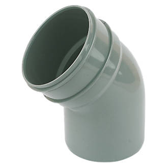

Just wondering... the current pan connector is 3 1/2" outlet end. Can you get 4" female to 3 1/2" male couplers?
I could then put the right way round elbow into it.
could you get one of these onto the 3-4" stub?
th
Sorry, I meant the 3-4" stub was overall length, with only 1.25-1.5" of it exposed outside the socket.
Even if I could, it would make the pan connector go upwards before going down.
The one I linked to a couple posts ago has a tight bend so would stay lower than the pan spigot.

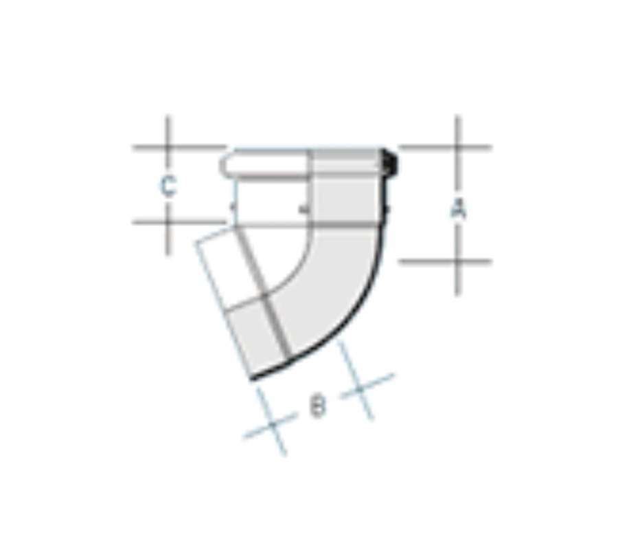

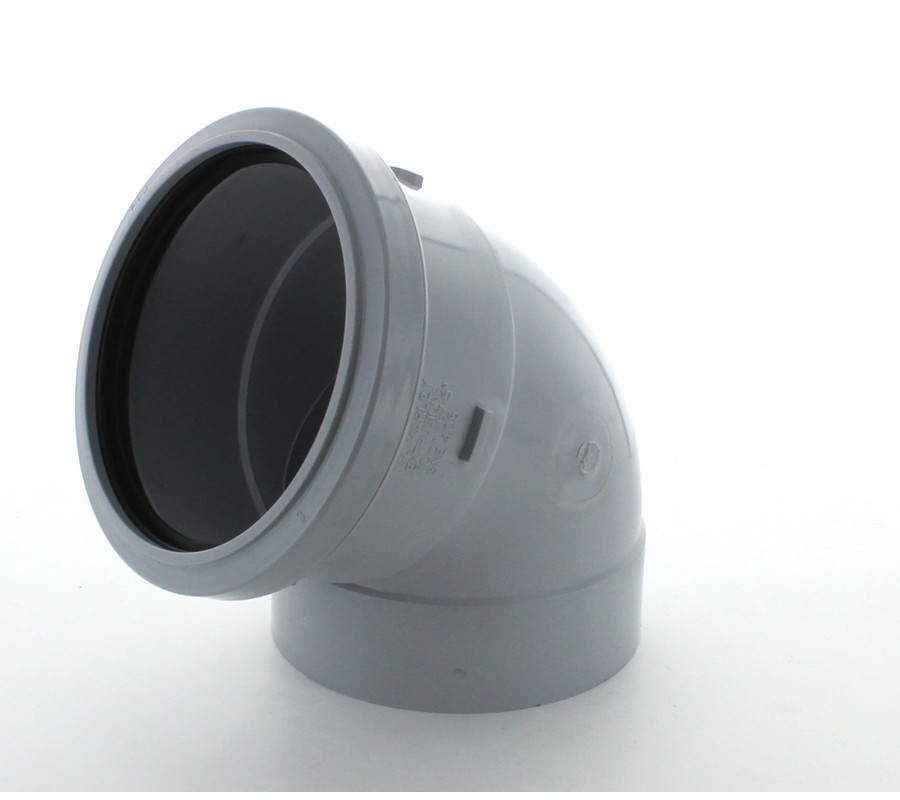

If you look at Marley product SNE405, it's almost the perfect one - slight angle, the picture shows the solvent end as 'bottom' and the 'depth' looks really short though which would keep it low and be a full fit for the short stub piece I have; the technical diagram shows the push fit end depth to be 60mm (dimension C), so if it's all to correct scale the solvent end can't be any more than 30-40mm (1.1-1.5")
Only problem is the inlet end is socket.

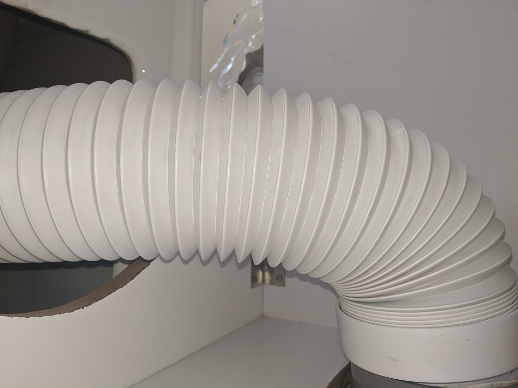

Now you have shown us the side view, I'd be tempted to move that toilet unit out of the way and alter the waste coming up through the floor so it is below the level of the pan spigot, then alter the cabinet so the run can be fitted better.
Just to confirm, the waste coming through the floor is already below the level of pan spigot. I think it's the sharpness of bend that the flexi has to take to get in it, which bows it upwards.
pan spigot center from finished floor: 175mm
top of grey waste from finished floor: 40mm
