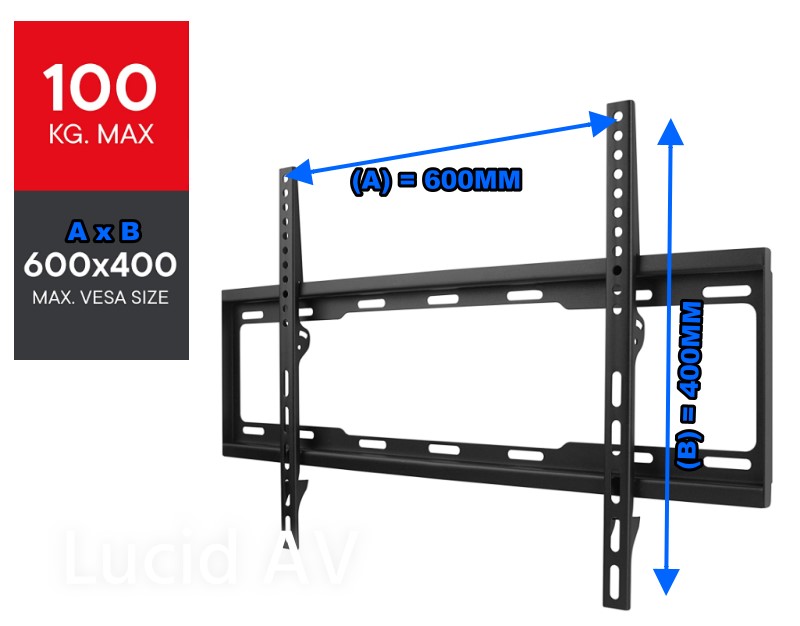

This can be wall mounted.
Because the bolt hole surrounds are bevelled inwards you'll need some spacer washers to fill the gap. Your bracket should only put pressure on the bolt mount points, and not across the back of the TV. Also be careful with the bolt lengths. Too long and they'll press on the back of the plasma glass panel and crack it.
You’ve jogged My memory, I used one like that I bought of ebay, to mount mine to the wall (wall version) mine didn’t have those caps as mentioned above.
The wall mount is ok, just not much adjustment. Think I paid about £15 back in the day.
good luck.
The Panasonic plasma predates VESA style bracket dimensions. Start with measuring the spacings between the centres of the bolt holes. (Take the plastic caps off first).
The bracket you listed has maximum dimensions of (A) 600mm and (B) 400mm.
You need to find one available in your country that fits the hole spacings for your TV.
