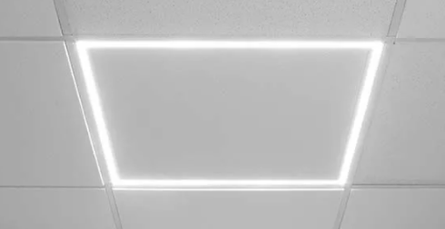

I've no earth in the lighting circuits in my house. In the bathroom there is a fixed skylight that is 650mm by 650mm size.
Am I allowed to install a Panel LED there? Ideally something like a panel frame LED like this one:
If you have any other suggestions too, kindly let me know. Thanks.
You can do what you like but you should do it safely. If it needs and earth connection you must provide one.
This is what I was intending to know.
Are these LED lights allowed in bathrooms?
Do they need earth connection (as there is no earth cable available in my old wiring)?
Depends upon the ceiling height. Whether it needs an earth or not should be in the manufactures instructions.
most bathrooms are directly below a loft. Obviously not all.
You couldn't get a better place to add an earth wire.
However most LED panels have a two wire transformer and operate on low voltage/ELV for pedants.
Nothing to stop you having the transformer in the loft. no mains in the bathroom and the light powered by the transformer.
