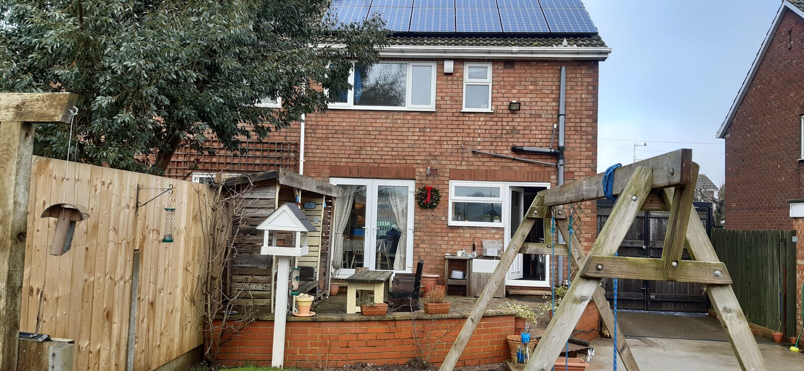

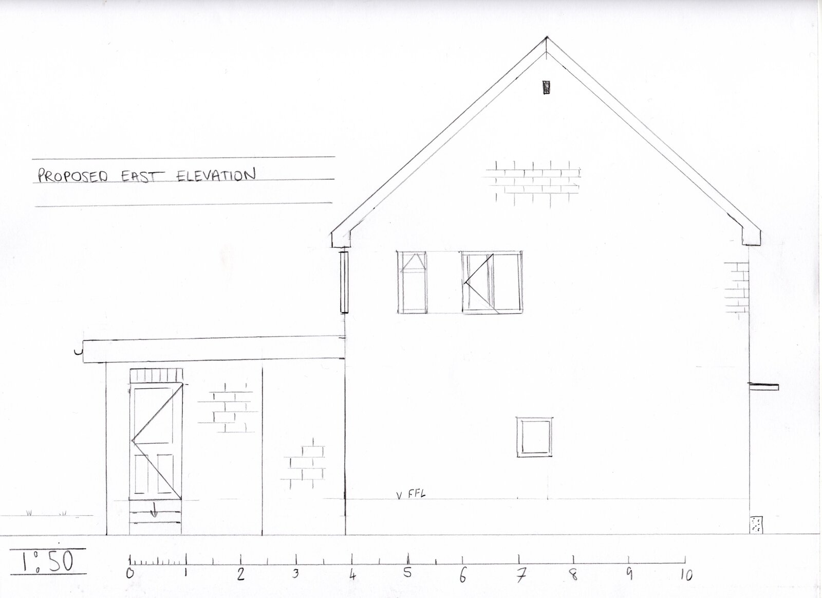

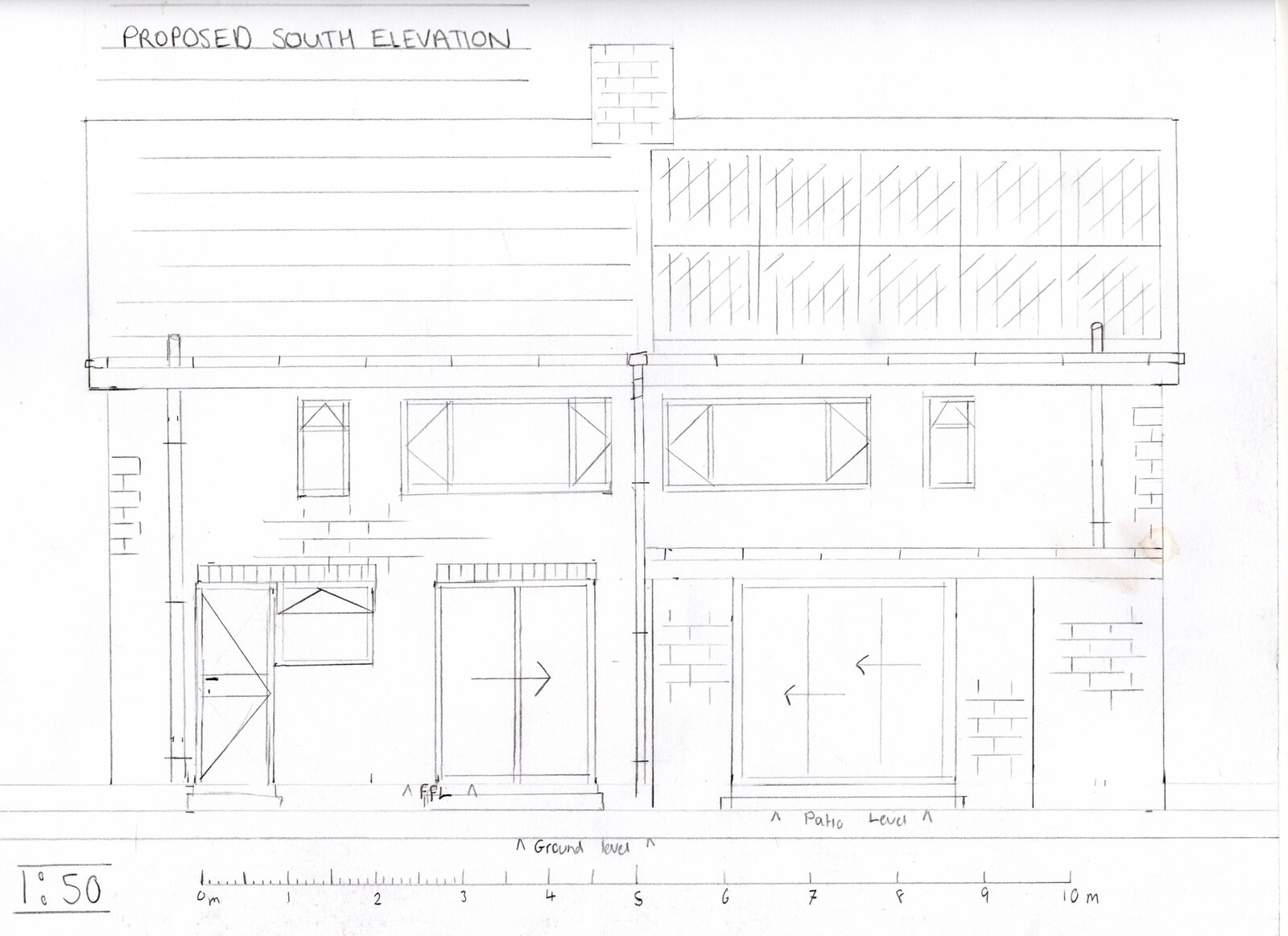

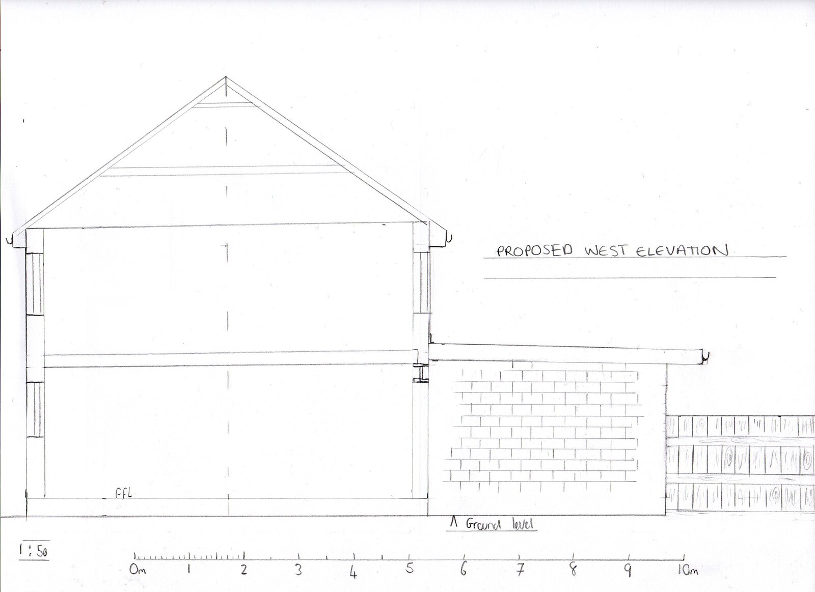

We want to extend out by 4.3m from the rear of our house, with a flat roof of maximum height 3m at the eaves. See drawings attached.
The neighbour objected on 5 grounds (drains capacity, PWA, surface water, noise and overshadowing). I get the first 4 are not material planning considerations, and everything regarding drainage, surface water, digging soakaways are all in hand. Its the overshadowing part im worried about. Our case officer is coming tomorrow to take pictures and i'm just having a last minute panic about it all. Do you think what we are proposing is overshadowing?

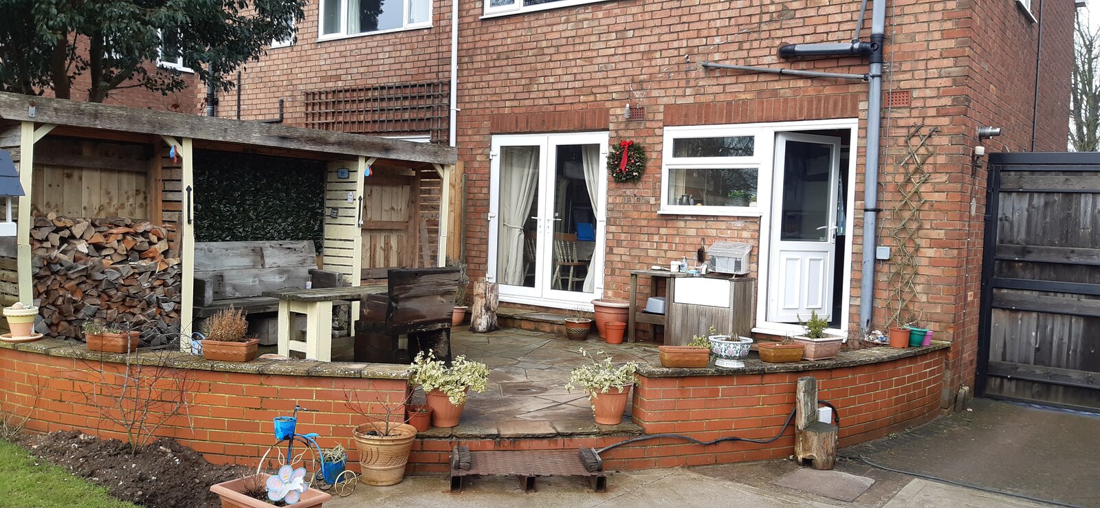

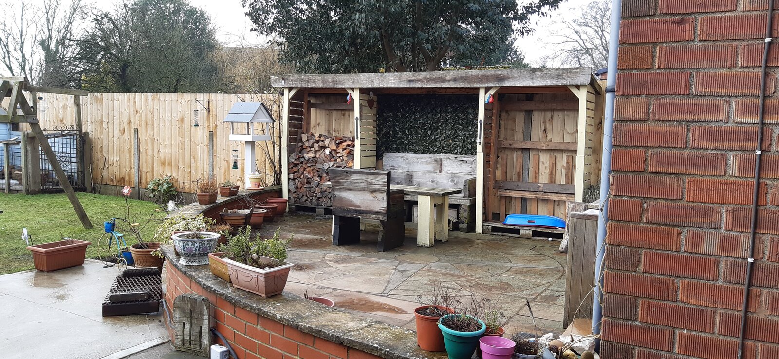

By measurement on the rear elevation drawing we adhere to the 45degree rule. I've also included some photos of the back of our house (do they take into account her 15ft tree overshadowing us?!). We are also south facing.

There can't be any overshadowing from a single story. The 45 degree rule deals with light, and if you conform the the council's policy then that can't be a reason for refusal
Thank you. Is the planning officer just attending to adhere to processes? It all just seems very drastic :(
Planners are supposed to attend site unless they have enough info from the application or Google Streetview. I've had to send photos in for the last few apps I've done as the planner could not come out "due to Covid".
Yeah, I think you'll be fine. They'll look, and hopefully see that it will not shadow the neighbour. Their tree must cause more shadows that a new roof, that won't be that much higher than the structure you have there already.

What is your LPA’s guidance on outlook, amenity and daylight?
The ERYC guidance states that anything of 3.5m deep is generally acceptable, but that each development proposal will have it's own merits. They take into account orientation of the site (we are south facing) and things such as whether it will overlook overshadow neighbouring properties (which is kinda what I'm trying to ascertain).
So its prescriptive, but with room for opinion I'd say?
Ok so yes, Paragraph 3.4 of your LPA’s ‘Design Guidance for House Extensions’ states...
“In order to provide general guidance it is suggested that single storey extensions should not normally extend more than 3.5 metres if directly adjoining a side boundary. This is to prevent unacceptable overshadowing and loss of light to the neighbouring property. The extension could be increased by setting in the extension from the boundary. Two storey extensions have a much greater potential to overshadow and dominate a neighbouring property, so unless set back from the adjoining boundaries two storey extensions will normally only be permitted to extend 1.5 metres out.”
As this is guidance and applications are determined on their individual merits, the LPA may well look to address the overbearing impact on the neighbour. How they asses this is down to them because some LPA’s use a more lenient 65 degree angle for single storey extensions. These angle lines can be taken from the edges or centre lines of windows/doors that serve habitable rooms as LPA’s have different criteria. If those windows/doors are secondary to that room, then that would help strengthen your case.
