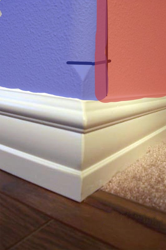

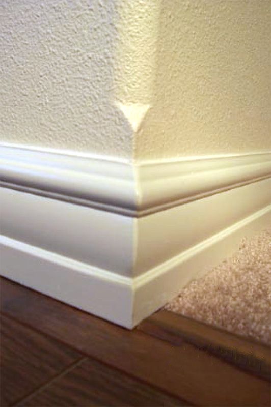

I'm papering the front reception room in our 1912 house and have been presented with a challenge which is new to me. There are two outside corners, which I understand are referred to as arris and bullnose corners, in that each corner has a small arris at the top and the bottom of the wall and is bullnose in between, which results in a widening inwards curve from the arris tip to the bullnose (example pictured below)
The only suggestion that I have seen posted is that the paper should be set up to go all the way around the corner, so that it is sitting square on the top and bottom arris (therefore loose over the bullnose section). Then, using a blade, slice down the middle from arris point to arris point over the bullnose. The rest of the post however less clear but apparently involves overlapping the cut edges over the bullnose section.

The blue is sheet number one. Wrap it around, cutting horizontally at the edges of each arris.
Then lay the second sheet of paper (red) over the first .
Use a long thin straight edge and cut through both sheets of paper, then remove the excess.
I use 9mm snap off blades, snapping them off as they become blunt. I also use something like this as a straight edge to cut against.
