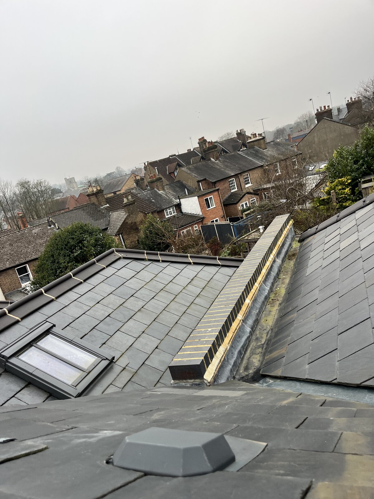

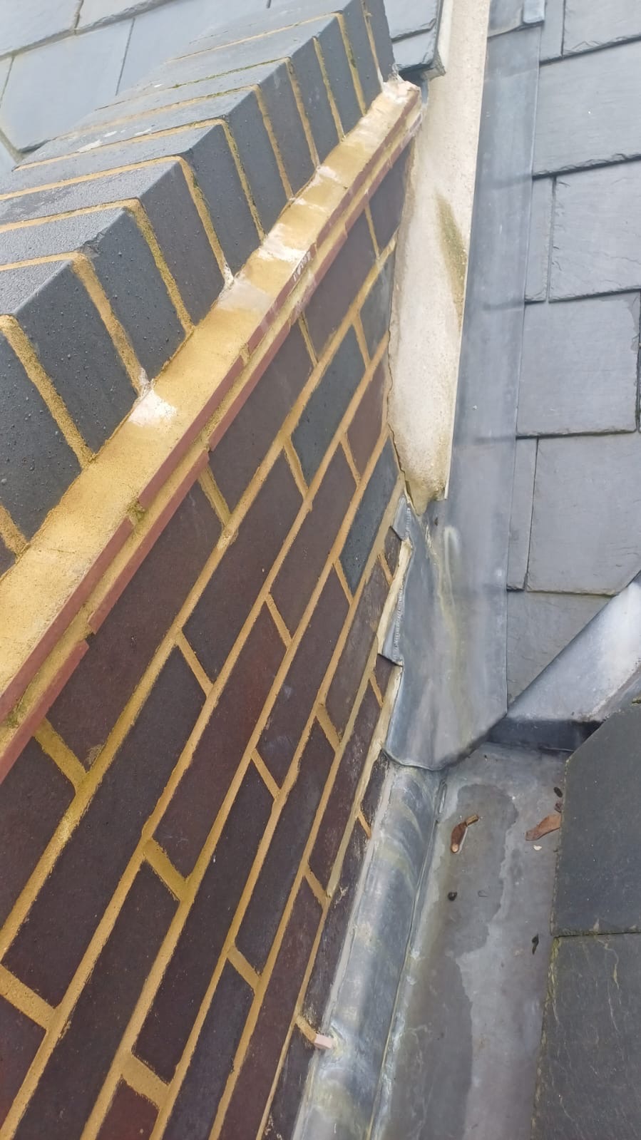

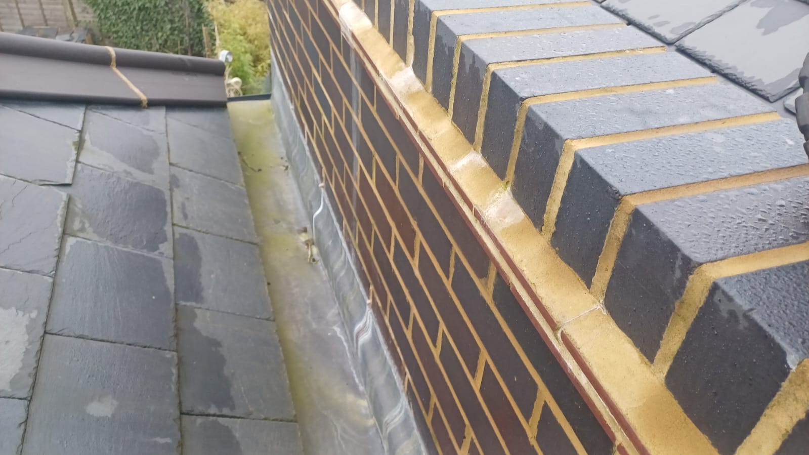

Hi there I have been having some slow water ingress that’s causing some mold to form. The cause appears to be be damp coming through the parapet wall between myself and my nighbours house. We both had extensions at the same time, but where I used a builder he did his himself, but he did use a professional roofer for his roof. My neighbour is an extremely difficult person to deal with, and He insisted on building the shared parapet wall so I have no comeback to my builders on this and I even paid another roofing coming to redo the part of my roof that is by the parapet to ensure it’s not that as my nighbour was claiming it’s my roof that’s at fault. I have photos of where it appears to be coming through from his side. The houses step down on the street hill and My side is covered in lead to the top but as his house is lower he has much more walk to cover and so has a lot of bare brick showing. can I have some opinions on if this is any good? To me the wall looks like it should be rendered or wrapped. The wall stays soaked even when there’s been no rain for days and only ever looks dry in summer. This has been going on 2 years so any advice is appreciated. P.s the worst of the damp appears to start where the cement is on the left where the roof pitch comes down

The lead's wrong on the pitched section. I'll leave it to the professional roofers to tell you why.

Thanks but I failed to mention iv had 3 roofers look and not point anything out that’s why im trying here to see if I can get anywhere
Let's see your roof too. Ideally seeing height difference between yours and his a bit better
Cement fillet will be doing nothing to prevent ingress as well as the end of the parapet wall, once it gets wet the moisture falls thru the wall and emerges one side or the other or both, you appear to be on the receiving end of side.Cause seems to be poor detailing on both sides of the parapet.
As the leak seems to be on your side why are the photographs of your neighbours side?
There's a lead tray low in the wall which would protect the lower roof which I think is your neighbours as it's low down .
This leaves the higher roof unprotected from water within the brickwork above that tray .
That's what I see .

Thank you that makes sense but where would the tray need to be to protect my side ?

My side of the wall is internal and on the receiving end of the damp so I have shown the wall as the external part of it is my nighbours side

No it’s external only shorter than neighbour , end of wall will get soaked during rain and can’t see what’s under lead but could be likely source of ingress if not dressed correctly .Was lead work done by same people , looks inferior on your side?
