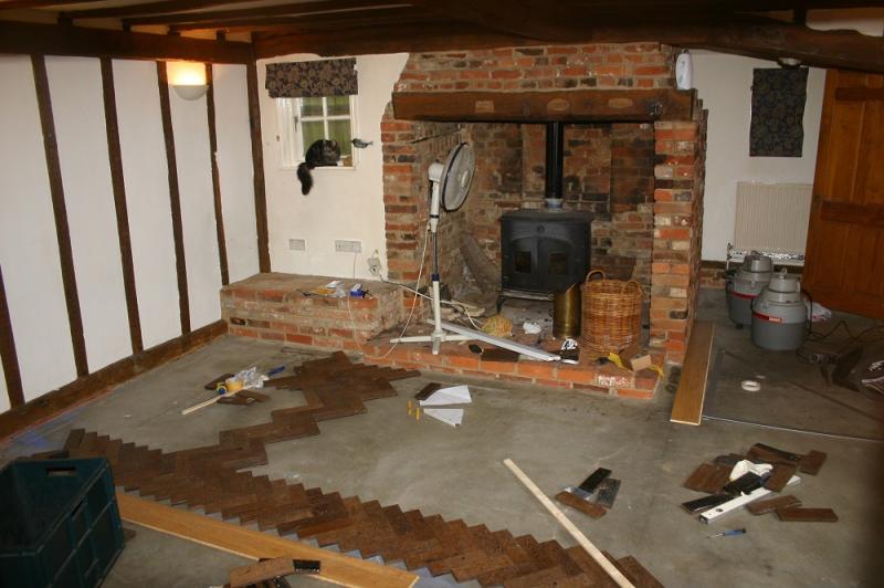

I am measuring up to lay some parquet flooring in the living room of my 17th century house.
My problem is that the room is not exactly square. The way the room is laid out you would typically be sat facing the large brick built inglenook fire place.
I could lay the pattern square to this focal point, however that would mean that the floor would not be square to the side walls of the room, one of which will be mainly be behind a sofa abd the other is a 400 year old beam which is roughly straight.
Or I could lay the floor square to the side walls but this would mean that it would not be square to the fireplace and focal point walling.
Of course I could lay it square to the fireplace and cut the border round the side walls not "square" into the pattern.
Any suggestions?

I am working from a centre line but the blocks then intersect the walls say square to the inglenook but not to the side walls, or vice versa.
So I could do a two block border all around and cut the border thick to thin or build a square pattern/border and fill in behind the blocks with slivers to fit the walls.

It might be helpful to see what I am talking about.
At the moment I have dry laid the middle strip parallel to the inglenook but this means it is not parallel to the side walls as show. The short line next to the wall is parallel to the wall, the long line is square to the inglenook.
As I suggested or would it really be so noticeable if you scribed the ends of the parquet blocks into that rather interesting looking rustic skirting, by the way are you removing that and cutting it to fix on top of the parquet blocks once laid, or putting in a scotia, or similar bead? ...pinenot :)
