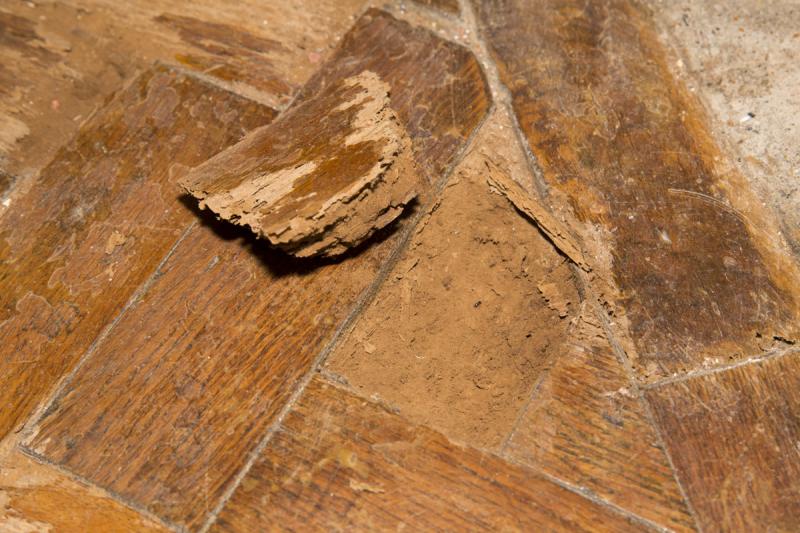

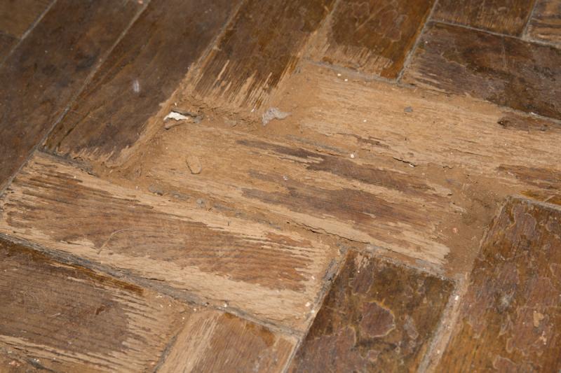

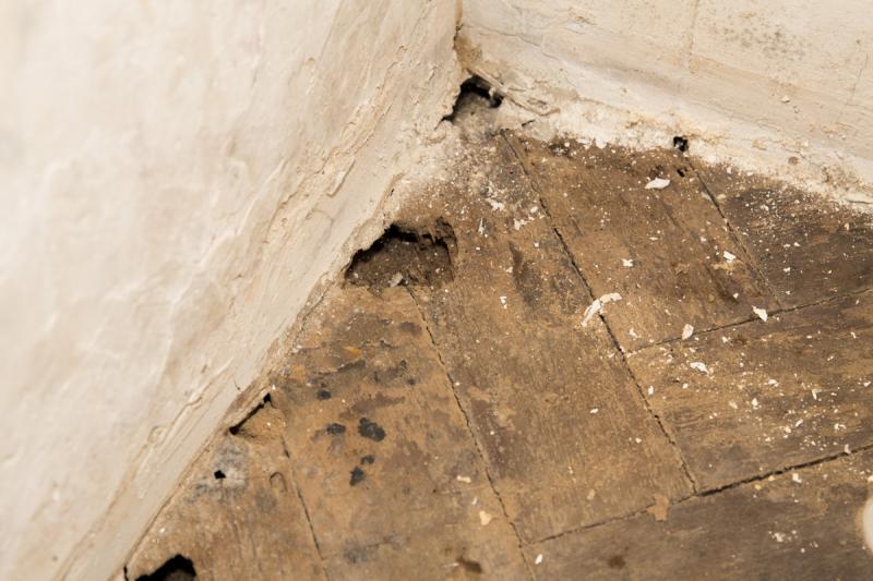

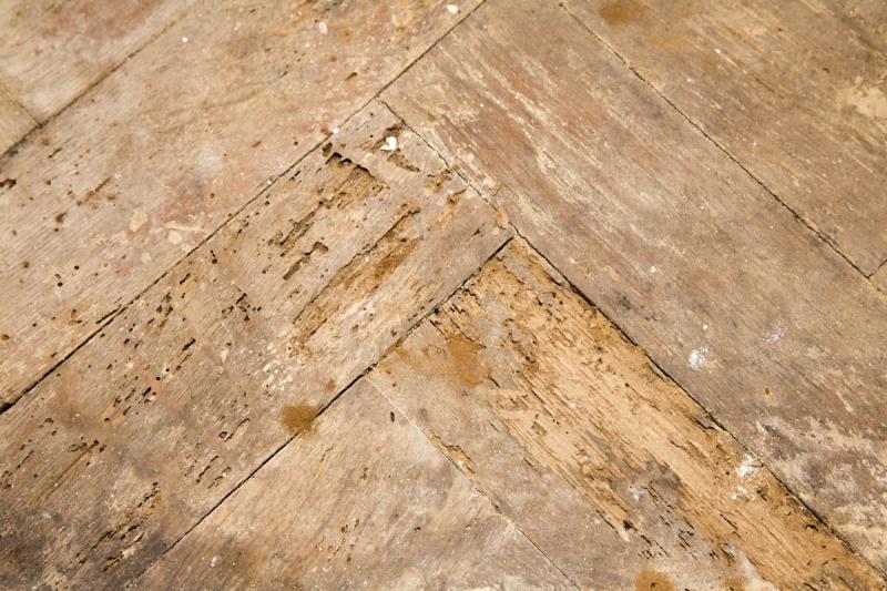

This parquet block flooring has some small areas of damage. They are all around the old fireplace, and I know that about 10 years ago there was faulty flashing which resulted in water running into the rooms.
I have tested with a meter as it's all dry now.
If this is just water damage then it's easy to replace the damaged blocks, but if it is woodworm then I will have to treat or replace the lot.
Any ideas on whether it's water or worm?
Both? Second one down is worm damage, but the others look more like water/rot damage
Urg, was afraid of that. I suspect they are linked as the worm holes are only in the wood in the centre of the area I think was flooded
hudster, if you are still there then there are other issues in your pics?
Yes, there's damp in the walls and, i suspect, in whatever sub-floor or sub-area you have.
A "simple" flood would not have caused such damage - its long term damage, and the "wood worms" are drawn to damp wood - there are flight holes near the floor/wall perimeter.
Your floor is shot and needs totally replacing. But you need to find the cause of the long term damp.

There is however a small section in the middle of the room which also some damage in small amounts. Cracked sub-floor maybe?

Whats damaged in the middle of the room?

Photos 1 and 2 are within the cupboard.
Photos 3 and 4 are centre of the room
As i said, your floor, ie the finished floor, is shot and all the parqet needs replacing - dont mess with lifting bits here and there.
Given its the only solid floor in the house then it seems that there was, probably, damp difficulties in the past.
It would pay you:
to look for a membrane below the concrete - it should be lapped up behind the skirting.
and go under the house and crawl and examine the joistings and if there is adequate thro ventilation.
