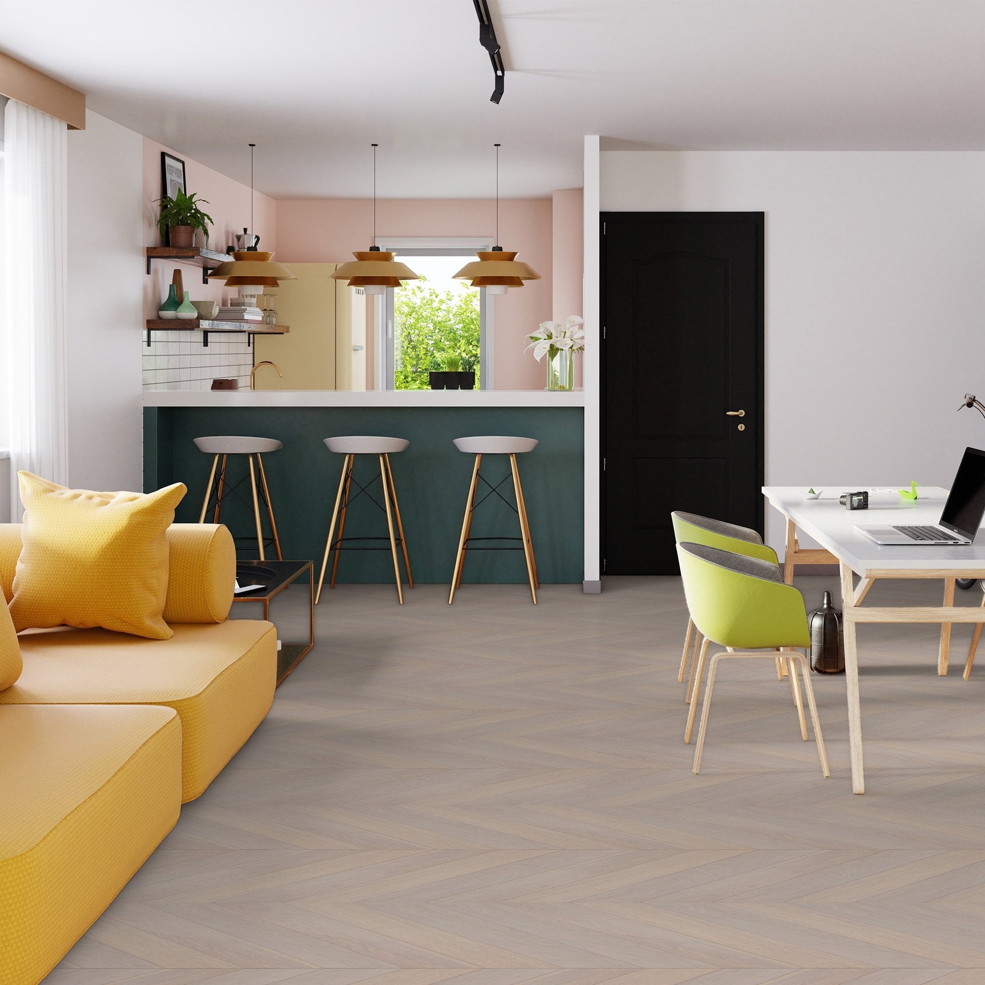

Hi all
I'm planning to lay some parquet flooring this weekend (though looking back on this I have no idea why I decided that, seems madness). My plan is to use 5mm underlay tiles and then to stick the parquet to the underlay using adhesive.
My question is, should I stick the underlay to the subfloor, or should I use some tacs here and there, or should I leave the underlay floating?

Sounds like it’s a clicknsustem gloating floor that needs laying on underlay.
Doesn’t sound like it’s a ‘proper’ parquet floor.
The packs should have the details the manufacturer recommends regarding installation.
Thanks. It's this stuff here. It's tongue and groove. Looks very normal rather than a bespoke fitting type as you see on some engineered flooring.
There's no obvious indication as to whether it *needs* underlay and there's nothing in the actual box when the pieces arrived.
Would love your advice.

From the description, to me, that actually looks like it needs to be fully glued to a flat screed prepared or SP101 Ply subfloor and can’t be floated on an underlay.
Plain tongue and groove and not being suitable for UFH would suggest fully stuck install
The website seller should supply full installation guidelines, very poor to be selling stuff without those guidelines detailed
