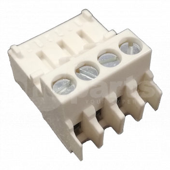

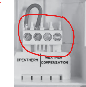

Hi All, i have a C30 boiler which i am trying to install a Salus IT500 thermostat too. Currently on the low voltage side of the boiler the open therm connector is missing, so i have no way of connecting any wires to it. I have been searching for parts but with no images available, its difficult to see if its the correct one. I have also called idealspares which were sort of useless. They gave me 2 part numbers but not sure if they might be the correct ones.
The number they gave me were either 181026 or 181025. I need the 4 way connector which is like the one circled in the pic.
Thanks.

this comes up as a roomstat connector? i think its different as when i tried to move the connector from room stat to the opentherm block it wouldnt fit. Its same size but he slot layouts are ever so slightly different.

This is exactly what I need and where I got the image from. But there's no part number for it.
I see :LOL::LOL: Well at least you have the correct name of the item to search for.
These people have a photo which kind of matches your photo but no part number as far as I can see.

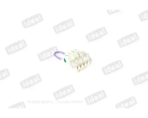

There is a part on the Ideal parts site for your boiler called
Ideal Part No: 179599 HARNESS EXTERNAL OT LINK​
But the photo is terrible. Several places sell it for about £6.50.

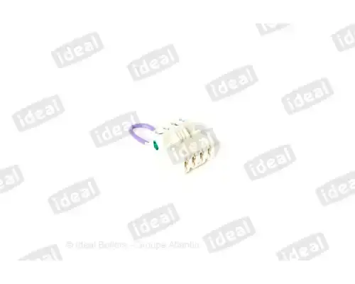

Thank you. Arrived and fitted today. All working. Cost me £16 in the end as had to be ordered from Ideal even though some sites said it was in stock.
