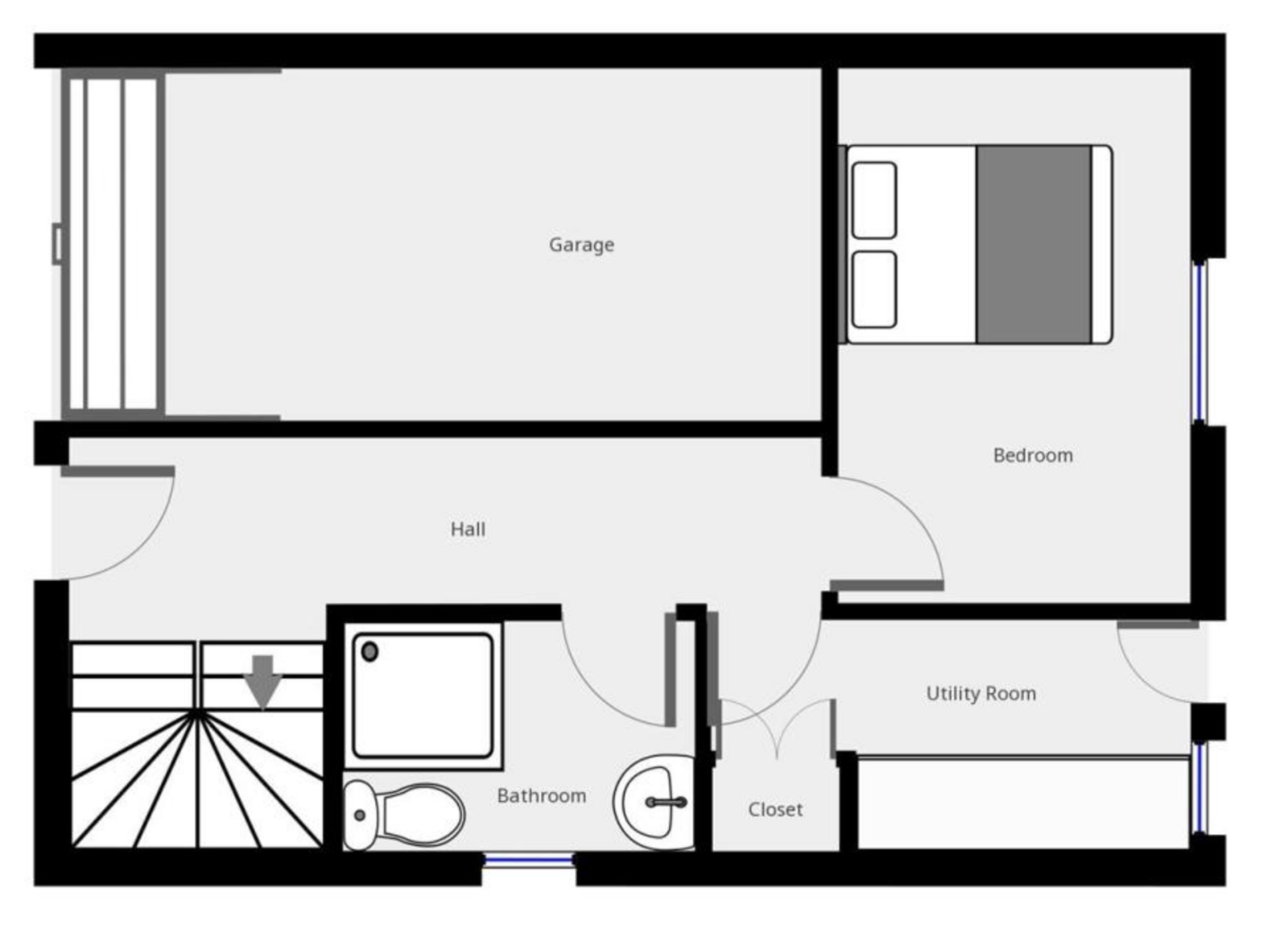

I'm just looking for some advice before I go out and find a builder for this so I know what to look out for...
We have a townhouse with an integrated garage which forms part of the ground floor, the floorplan attached but is missing an internal door we had fitted a couple years back from the hallway. We're now looking to semi convert the garage by replacing the garage door with brick/render and a large window. If my understanding is correct we don't need planning permission as we're not changing the overall floorspace of the building, not in conservation area etc but will possibly need building regs (which we also obtained when the internal door was fitted). We're on a managed estate where plenty of other houses have converted theirs - from what I can tell into fully habitable rooms.
The problem is we don't plan on converting the garage into a "habitable room", at least not initially as we currently use it as a home gym and don't really want the walls boarded, radiators fitted, floor raised etc. I'm sure we will down the line, at the very least before we sell it so we can list as a 4 bed but for now we just want the window for a bit of natural light and ventilation.
I'm not sure where that leaves us in terms of building regs both now and in the future... do we still need it now if we're not converting it into a "habitable" room as we're technically changing it from a garage when the door is removed? Or would we just submit a new application in the future when we look to convert it fully? Would that be a new application and not a retrospective one? It's not so much about the cost of obtaining it (£311) but we just don't want all of the pre-req works done in order to obtain it for the time being!
As far as the work needed it should hopefully be significantly cheaper than a full conversion too! Sadly my local planning office aren't approachable for advice and make it very difficult to get a simple question across before submitting an application.

So are you saying I can't brick it up without also converting it into a "habitable room" along with the revelant works and building regs that come with that? There's no possible outcome that just means there's now a window instead of a garage door but no further changes? The difference in work is thousands of pounds that we just don't want or need currently.

Then you will need planning permission.
Bricking up the opening is controlled work requiring building regulation approval, irrespective of what you say you are doing with the room. And contrary to common belief, inspectors aren't stupid, so will wonder what is going to be done with a garage that you can no longer park the car in.

In that case is there an outcome where I can get building control approval for the change WITHOUT it becoming a fully fledged room? Or is my ONLY choice to go ahead and do the whole conversation? Is there really no legally correct way to just have window put in without a full conversion?
Bricking up the door will require approval. As part of that approval process, you will need the resulting room, and any other associated works to comply with any applicable regulations.
So, effectively you are applying to convert the garage ... convert it from a garage.
Whether the council agree with what you are converting it to, will depend on the situation. So unless you can tell them (and they agree) what the resultant work is required for the use you propose, then they will dictate what they require.
I can't see it becoming anything other than a "room", once the garage door is replaced for a window.
