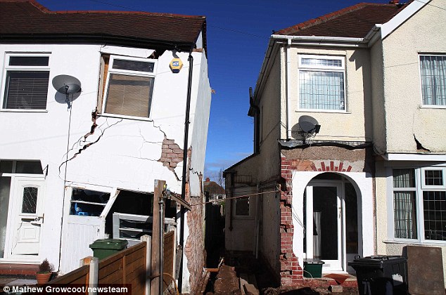

Oh and I found that photo, I'm sure the copyright holder wont mind as it is not for commercial use or personal gain.
Its my good practice but I'll let you have it for free
Very kind, but I'll stick with a few million others and follow the more traditional good practice. Thanks all the same :whistle:
Be sure to check up on all your foundations in a few years time, and see if they are doing a mexican wave. (y)
That image is from a completly different situation, BTW
Really, I seem to recall in the newspaper article they blamed the builder next door. What caused the collapse in the photo then? You can see the excavation running alongside the existing shallow brick footing and you can see where the wall has dropped by about a foot. What on earth could have caused that sort of catastrophic failure, maybe they had a bit of a problem with moles?
He dug the trench too close and too deep to the neighbours foundations and they slipped sideways into the trench. He should have shored the trench (not done it in 1m bays).
So exactly the same situation then? Where's Freddy when you need him?
