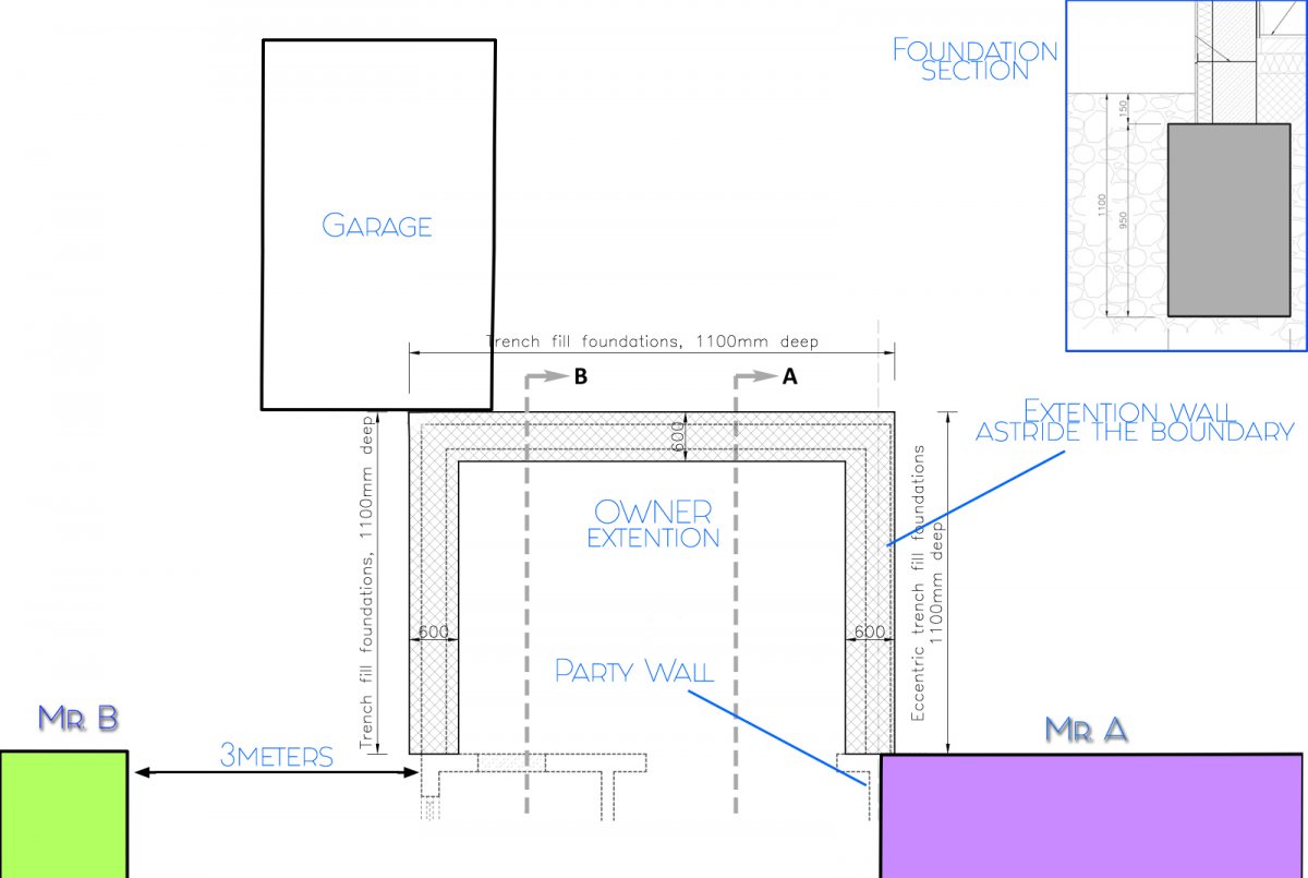

I have some questions on Party Wall notices for a rear (rectangular) extension on a 3 bed semi. The property has a side alley leading to a garage that will be demolished to form a patio.

For neighbour Mr.B of the adjacent property, we are separated by an alley with a width of about 3 meters. At first I was confused when someone pointed out there may be no requirement to serve them notice of Adjacent Excavation.
On second thought and further reading, I believe the footings of the foundations may fall within that distance under the ground. I would appreciate some advice on this, obviously less PW notices is better but prefer to be on the safe side. I will post a structural plan and a sketch when I have it in the next day or so.

Added a simple drawing of the extension and either side properties, pasting in the foundation plans (sorry for the ugliness). Footing inset on top right hand corner.

To my understanding a wall astride the boundary line means that the outer brick layer of my 300mm wall will rest on the centre of the boundary line. Is this correct?
In the structural plan Mr.A's side, it appears as the entire wall on the footing (short dotted lines) sits in boundary centre (long dotted line). Unless this is just a drawing approximation it looks wrong. Keeping that on one side are there any negative implications building astride the boundary? I am happy to go either way.

Next question, the footing obviously protrudes on either side underground. Can this be adjusted, i.e is there room to play with the footing and confine within the outer line of your walls? Can the footing protrude under neighbour's land? It seems that on Mr.A side this is less.
The reason I want to know is for Mr.B on the left. If the footing goes under the alley the excavation falls within the 3m distance line and as mentioned above I believe he needs a PW notice too. These are 1930s properties and I can only assume that foundations are empirically shallower to 1m which new builds follow.

I am reading a mix of older posts and gathered that building astride the boundary means after all that the cavity will be in the middle, thus the outer leaf of the wall fully on neighbours side. That means structure plan is correct and 150mm into neighbour side.

  • does the wall cavity have to be in the middle of boundary line?
  • any issues arising with planning for PD?
  • does this affect the titles, any other issues in the future?
  • do I need to give PW notice to Mr. B for projecting the footing part of foundations within 3m distance?

A wall astride the boundary must be central. It becomes a party wall with shared ownership, so if the neighbour is entiled to use it jointly, then it stands to reason that he should have half of it to use.
Planning and PW issues are distinct. You will need to apply for the correct planning permission, and serve the relevent notices for building on land owned by others. You can't use PD.
The ownership/responsibility of the wall should be incorporated into both property deeds. Particularly the boundary position.
Yes you need to serve notice for footings to cross the boundary, but they can't be reinforced. It may also be that this is refused too, requiring you to use a different design.
You can only build astride the boundary if the neighbour expressly agrees. In which case, there is invariably compensation involved for the loss of his land, use of it. And the costs of the legal documentation.
If the neighbour does not agree, then the wall must remain on your side of the boundary.

I think my question was misunderstood. This is about the other side neighbour across the alley on the left. Footing underground will project within the 3m distance, not the wall though. But based on the guide for PW plans I see a footing to footing measurement and probably have to notify excavations...
And to a depth lower than the neighbours foundation. Not just be within 3m.

  • do my plans have to be absolutely precise for the PW notice?
i.e the engineer provided the "inclusive" option for astride the boundary but I will not build or serve such notice
  • can the engineer re-design the trench fill foundation so that the outside perimeter of the footing remains within my left/right outer walls?
thus eliminating notice to Mr.B and not needing to go under Mr.A's garden?
Yes apparently in trench fill you can build right on the edge of the concrete. I queried that for ours and the engineer said for domestic loading it doesn't matter.

Good to know, I dropped an email to the engineer to ask if we can move the edge. With hindsight I suspect this is the reason he has this type of foundations on the plan...
The engineer suggested that footing needs to project at least 50mm from the wall. I guess this falls under PWA...or not :rolleyes:
I'd suggest a different engineer then.
