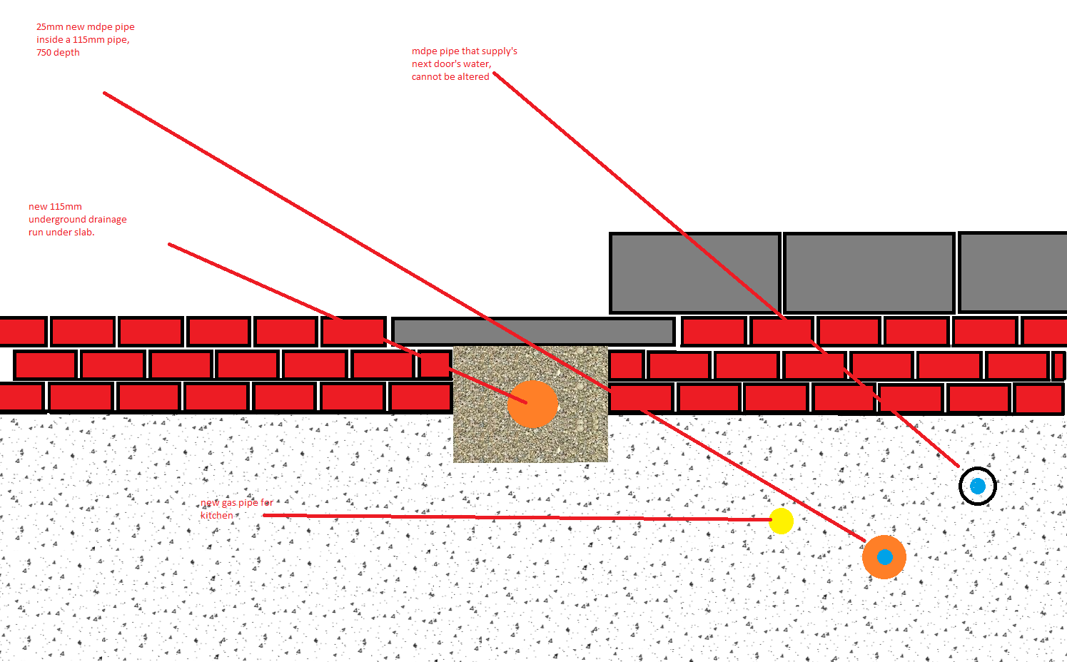

I need to pass the drainage through the footings, as per usual using a bridge/lintel method with 100mm clearance.
My question is i have a new water supply that i will be layed in 115mm drainage pipe and labeled water, but needs to be 750mm minimum. So do i go deeper and go under footings, id rather avoid this. Or is it ok to just have it poured and surrounded? After all its a duct. Gas also needs to be layed from the same entry side
The pipe has already been done and is currently out the ground. New boundary box has been installed. Footings shouldnt be more than a meter based on what iv already dug and exposed but will see.

Il post a little drawing so i know im on the right track.
here's a little picture i made!
there's an existing water supply that has to go through, it's inside ducting at somewhere near 500mm below ground level. this cant be changed as it runs across the back of our property to supply next door's water.
next to it, is my proposed new pipe inside a 115mm drainage pipe that will have a sweep bend back up into the inside of the extension, coming through the base, i will then pop a grommet in.
next to that is something id "like" to do. our gas is capped off and needs a new supply. ideally, id like a new pipe layed under the extension that will run back to the meter, this will avoid clipping pipes to external of walls, or having to pass gas pipes
in a cross battened cieling in the kitchen.
So, water can go straight through as it's already protected with ducting. and if i struggle with depth, i must dig lower to allow the concrete to completly "wrap" around the pipe, or if it ends up like the picture its fine anyway?
how do i stand with the gas? would this be something a gas bloke would want to avoid? i think the inspector will want the gas pipe lagged to protect it from the concrete, but not duct it in case it leaked into the property?
