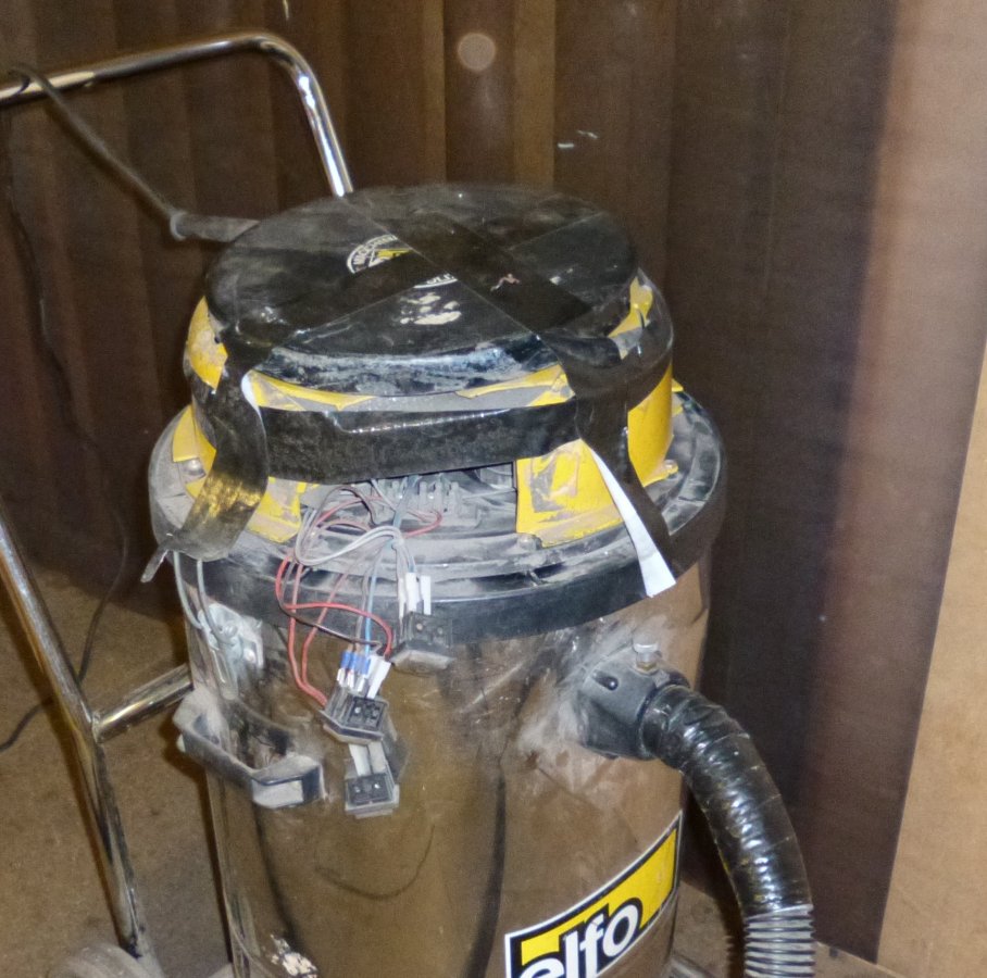

Well let's liven up this thread with some appliances that received a little red sticker.
