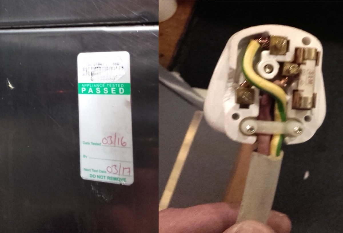

Found this yesterday on a Pat Test, but I can't decide if it fails or not? The Insulation resistance was still >20M to earth...
:mrgreen:
No I think it was rated at 13A (25m) - apparantly it was being used on a 2KW heater whilst wound up.
The fool that passed this 4.8KW(!) glass washer would have just slapped a pass sticker on that, though he wouldn't have bothered unwinding it...

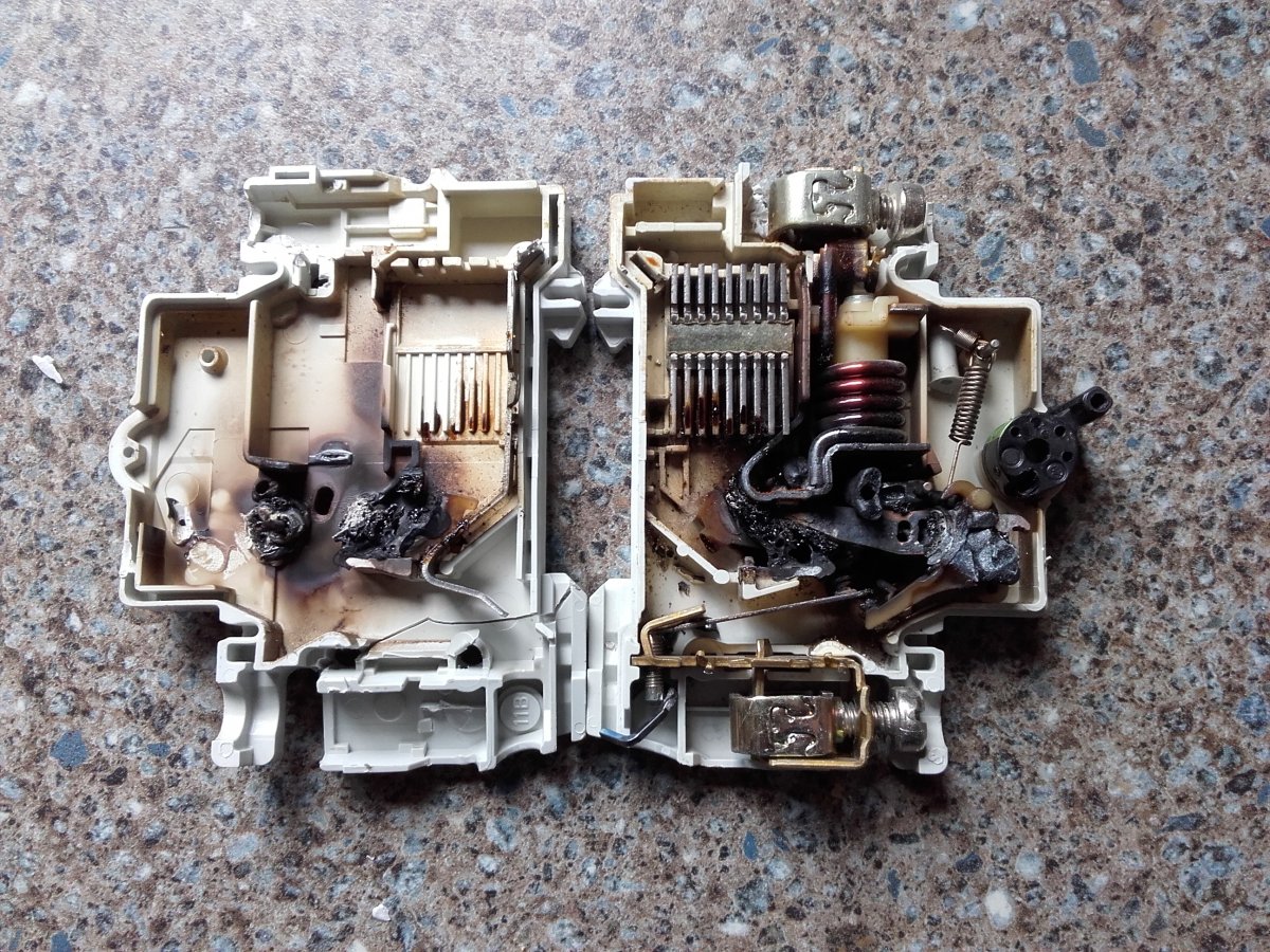

It was 'tested' by the same company who fitted those 2 poorly installed Wylex DBs I posted earlier. Yes that is 4.0mm² flex rammed into a broken 13A plug. The 20A MCB feeding the sockets ended up being continually overloaded which caused the MCB to jam, later heavier overloads then caused the MCB and DB to start melting. The MCB mechanism was totally jammed and even forcing the dolly to the off position didn't open the contacts. But don't worry, the same company passed that as well at the same time as the appliance testing.

What make was the circuit breaker out of interest?
The breaker was a GEC that was branded Steeple. I've just opened it for the photo and have seen the moving contact is now rotated 90° from the position it should be in! This 20A MCB had around 34A running through it when I was doing some checks. The heat was enough the melt the plastic on the front cover of the CU and the plastic had started to soften and shrink around the MCB.
Yes, "but it wasn't like that when we tested it" ……………
I had a large storeroom of cleaning quipment PAT tested recently, all passed and had test labels dated and signed off not one item had a plug fitted,
