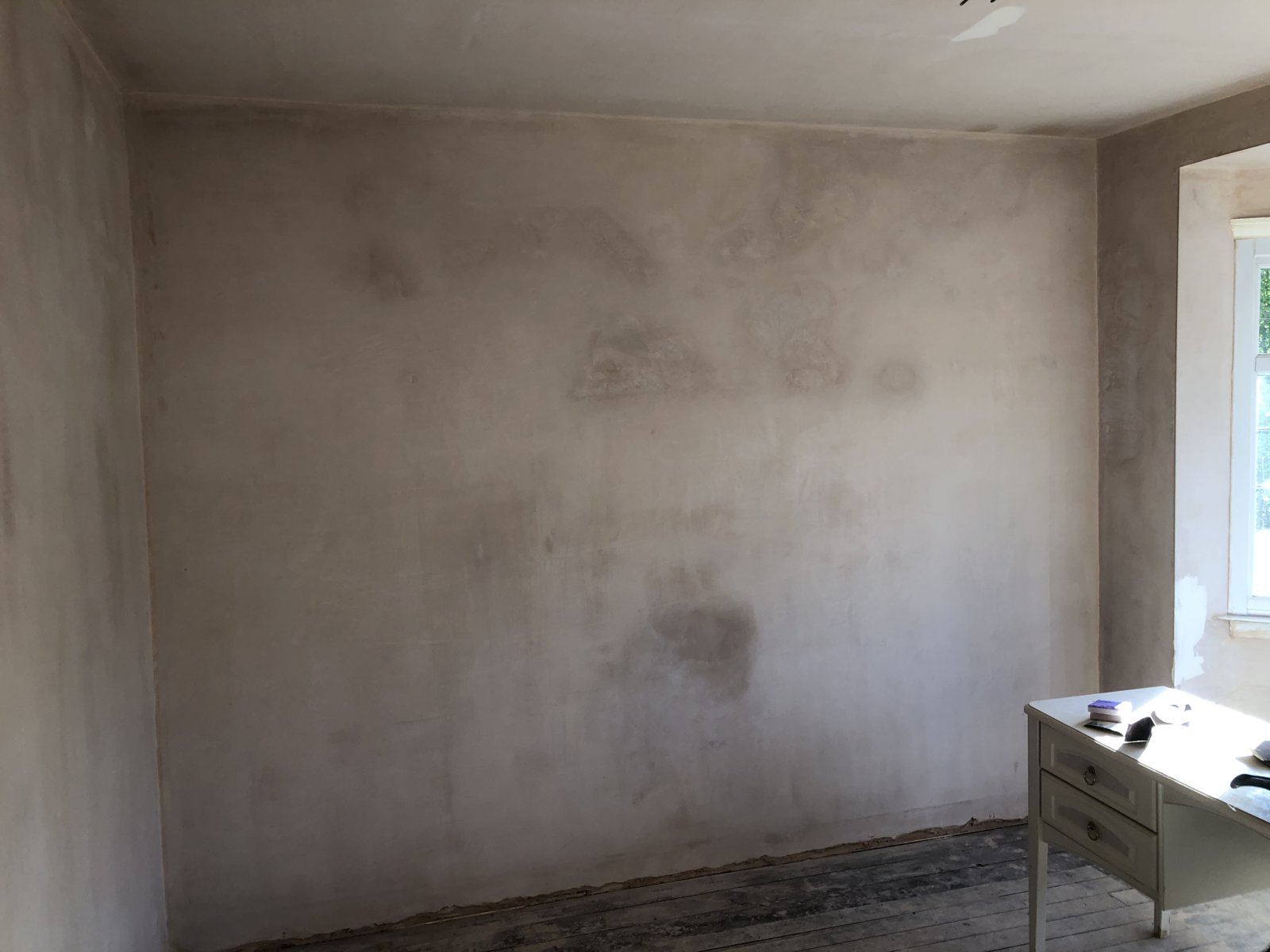

    Hi everyone,

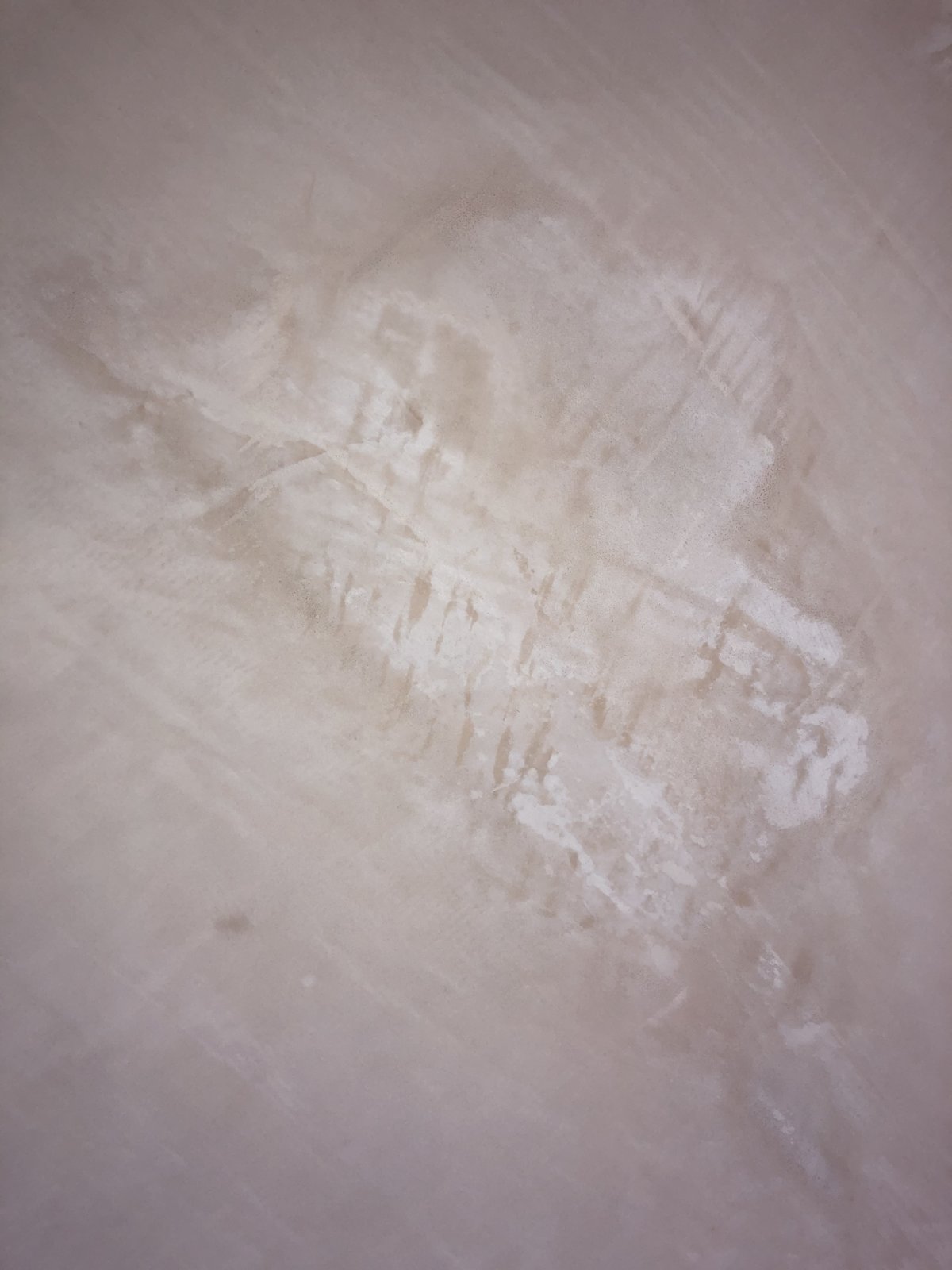

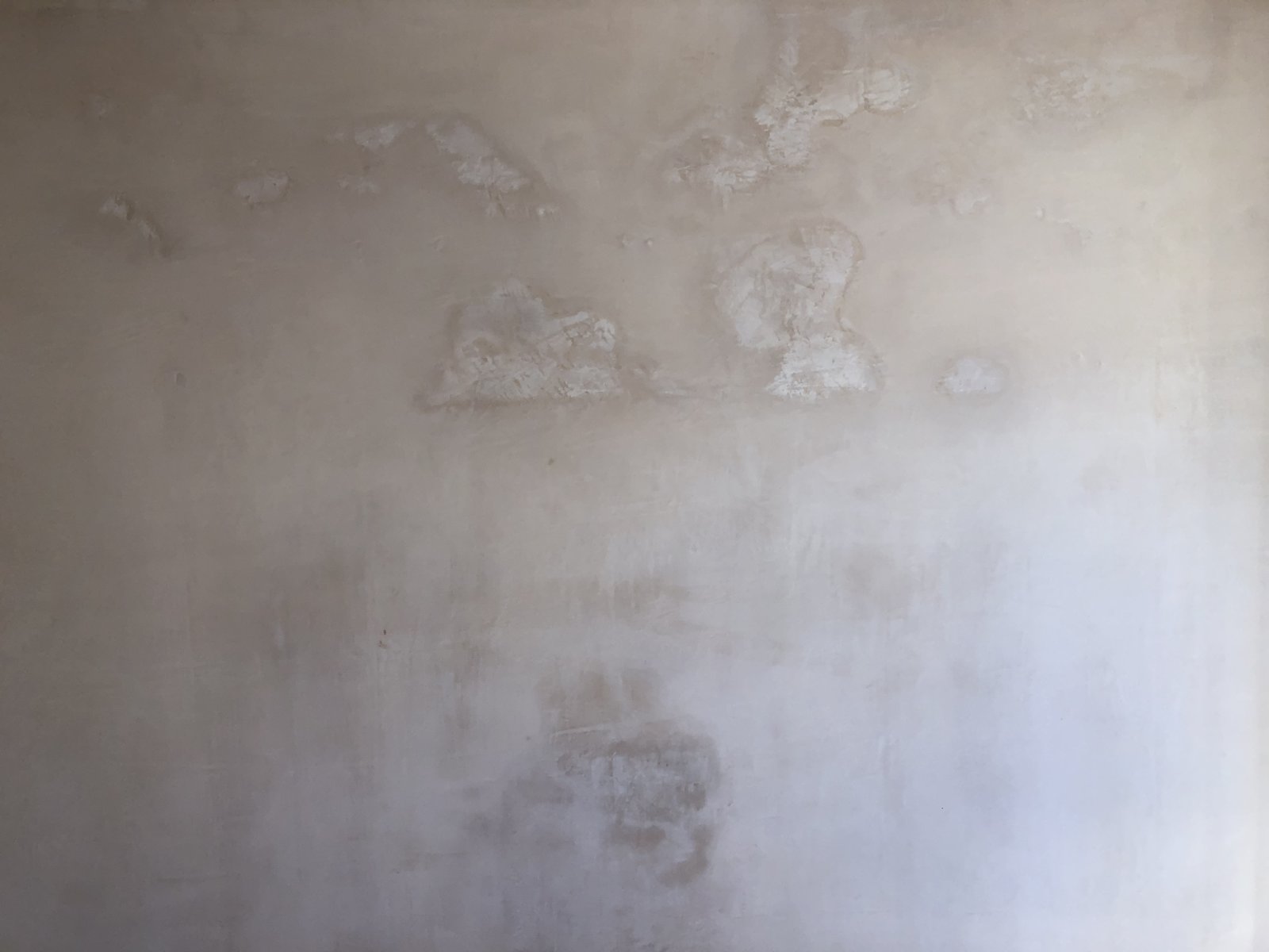

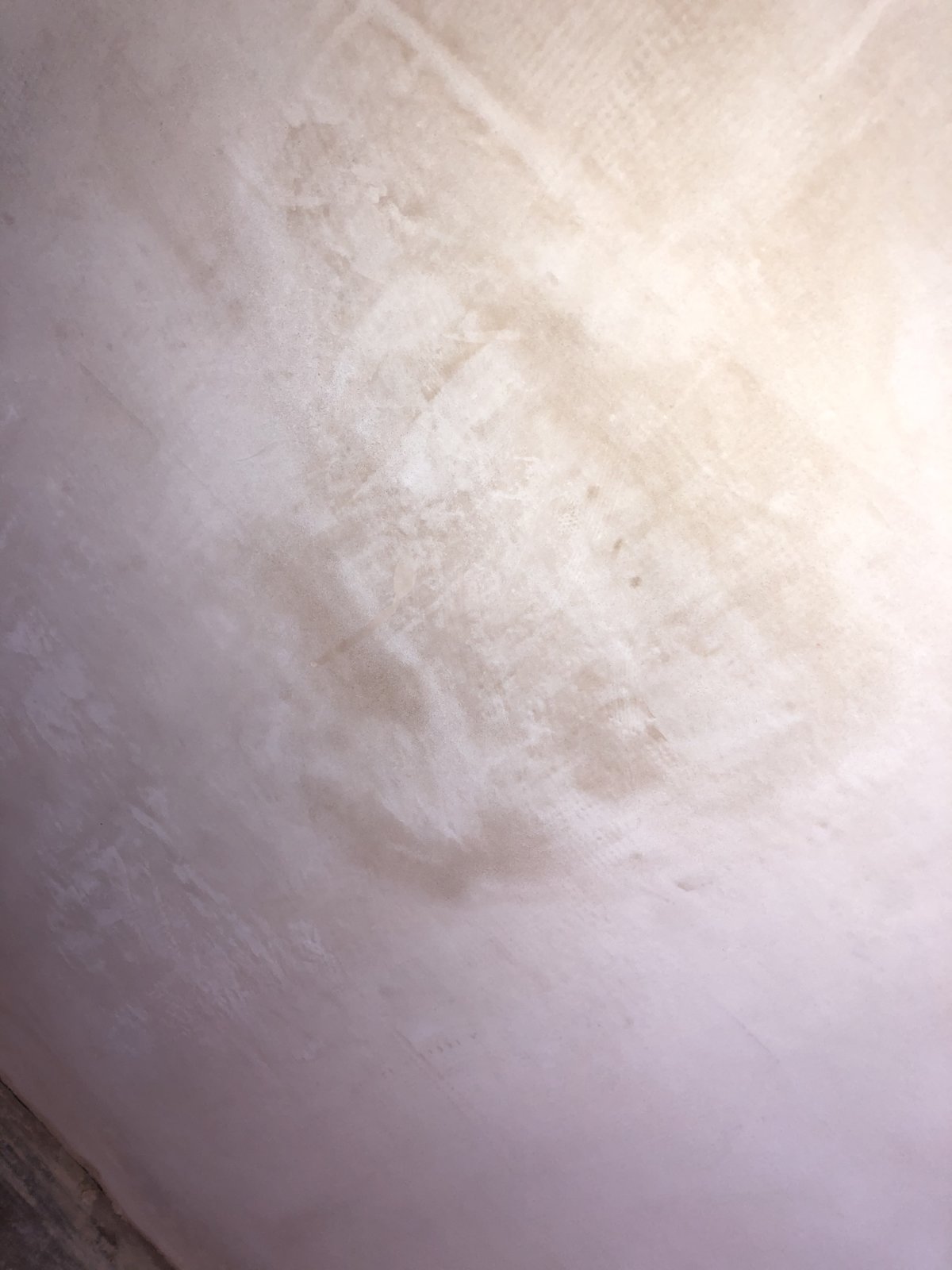

    I had my house skimmed a couple months back and have some marks coming through on one specific wall - detached house Built in approx 1935, top floor bedroom on exterior wall.
    before the new skim was done this wall was a tad weird with old plaster just coming off. In some parts it also looked dark, being new to all this I didn’t think anything of it and the plasterer didn’t mention anything either.
    I wanted to know if I should be worried so have attached a few pics.
    all help will be great!
    thanks in advance

    If you rub it is it like white powder? It might be salts coming out. I had something like that at mums built in 1913. I had to have the damp course done. It would also be worth having a look if its an outside wall to see if the water is running away or the damp course is not bridged. Mums had render bridging it. Someone else may have some other ideas....

  5. bennymultifinish
    bennymultifinish
    Joined:
    21 Apr 2020
    Messages:
    1,554
    Thanks Received:
    257
    Country:
    hygroscopic salts. look it up

  7. bennymultifinish
    bennymultifinish
    Joined:
    21 Apr 2020
    Messages:
    1,554
    Thanks Received:
    257
    Country:
    it’ll not go away. the only real solution is to get back to the brick/stone and re-render using a salt inhibitor. or dryline and plaster the wall. there are coatings available that claim to cure the problem .I can’t comment on how effective they are.

    no , sorry , you could leave it as it is and batten and board the wall over it. preferably leaving a potential for it to vent behind and breath.
    or
    take it back to brick and re render with salt inhibitor.

    knock off back to brick and re-render with a sand and lime render mix.
    dont use plasterboard or batten and board.
    batten and board, like D&D that has "venting", also provides a chute behind the boards for flame and esp smoke to shoot up to the next floor.
    why not post pics of the whole wall and the wall outside?

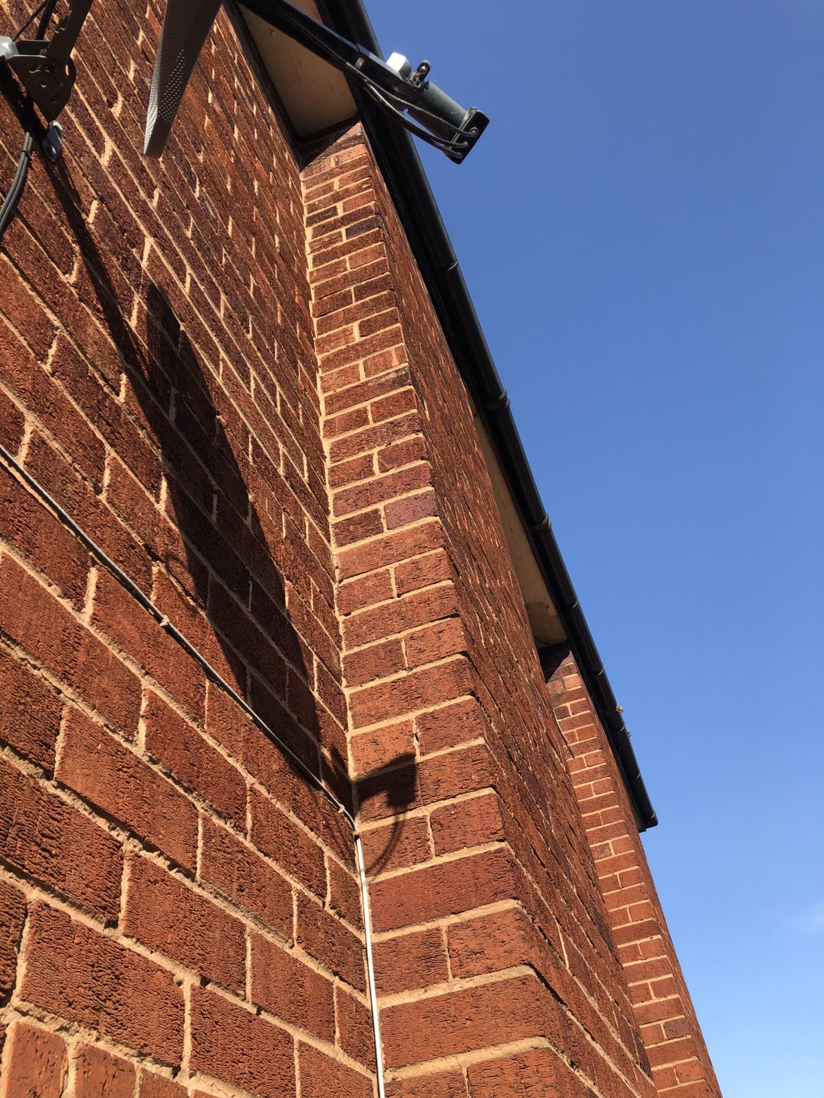

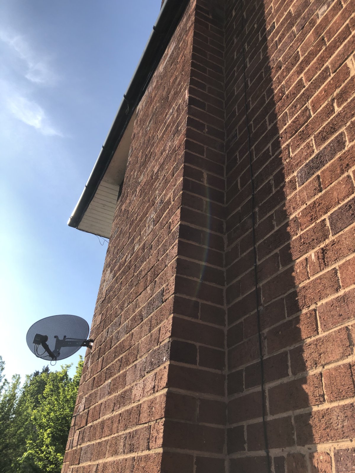

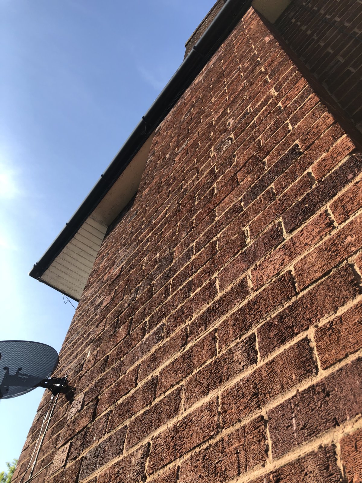

    Hi Bobasd please see more pics below,
    I’ve sanded it down a little too see if it makes a difference. The external image shows a chimney running along the wall, not sure if this is causing the problem.
    the fireplace is in the front room below the offending wall (offending wall in master bedroom)

    Was there ever a fireplace on that wall?

    judging by the floorboards , doesn’t look like theres ever been a hearth or fireplace there.

  17. JohnD
    JohnD
    Joined:
    15 Nov 2005
    Messages:
    65,261
    Thanks Received:
    3,498
    Location:
    Morecambe
    Country:
    Cook Islands
    are there any chimneypots? How many?
    How many fireplaces were there downstairs?
    It looks to me wide enough to have had two flues.
    Sometimes housebuilders will build things, such as a chimney, but make you pay more if you want extras, such as a fireplace, added.
    If there are flues that are not ventilated top and bottom, this will cause condensation inside. It is easily remedied by adding an airbrick near the top and bottom of each flue.
    Sometimes homeowners close off airbricks.
    You may need to get up high to see if there is good lead flashing preventing rain off the roof running onto the brickwork.
    Look at neighbouring houses built in similar style
