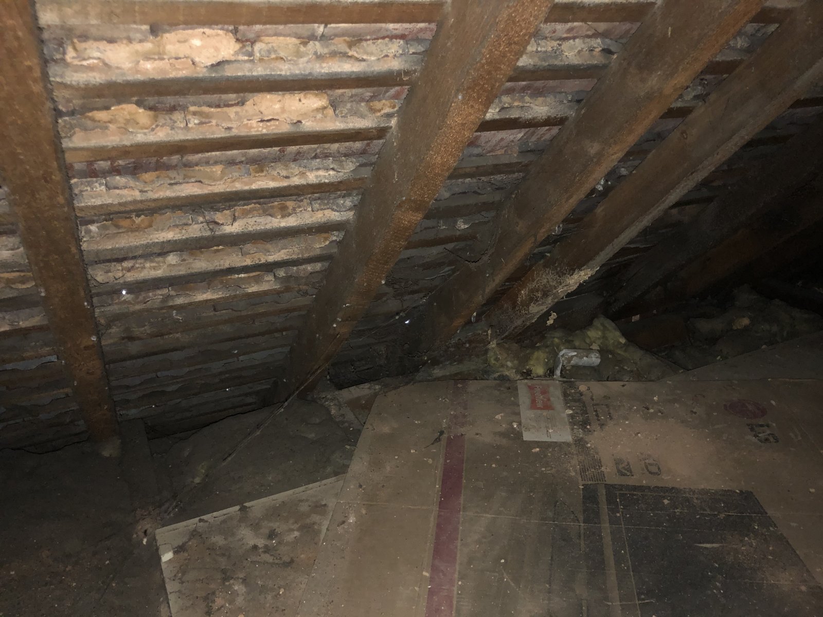

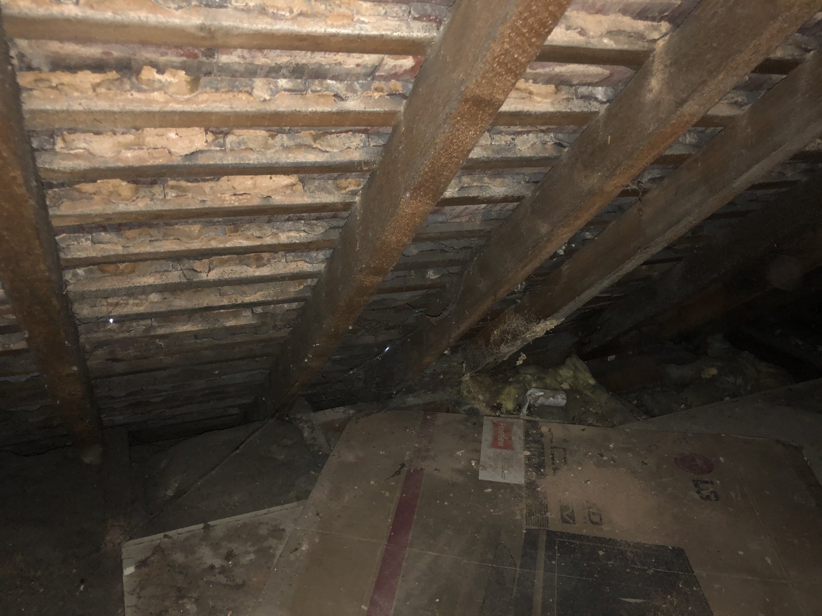

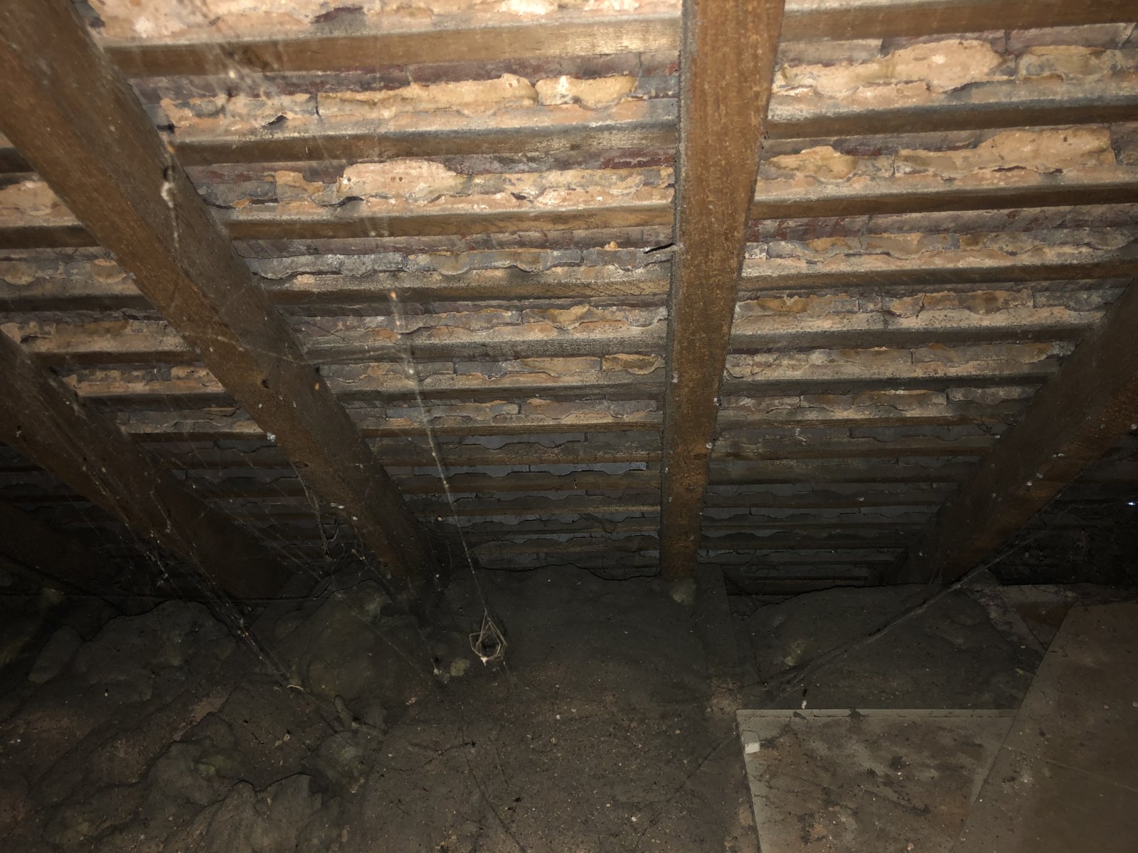

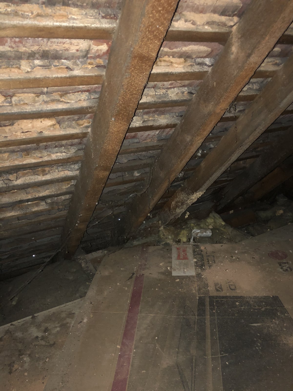

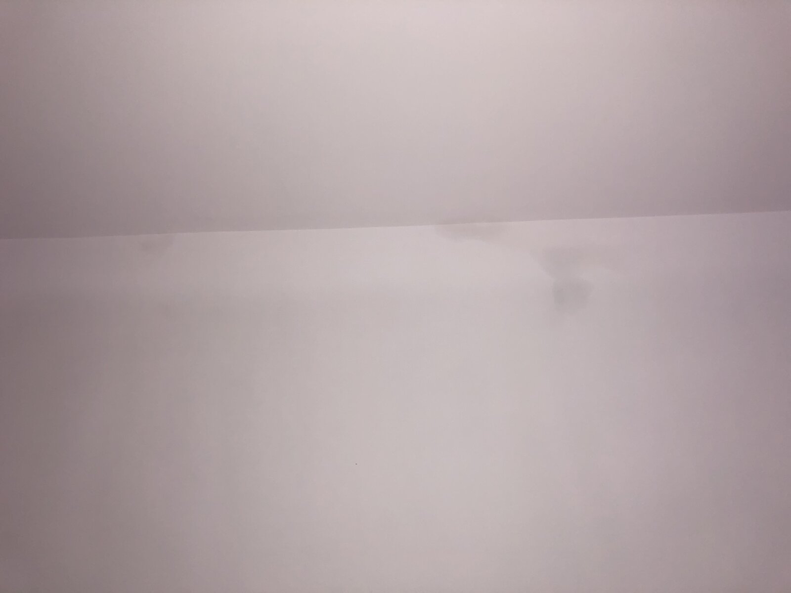

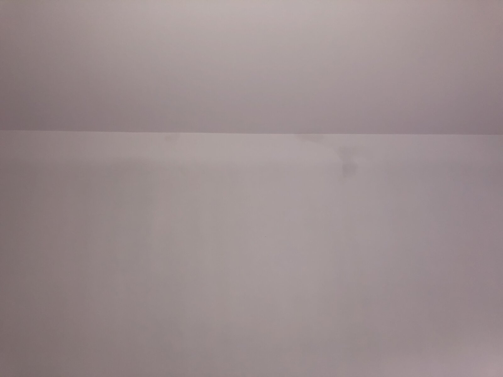

ask them to take some pics on your phone. Including the gutter as the wet patch is bigger than I'd expect.
Sometimes disused chimneys are capped off with a paving stone or similar, it avoids the need for future flaunching, as there is no pot, but you need to add an airbrick into each flue.
If the brickwork is in poor condition, I'd have the stacks reduced in height. But I am not a roofer.
