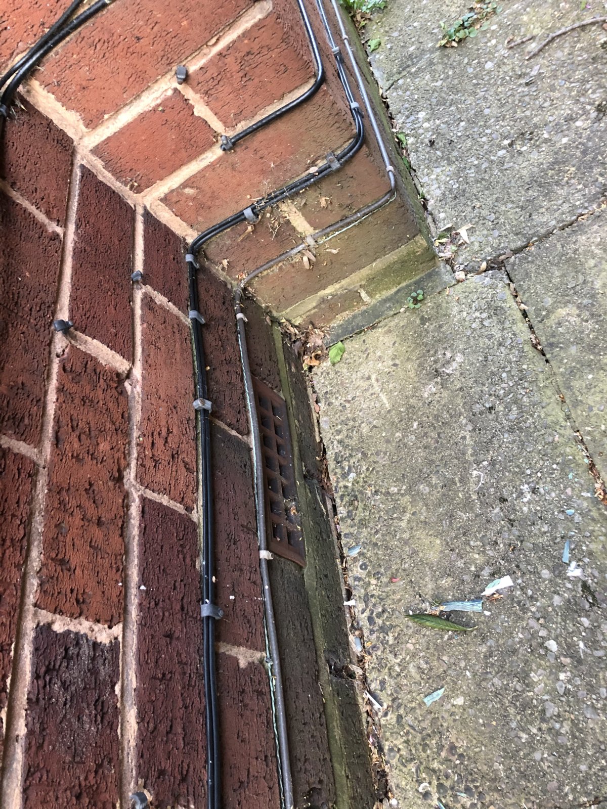

I’ve had a look and can see air bricks on the house near the chimney but none on the chimney itself.

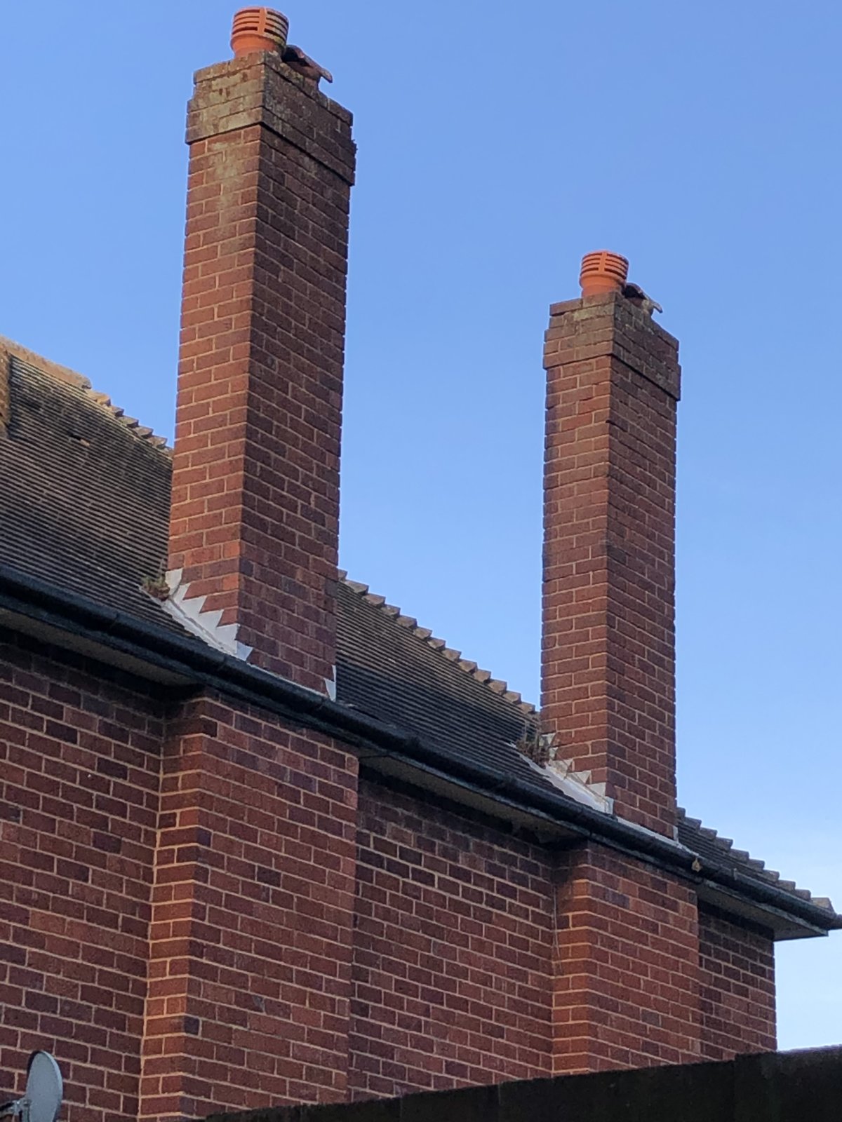

see pics below (The first chimney is on the offending room). Above that is loft space

ok so judging by the height of those there will certainly have been fireplaces upstairs when the place was built , so as stated previously there should be an air brick or vent present in the wall.
given the spread of dark / damp areas though it probably wont cure the whole problem and certainly wont stop salt situation.
The chimney pots will ventilate the flues at the top; there should be ventilation at the bottom as well, to give airflow. An open fireplace will do it, or (usually) an airbrick is let in when a disused fireplace is bricked up. In some cases, a chimney that has been dug out can be ventilated out of the void under the floor.
As noted above, water may be getting in from bad flashing or other defects, and rain falling down. Lack of ventilation will prevent them drying out quickly. Soot and salts in a chimney can be hydroscopic and harbour damp. IME damp in a formerly used flue shows itself by brown stains on the plaster, from the tar and soot. Flue that have never been used are less trouble, but can still be damp. The damp on your wall does seem very widespread, I wonder if there is a guttering problem.
If you never expect to use your fireplaces again, you might consider having the chimneystacks taken down or reduced, and the roof/gutter/flashing tidied up.
A experienced local roofer, by personal recommendation, could take a look and notice common defects.
update
looking again at your photos, I see a build up of rubbish, moss (and perhaps grassy weeds) where the chimneys meet the roof, this will harbour damp and may bridge the flashing.
A sign of long-term neglect.
There are also a couple of slipped tiles that your roofer can replace.
