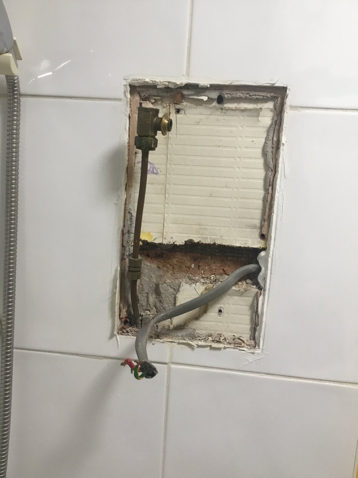

I am replacing an electric shower. The old one was tiled-up-to, rather than mounted on the tiles - maybe it was older than the tiles? So now I have this hole in the tiles:
I feel that I should fill that in to get a flush surface, and mount the new shower (which is probably slightly larger in one dimension or the other) on top.
No I don’t have any spare tiles. Yes I’ve looked under the bath.
The space is about 14mm deep in the top half and deeper below where it has been chased out. I am considering filling up most of the space with a chunk of 9mm plasterboard and then finishing with either polyfilla, tile adhesive / grout, or similar. What would you advise to get a waterproof and not unattractive surface? Preferably not something that I have to buy a huge bag or sheet of!

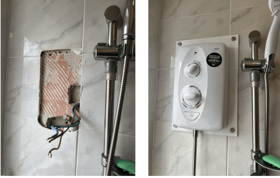

Yes, that’s an option but I am hoping for something a bit more discrete.
Your main problem with 'discrete' is your lack of matching tiles. IMO for the best of a bad job is as @pete01 suggested and deploy a panel of some description to cover the hole; either that or retile the complete wall.
Although I don’t know for sure yet as I haven’t chosen the new shower - see my other thread in Plumbing - I think there will not be much of a gap on show. Possibly none on three sides and a couple of cm underneath, if I’m lucky. So a strip of e.g. white filler on just one side would be, I think, more discrete than a panel.
Any thoughts about what is required to make it sufficiently waterproof?
Both ‘Pete’ and ‘Scally’ above are bang on with what they say. ( personal I would go for a ‘Pete Panel’) :)
Just to throw another ‘ option into the ring’, if tiling the whole wall is a non starter, then how about just replacing those 4 tiles ?
They’re a common easy to get hold of white ceramic, and as those have all been cut they should be relatively easy to get off !
