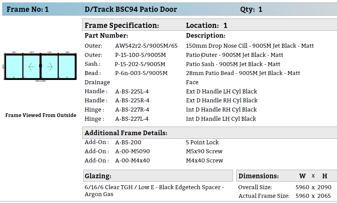

Hi All,
Need expert advice.
I would like to go ahead with the Patio Sliding door.
The door's overall size is 5960 (W) X 2090 (H) and going with 4 panels, 2 fixed (right & left) two can slide (left one and right one), See the attached image please.
I am not knowledgeable about windows and stuff. I got a quote from one of the windows companies and they included the below details, not sure thickness glazing etc are standard.
Can someone tell me is this specification okay to buy? Or can I ask some more questions?
Frame Specification:
Outer: AW542r2-5/9005M/65 150mm Drop Nose Cill - 9005M Jet Black - Matt
Outer: P-15-100-5/9005M Patio Outer - 9005M Jet Black - Matt
Sash : P-15-202-5/9005M Patio Sash - 9005M Jet Black - Matt
Bead : P-6n-003-5/9005M 28mm Patio Bead - 9005M Jet Black - Matt
Drainage Face
Handle : A-BS-225L-4 Ext D Handle LH Cyl Black
Handle : A-BS-225R-4 Ext D Handle RH Cyl Black
Hinge : A-BS-227R-4 Int D Handle RH Cyl Black
Hinge : A-BS-227L-4 Int D Handle LH Cyl Black
Additional Frame Details:
Add-On : A-BS-200 5 Point Lock
Add-On : A-00-M5090 M5x90 Screw
Add-On : A-00-M4x40 M4x40 Screw
Glazing:
6/16/6 Clear TGH / Low E - Black Edgetech Spacer -
Argon Gas
Overall Size: 5960 x 2090
Actual Frame Size: 5960 x 2065

Not a lot of spec there to be honest ... 150mm cill , 28mm units , consisting of 6mm Tgh Glass and 16mm Spacer , which would be right for the size of the glass units , warm edge spacer ( edgetech) , argon and Low e glass all correct for modern glazing. Onl other thing is the frame is Black, along with the D handles

Low e glazing will be fine, it includes argon gas. Only thing I think you could ask as an extra is if there is a thermal break within the frame , to stop heat transference through the Ali
Pvc won't go that big, thats an ALi frame , hence the RAL colour code too
