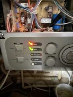

I think the pump is working okay! On the main circuit board there are 4 plastic square sparks as it cuts out

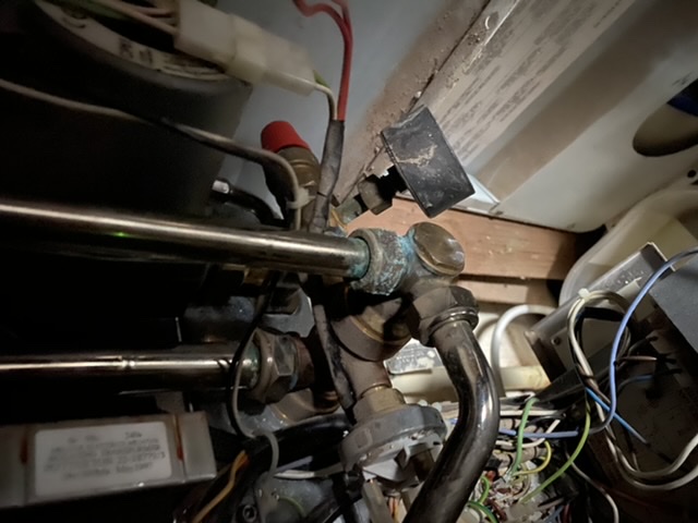

I have two chrome pipes connected to the front of my diverter valve

Okay mate. That’s for all your time in trying to help? Did you see the photo of my diverter valve?
yep no surprises there just drain the boiler undo the two chrome pipes remove the Capsual housing and the capsual is in there
