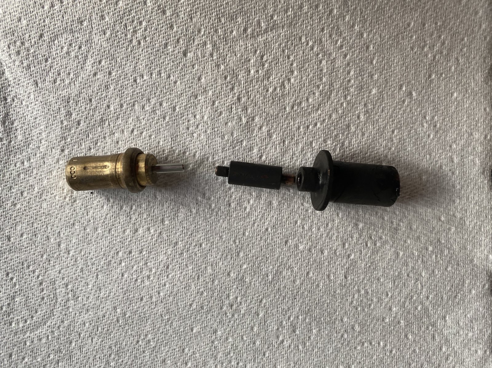

is that the existing capsual or the new one ?
That’s both one in the left the new one the one on the right is the old. Totally different fitments
You're confused...the left hand part is the wax element the right hand parts are just the spacers.
The wax element is in the front section that you're already removed...the part with the 2 1/2" threads on it.
It appears so if that’s the case! But the new part doesn’t look like any of them!
remember the new part is on the left of the photo! The black parts are what I’ve removed?

That is the correct wax capsule for your boiler, the parts you removed are not the capsule
