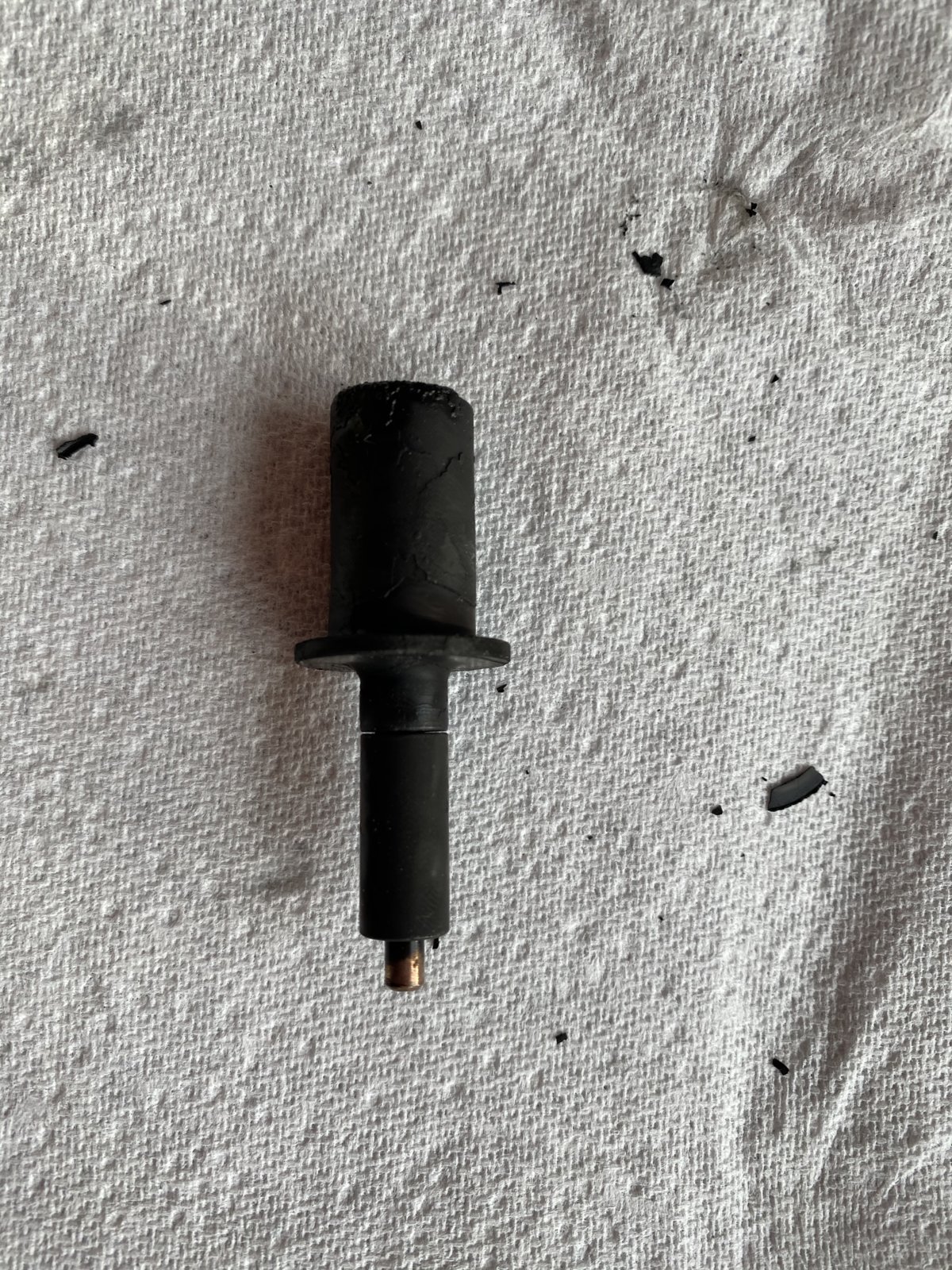

if my memory serves me correctly. The fat part is the part that I fitted to wax capsule. I also noticed that the small narrow pin didn’t sit directly in the middle of the diverter valve it was offset. I thought this was how it should of been.
I uploaded a photo of how I didn’t fit it. The big end might of been the other way round

tbh I’m not entirely sure how this capsule works. I know it pushes something when it gets hot. But why does it have washers and I rings. And the inclosure it fits in has two holes in it. Which I’m sure I have a drip from the one side. Why even have holes there. Unless it’s to help get the capsule out?

It would seem the wax capsule you have fitted is not shutting down the heating port hence the hot water is sub temperature

The problem with replacing the wax element is that you're relying on the 4 old O rings being servicable...and invariably they are worn and square section.
I've always bought new valves (often from ebay) and if you can remove the grub screws just replace the front section.
Anyway this is how is should be assembled...clean all O ring mating surfaces and grooves so they're spotless then grease all the O rings and grooves etc with silicon grease.
Fully assembled wax element..
Small pin in spacer bar must locate in rear section hole...
And now both parts fitted with "rim" of top hat section at the back to allow port to be sealed when wax element expands...
In hot water mode cold domestic water continually flows across the wax element via the 2 pipe connections on the front diverter section.
This keeps the wax element cold and therefore it's pin does not extend.
The boiler pump circulates primary water around the boiler heat exchanger (and through the diverter) helping to transfer heat energy to the domestic water pipe circuit inside.
In heating mode the boiler fires up and again the pump circulates primary water around the heat exchanger and through the diverter.
This time though the front section of the diverter containing the wax element gradually heats up through conduction from the rear section (containing heated primary water).
The wax in the element expands pushing the pin out and this forces the top hat section, spacer pin and rear section back towards the wall opening up the radiator circuit.
Inside the top hat section you'll also find another spring loaded mechanism to take up excessive pin movement and protecting the wax element from excessive pressure.
