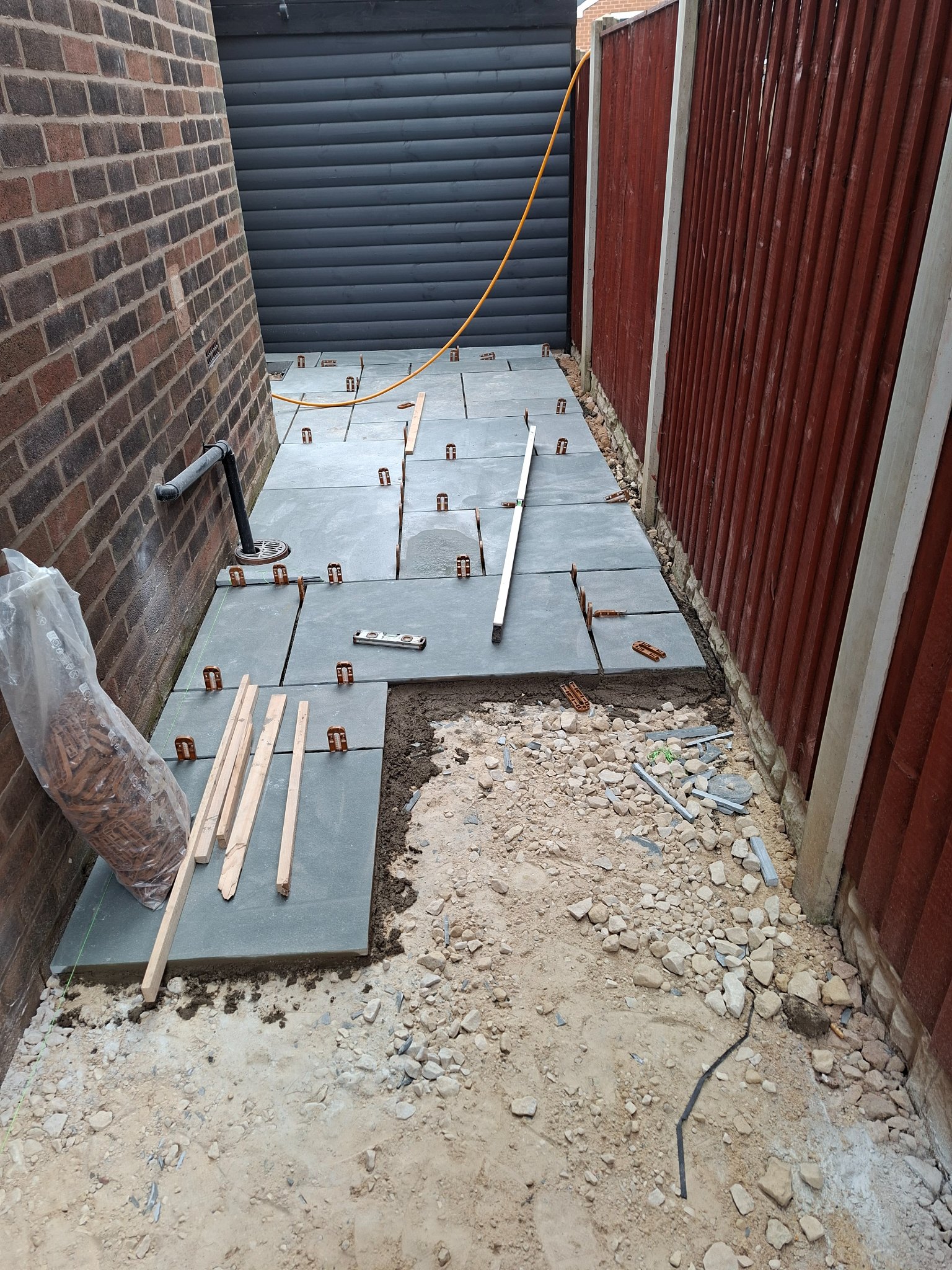

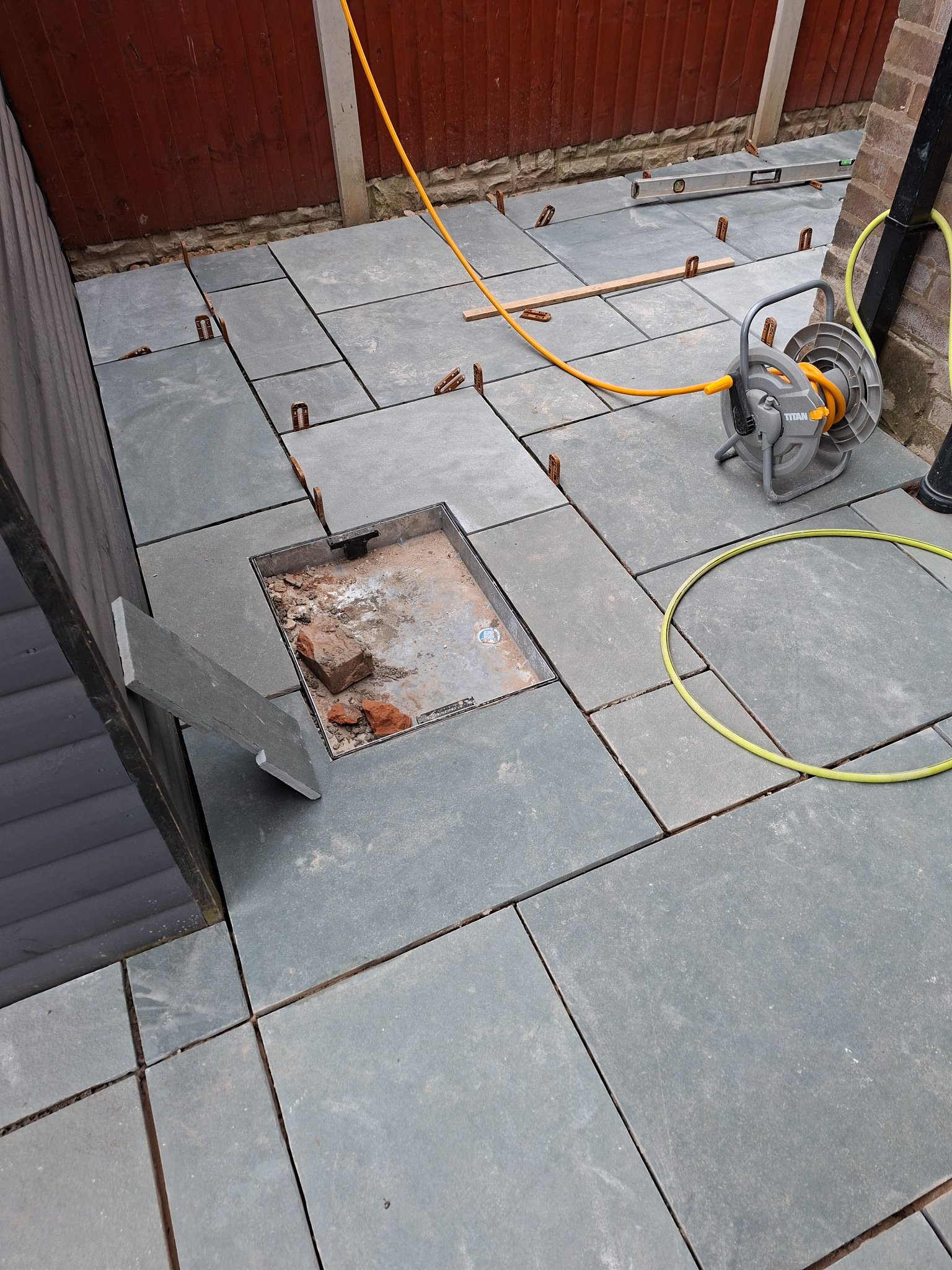

I've laid a path down the side of the house using sandstone. I laid them on a full MOT1 bed between 50-100mm, vibrated down and a full sharp sand 4:1 mortar bed varying from 20-30mm. Everything feels very solid. All the joints are 10mm and i used a slurry of SBR and cement on the back of every slab.
The stones are "Kota blue". See pictures. I'm really pleased with how it's turned out. But it's now time to think about grout and sealing. I've laid everything now, the pictures are a week or two old. I'm going to do a long cut along the fence (it's not quite parallel with the house) and make a 6 inch border in gravel, glued down.
Clearly all the websites are pushing expensive resin based liquid and brush in grouts. I've read various reviews about these products and not sure i can justify the price tags.
Is there anything wrong with using a mortar and pigment to grout these slabs after I've used a sealer on them? Any recommended sealers? Recommended colours for these slabs? I know sandstone can stain easily but if i seal them first and wipe any mortar off with a sponge surely that will eliminate any staining.
Or should i just plump for the expensive liquid or brush in stuff? Is it worth it? I reckon I'll need two pots of it.
