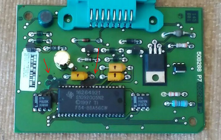

Does anyone know what has caused these dark markings on this PCB?
It is from my van and is the security (anti-theft) system which more and more frequently caused it not to start.
There was dust/rust/sparkly bits - something like that - on the parts in the dark areas. I brushed them off with a tooth brush and have had no trouble starting since.
There is no sign of water ingress on the module or nearby nor any markings on the other side.
