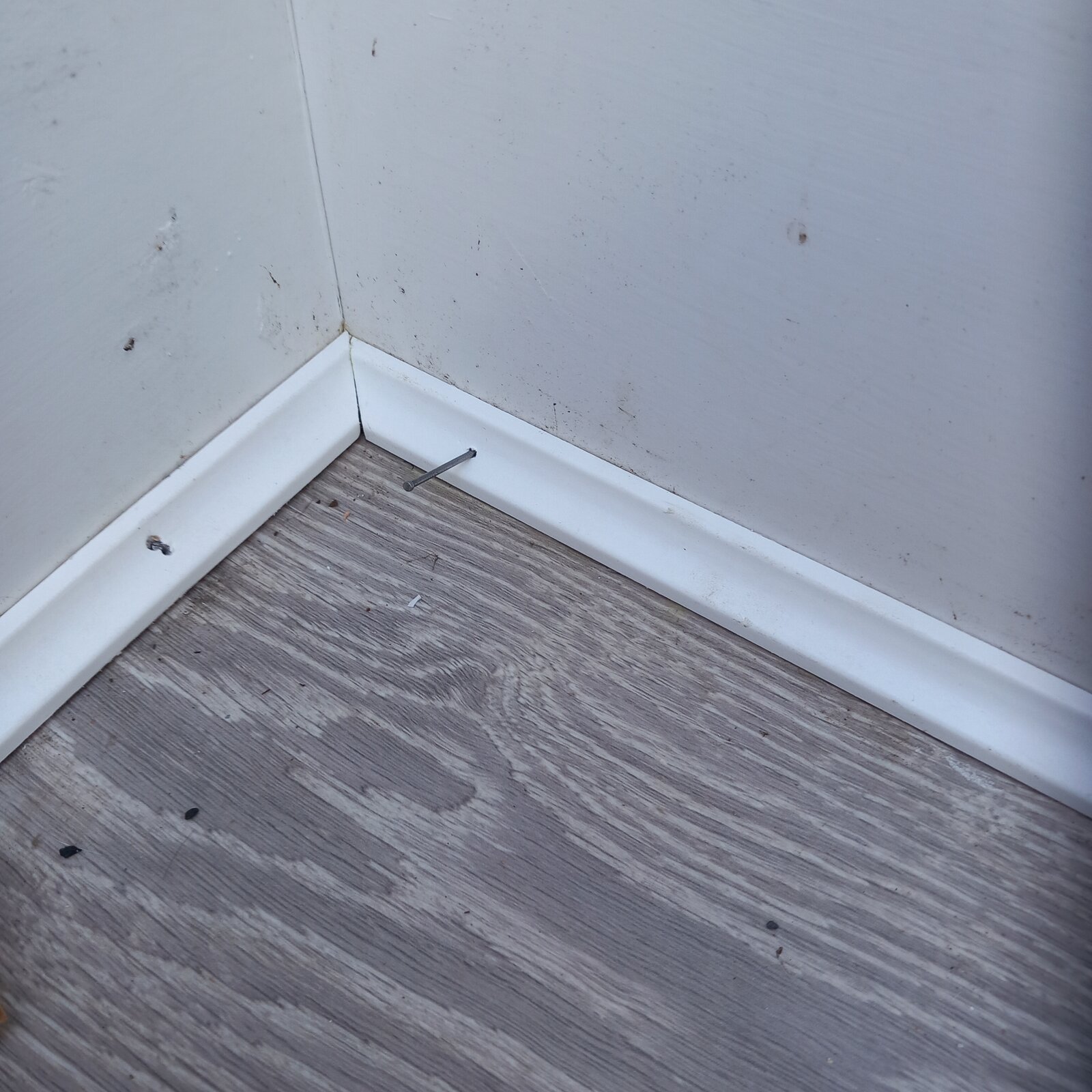

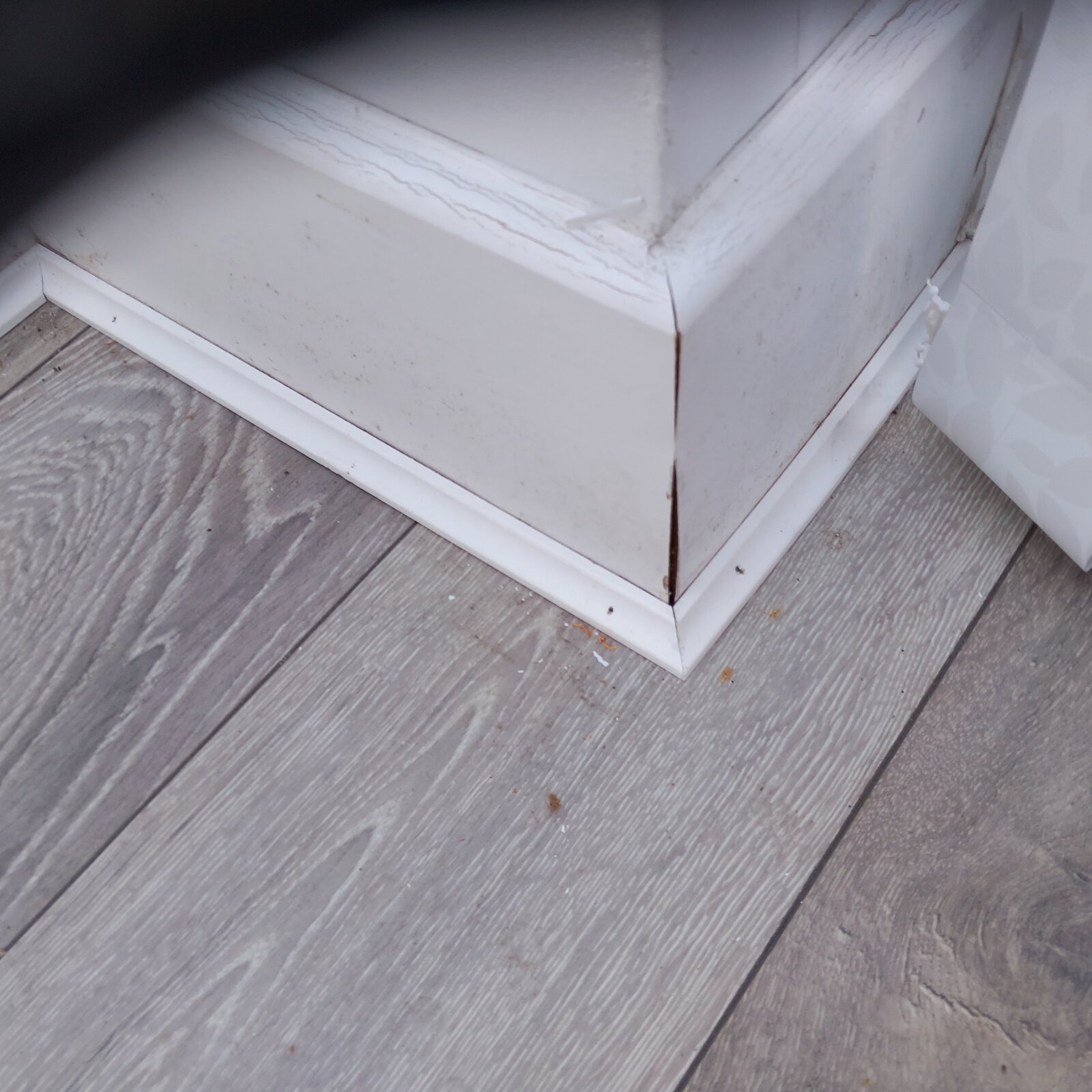

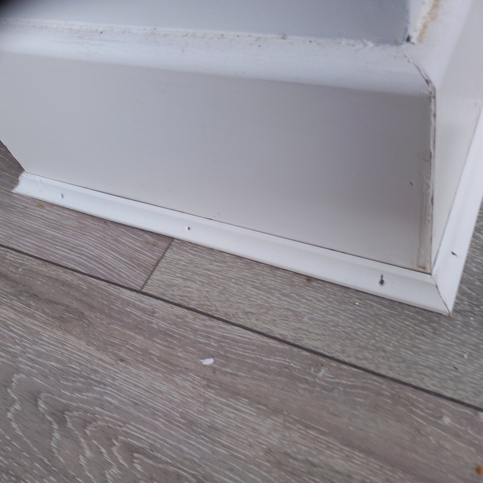

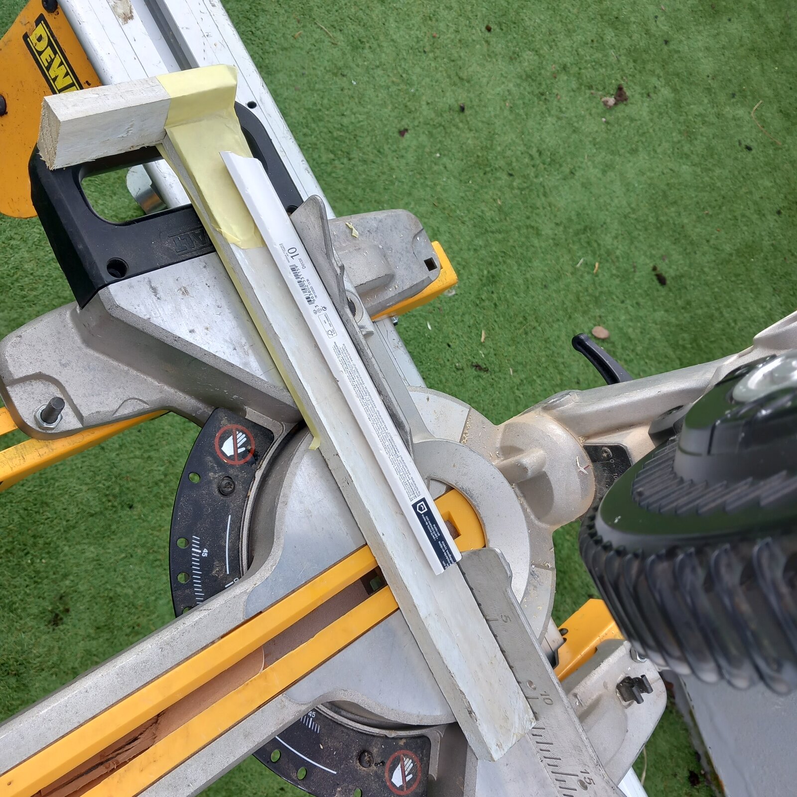

Had mitre saw calibrated but one side of architrave still not great and external corner of skirting wasn't perfect used two 30mm lost heads on them. Caulked it up
So basically you couldn't be arrised to learn how to do it youself, and despite it not being right you went ahead and did the job, generating sub-standard mitres which you couldn't even be arrised to correct with a block plane, or glue together with Mitre Mate or the like. Your mitres are an utter disgrace considering they are paid work - and you should know that only a cowboy tradesman caulks mitres. Shame on you!

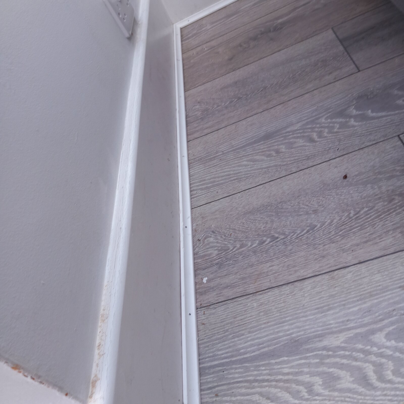

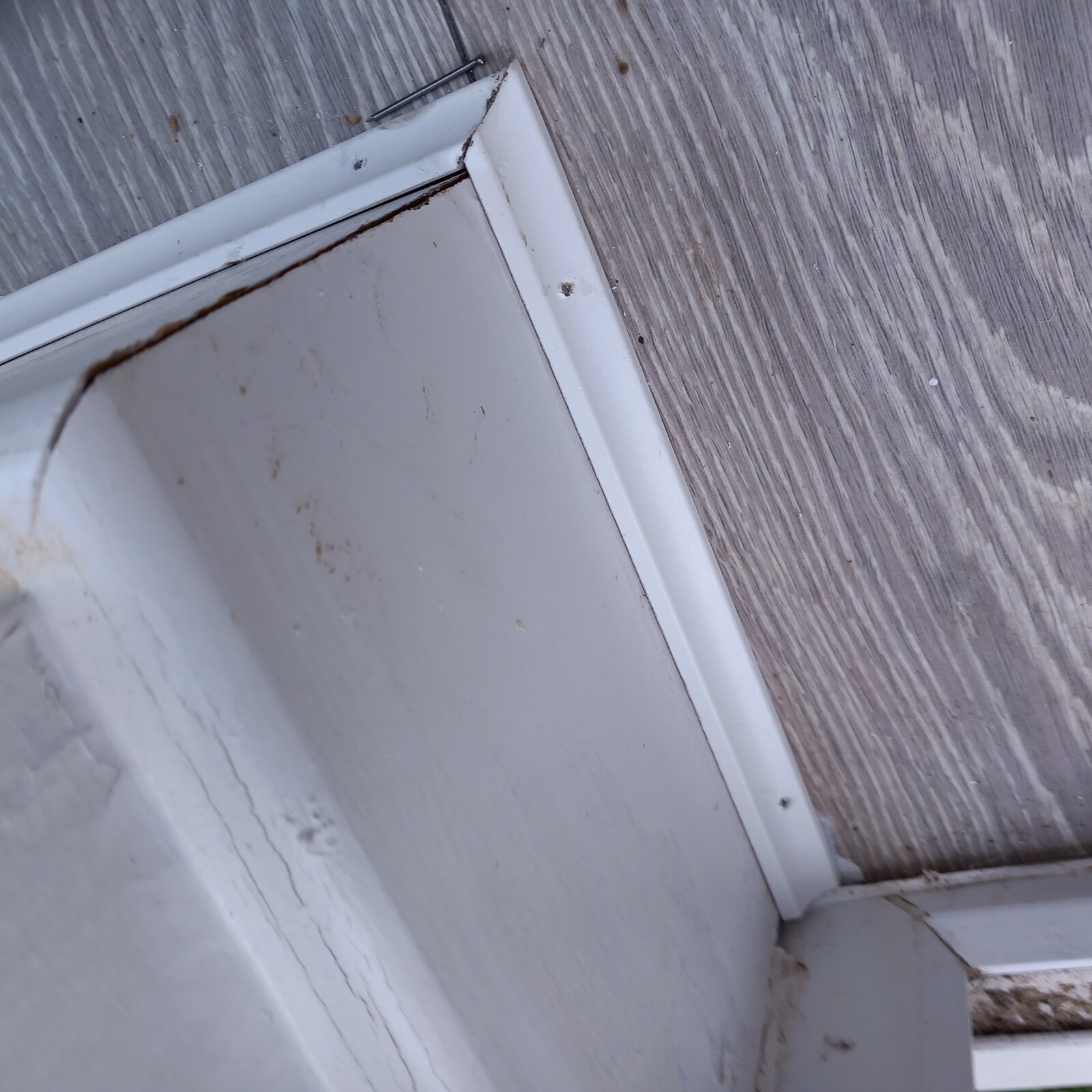

You say that you've already installed Pendock - so you should know what you are doing with it. You should also know, as a tradesman, that you never install anything by fixing it to laminate flooring. So you need to either trim back the laminate (which I happen to think is inadvisable, or you need to fix the Pendock back to the wall so that it doesn't depend on being fixed to the laminate, or you need to find anothet solution.

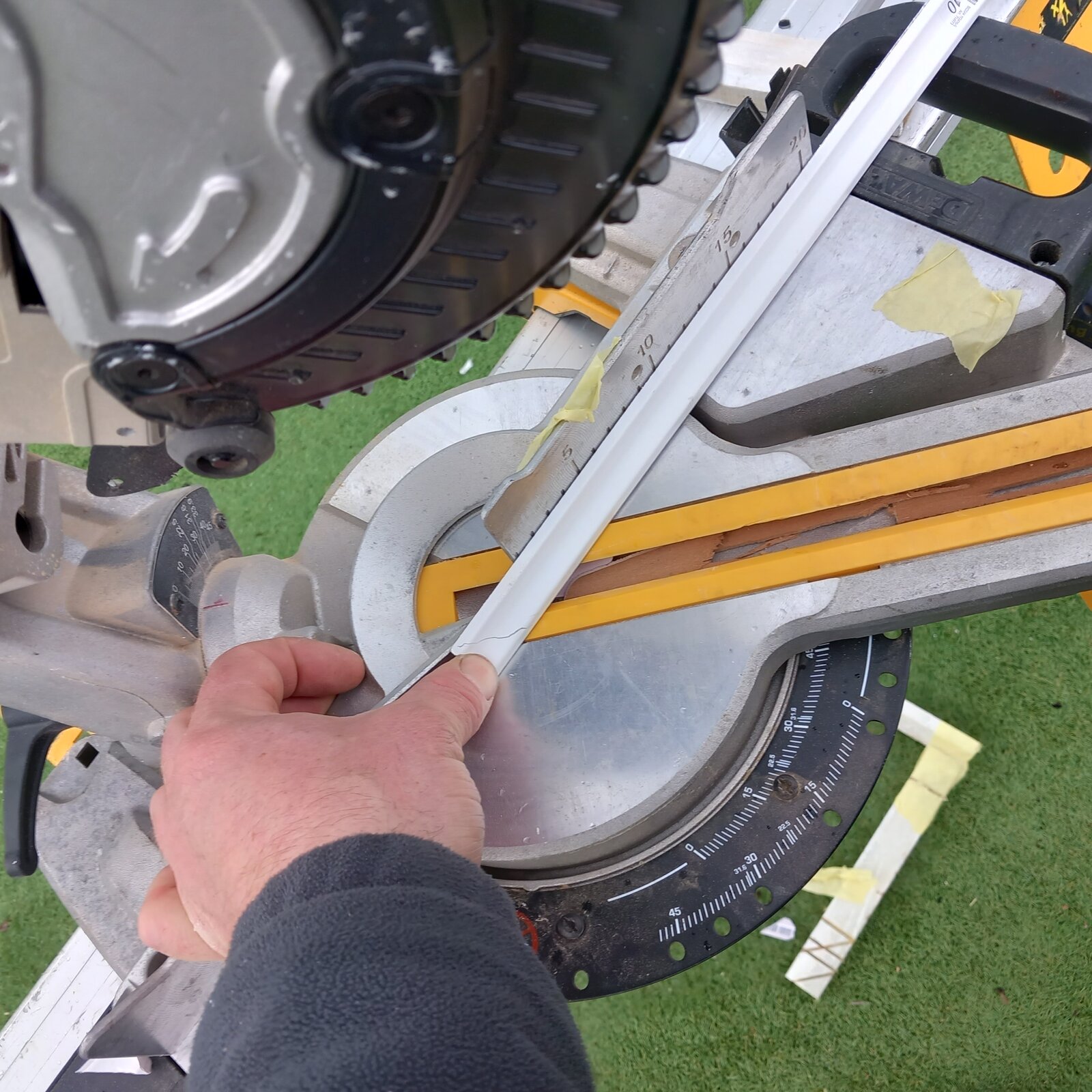

As to beading, you can cut even the smallest beading with a mitre saw providing you use a fine enough saw blade - and if spelching is a problem then just make up an auxilliary base and backing fence (which are an L-profile) to deal with that. Alternatively, consider the old school approach of a mitre block and a fine tooth hand beading saw. 16 gauge nailers can be too large to fix very small beadings (you risk splitting it), so you may need to consider smaller gauge pins (18 gauge or even 23 gauge) or find another fixing method

Did beading job. Tried cutting with wooden auxilliary base but ended up just cutting normally. Mitres were good, used mitre mate, I worked out that the beading needs positioning on chopsaw before cutting the same way that it'll rest on wall. Used 30mm nails but changed to 25mm panel pins. Main problem is the hole left in beading after hammering it in
