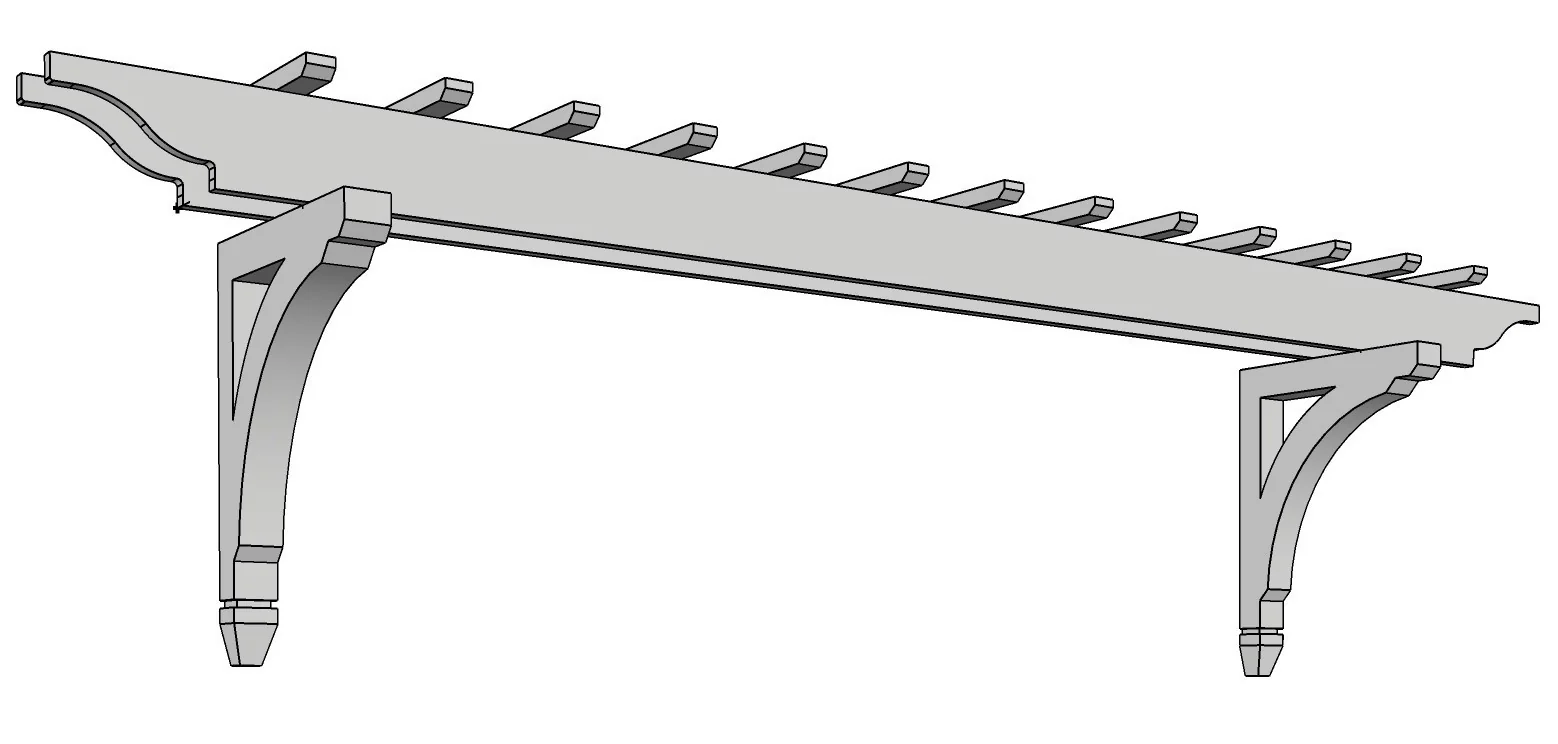

Thanks for the replies.
I'm looking at sourcing materials from UK Timer, who do pre-cut Dried/Sawn British Larch/Douglas Fir Boards, max thickness is 38mm (which is 32mm if PAR - I'm not sure what 'look' to go for yet), but up to 200mm depth. I do like the idea of matching the beam depth to the post thickness.
For the front beam, I am umming an aaahing about doubling up, like this (albeit not that corner support style):
I can then use the same boards in a smaller depth for the rafters. They also do BL/DF posts in both C16/C24 grades and rough sawn/PAR so it all would have the same look.
As a side point - the posts will be bolted to the deck frame (which is likely going to be 6x2 C24) since the fixings will be hidden by the deck. For the pergola joinery I was hoping to use through dowels to avoid visible fixings - is this a good or bad idea for an exterior structure?
The posts will be notched (for both decking frame and pergola beams) so there'll be additional glue surface for the pergola beams.
Thanks again.
