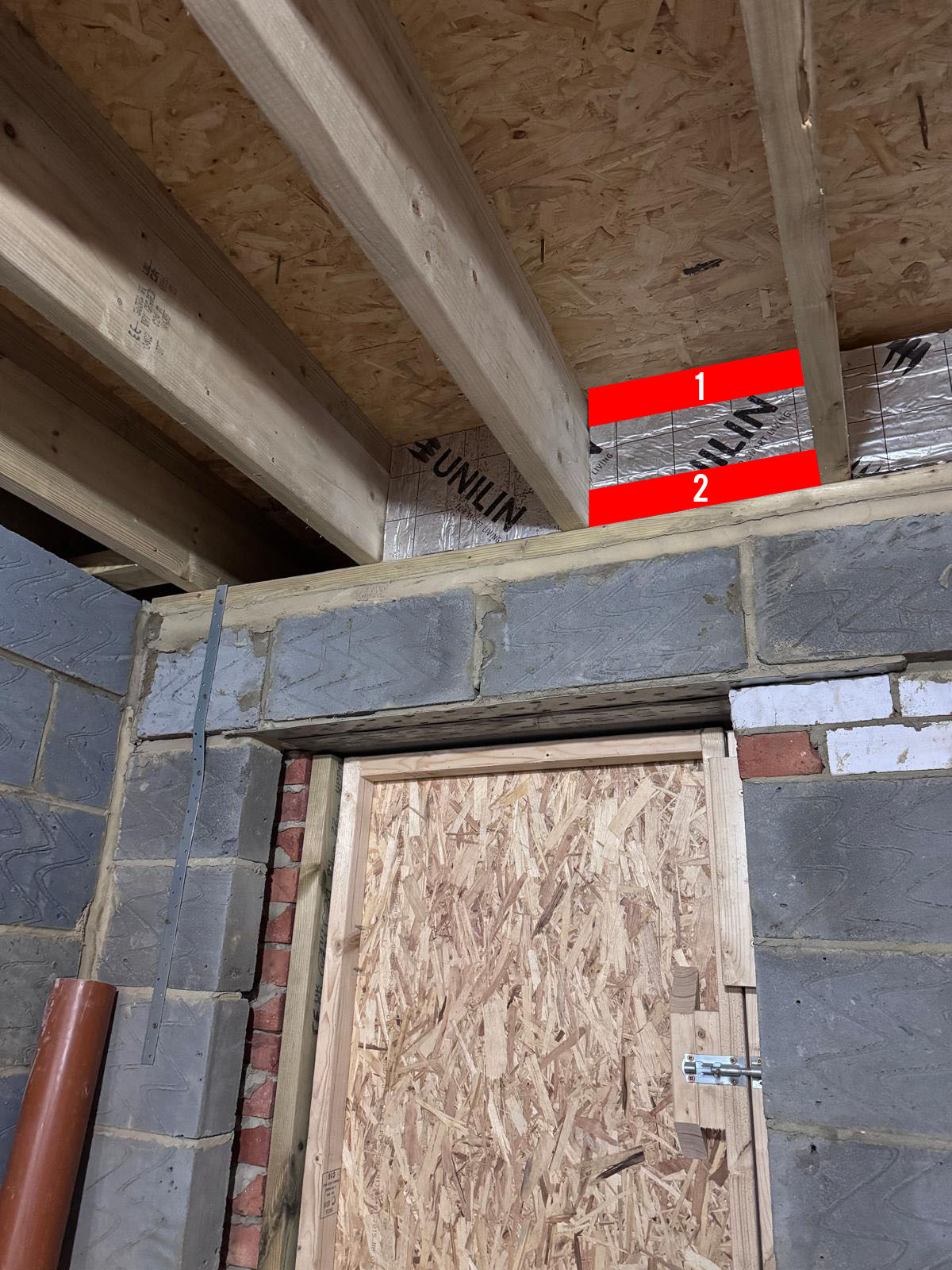

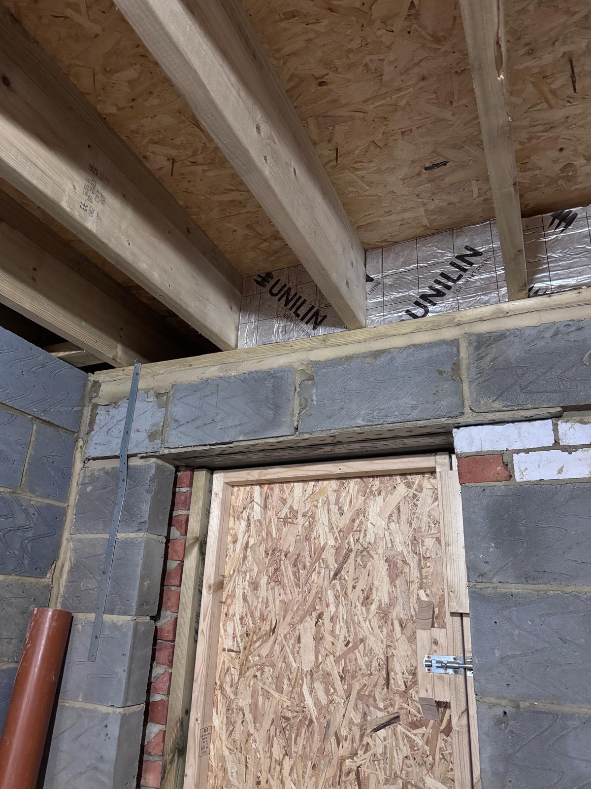

Hi everyone,
I am current insulating the eaves of joists and need to add perimeter noggins. The joists are 8inch/ 200mm (plus furring on top) - do I need to add 8inch/ 200mm here or can it be (for example) a 4inch/ 100m noggins here? My understanding is that it's just for additional support for plasterboards?
FYI - There are 8inch noggin in the centre of joists already and the longest joist length is 4.5m

I always thought noggins were to stop joists twisting as well as keping them apart, so yes I would use te same size as the joists.
The noggins are to stiffen up the floor and stop the joists twisting.
Twisting will start at the ends if they are not restrained. The noggins should be at least 3/4 the joist depth.
Remember to set them in to allow for the thickness of wall plaster, not flush against the wall.
Given there are 8" noggin in the centre of joists, do I still need 3/4 sized at the ends?
As for setting them in, the insulation is flush with the inner block, will be expansion foamed and then noggin set about 1-2" in front. Is that the right way to do it?
Smaller is fine at the perimeter, one for the ceiling below and one to support the floor. 3/4 isn't required and won't work anyway, it needs to be flush top and bottom, for floor and ceiling.
It's a single story extension so when you say "one for the ceiling below and one to support the floor" do you mean like this?

If you do 2x smaller noggins as AFT4B suggests then you are much more easily able to route plumbing between them all.
I have 2x4" already so thinking about using that with a 2" gap from the wall to allow services to go through the roof and behind the perimeter noggin.
