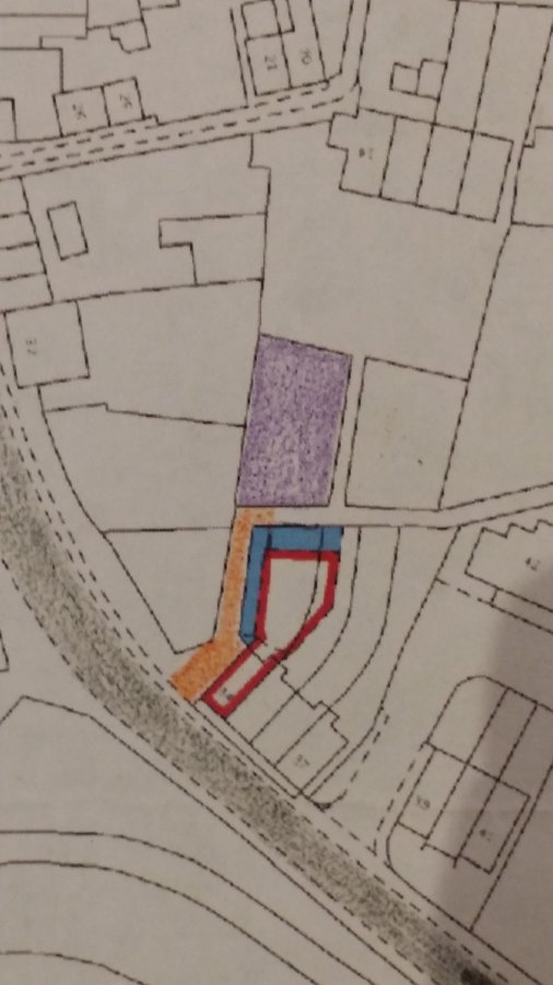

I have attached some images of plan and covenant in title deed.
I own purple. Orange is the footpath I want to drive up. There is a dropped kerb on the road in black.
The wall of 34 to the fence on initial entry is just over 9ft wide. It would mean the car wheels travelling on the path (orange) and fully crossing over it to reach purple.
Have done SIM with land registry and footpath is unregistered but has street lamps so guess Highway depts responsibility possibly.

What's the blue bit?
It seems that the question is about driving up the public footpath? In which case you need to speak with the relevant department at the council that is responsible for it- highways or housing normally.
But that is a long path which might have some safety issues for other users.
The blue bit is not owned by 34 but by the person who owns the plot next to mine so the car would be half on the blu half on the Orange footpath.

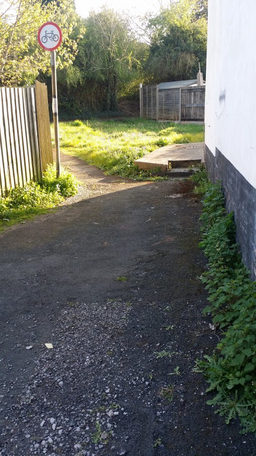

Thought I would put a physical photo up so it is easier to see. The concrete block to he right would need to be removed.
You might look and say no chance or you might think I stand a chance.
Let me know
